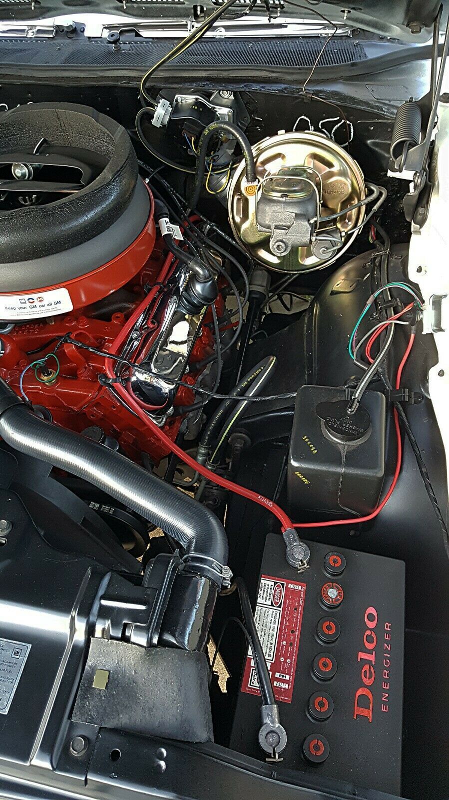

Old Nov 11, 2019 | 11:53 AM
jozw30's Avatar
Joined: Aug 2010
Posts: 697
battery cable again...
Been a while on this thread, but I’m actually doing some work on a real 69 H/O & am replacing the battery cables. I thought the above image showing the cable running on top of the valve cover was a 4 speed thing.
Not sure what AC would have to do with it?
Here’s a picture of what I think it’s supposed to look like? Thought it would just run up on the fender liner.
I don’t have the assembly manual to reference.
Appreciate some feedback.
Thanks!
Joe
Old Nov 11, 2019 | 12:16 PM
Thanks!
Joe
There appears to be a conflict between the CSM and the PIM. The CSM (pg 12-9, Figure 12-10) shows all A-body cars with AT routing the cable on the inner fender as your photo shows. It clearly specifies that only 400 SMT cars route the cable over the valve cover. And yes, A/C and non-A/C with SMT are different because A/C puts the alternator over the top of the driver side valve cover, which forces the cable to be routed over the middle of the valve cover on A/C MT cars.
The PIM shows the routing on the inner fender for 350 only (section 12, page 131) and all 400 motors with the routing over the valve cover (section 12, page 132). I actually think this is a typo, as there are other notes on the illustration on page 132 that imply this is for SMT cars. Neither the PIM nor the CSM address the 455 motor in these routing diagrams as the drawings were made before production of the 1969 H/Os. I assume the 455 was treated the same as the 400 in this respect.

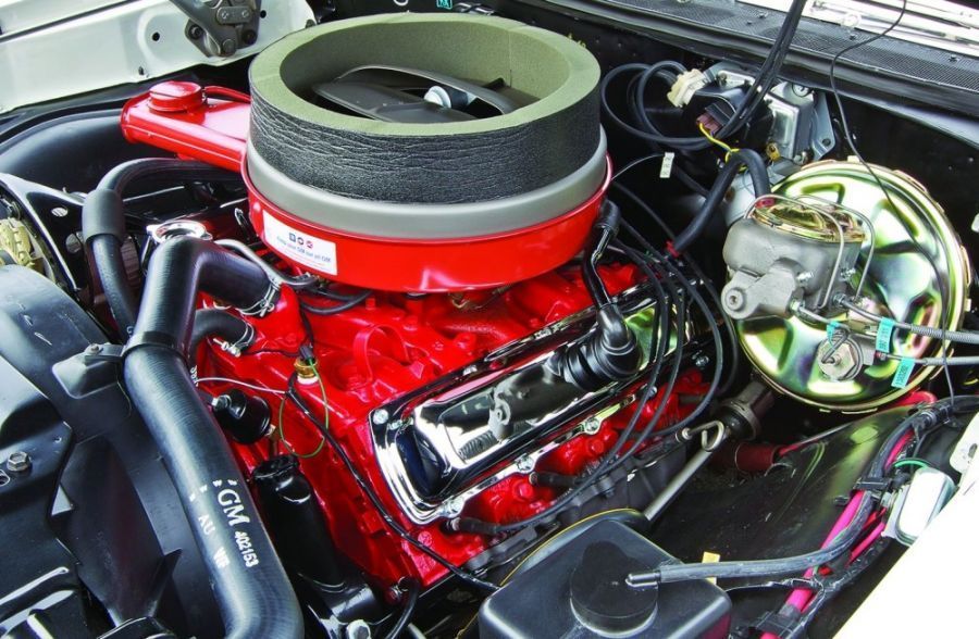

Joe, this is the best evidence I know of besides documentation- real world examples of showroom new cars. Notice the underhood pic- positive cable routes on top of the valve cover. No denying it.
File Type: jpg
File Type: jpg
File Type: jpg
Old Nov 11, 2019 | 12:43 PM
I was hoping someone had a photo like that. Clearly if the cars were delivered that way, they came from the factory that way. Anyone have similar photos of a 1969 442? As I mentioned, the PIM and CSM do not explicitly talk about the 455, only the 400.
Old Nov 11, 2019 | 12:51 PM
69HO43's Avatar
Posts: 2,551
400 cubic inch A/C cars had the positive cable routed over the valve cover too but the cable went behind the alternator before landing on top of the valve cover according to the PIM. Only the 350 V8 autos had the cable run over the fenderwell according to the PIM. I'm guessing the 455 was in a 442 with the H/O, so doing it the way the 400 was done makes sense. I doubt if anyone will nit pick, but if they do, here's the page...

I tend to go with what the "factory" did with the cars, but note here, this I find weird. The pre-production models, at least one of the ones they paraded around all the magazines had the battery cable going over the fenderwell. Even if it was a 442 it should have been routed along the top of the valvecover...hmmm.
As a side note, my car is #43, and has the flat black grille but the grille and headlight bezels were silver. Everyone said that was BS and they never came that way. I got a feeling that some early ones just might. Or if not, the original owner wanted it to look like the magazine car. Who knows? I just noticed the pre-pros had the silver outlines around the grille and headlight bezels. Maybe in the sake of time saving they quit taping off the silver surround? I dunno. GM did some strange crap. Still doing it.
Of course, I digress, but just wanted to show that sometimes your foam seal sticks to the hood and pulls your air cleaner apart. Check out the top picture below. Something went awry. Car thinking it was an S/CRambler.

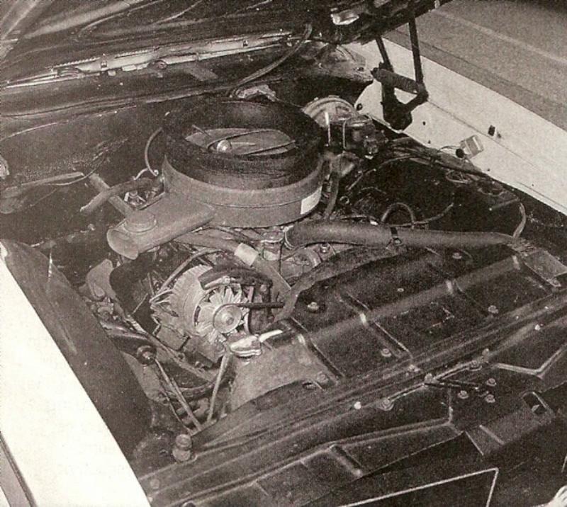

Old Nov 11, 2019 | 01:44 PM
Well, for what it's worth, here's a period road test of a 1968 H/O that clearly does not have the cable on the valve cover. Yeah, flipping the air cleaner lid is kind of stupid...
Old Nov 11, 2019 | 01:49 PM
  #31
And to further confuse things, here's the Car Craft article from 1969. Note the battery cable over the valve cover.

I think in that Car Craft arrival you are seeing the harness for the sending units?
Old Nov 11, 2019 | 05:26 PM
  #36
Yeah, I also considered that. Can't really tell at the resolution of this JPEG. I'll need to go dig out the actual issue.
EDIT: Well, I think you're right, that's the engine harness, not the battery cable. This is apparently the same press car, and these same pictures show up in the Motor Trend and Car Life articles. In the Car Life photos, you can clearly see the cable come off the battery and run to the inner fender.
