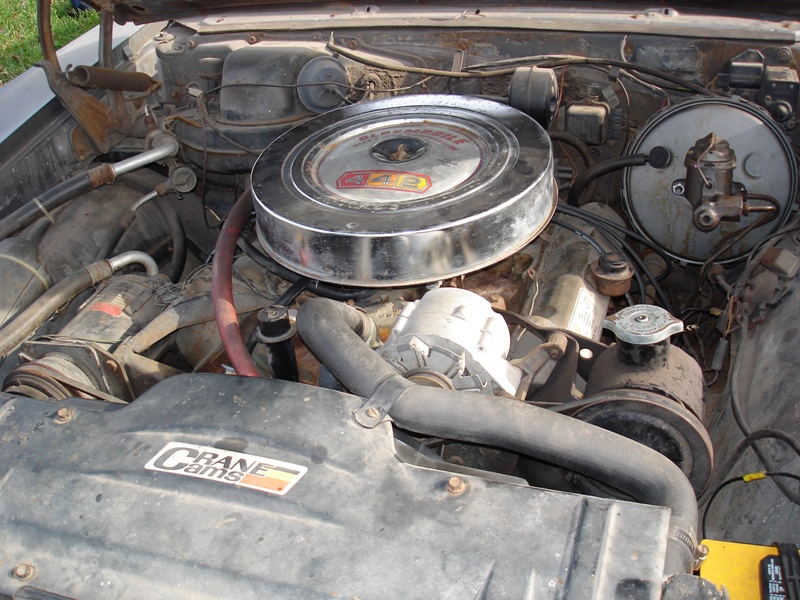

oldsmobility.com is a site I use for much 67 442 info.
Edit: Also, a good way to verify late production automatic 442s in that year is via the Super Gonzo Snorkelless Air Cleaner.
This one's mine, still in project stage.
