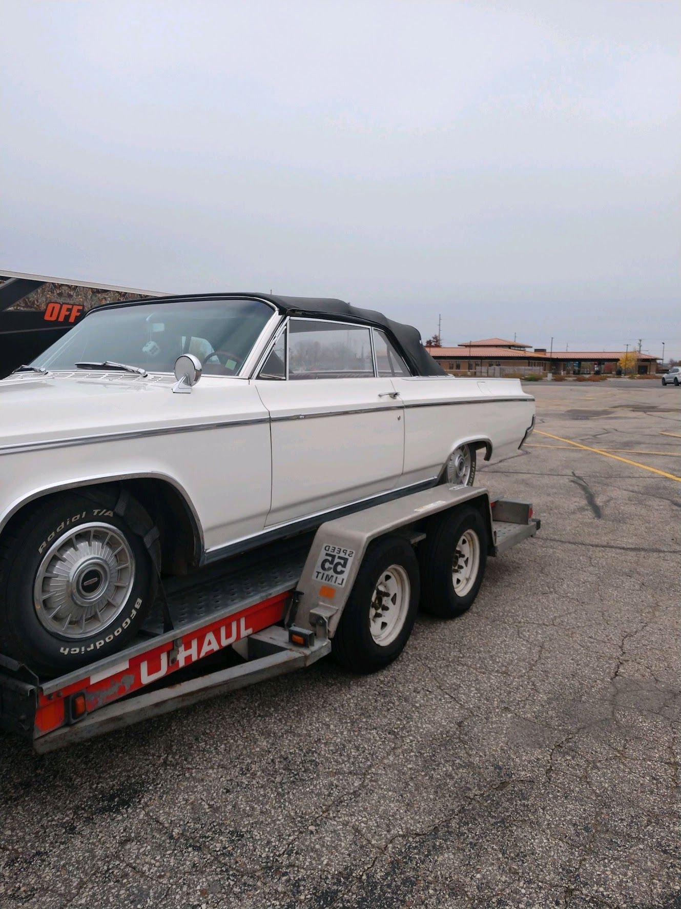

I dragged a '64 Dynamic 88 home from Wisconsin on a rented U-Haul trailer. It was 78" between the fenders- the trailer, I mean. The car hung out the back a scary bit, and when I hit road construction through Chicago and the lanes got narrow- well, it led to some tense moments. But it worked. I guess that's the point...
This is pretty close to the same length as yours... I guess it's almost 18 feet
