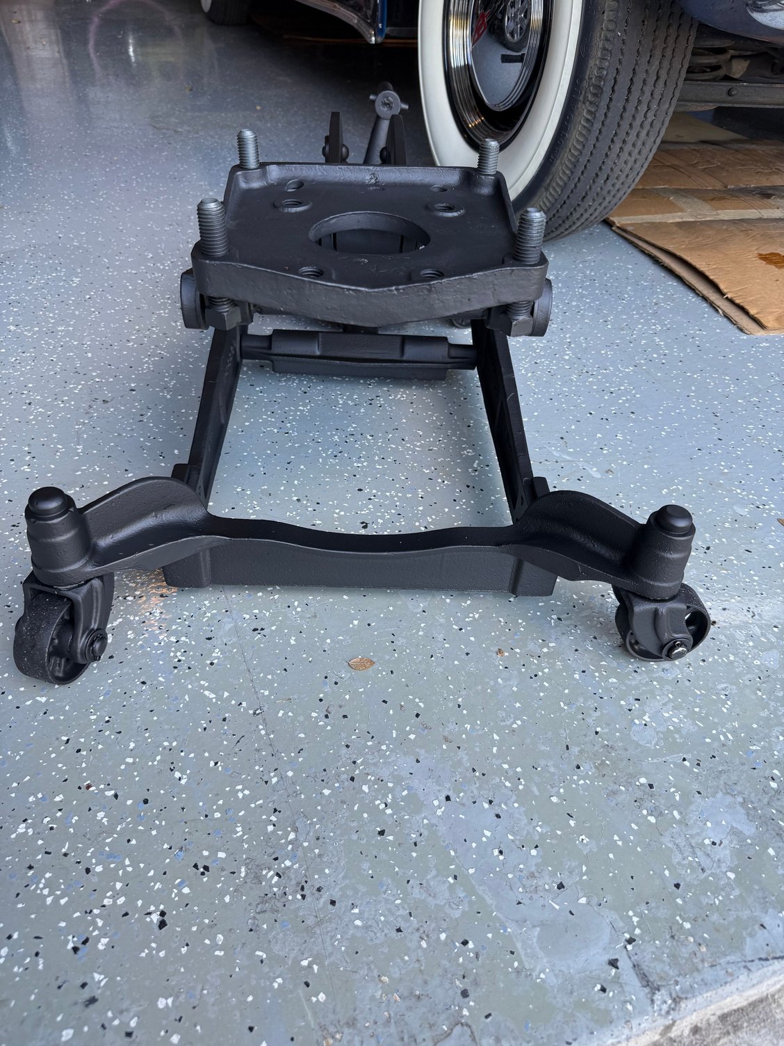

Here are some photos of the finished product. It functions perfectly. An additional $50 in paint and an $11 3/4 square impact socket from Amazon to break the leveling studs loose. I cut down grade eight bolts into axle pins with cotter pin retainers. Shimmed the casters with stainless washers. 1000 lb capacity. I’ve considered building a layered gear round top to use it as a poolside beverage table when not in functional use….

Nice job Heath!
