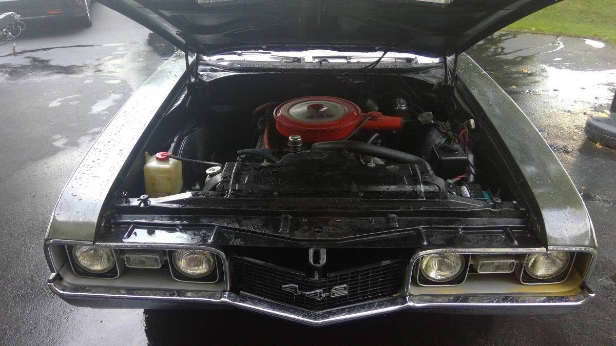

Here's the "Hurst Olds" I just looked at
https://newlondon.craigslist.org/cto...457399358.html
Price was firm, Might be worth 25K to someone, Canada car.
Rust not terrible hood needed adjust or had bent hinges.
Exhaust leak.
Good vinyl top replaced approx 15 years.

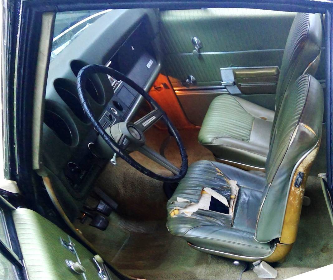

Here are a few pics I took while there

In it's present condition I might go $12.5, no more. It is a rust bucket, through and through. But I like the color - same as the original on my first Cutlass S. I paid $14.5 for my current '68 4-speed 4-4-2 in much better shape with AC, power windows, console. Admittedly that $14.5 was 12 years ago, but still.. in today's market I think mine would be worth about $25- to maybe $30 on the top end to the "right buyer." And it's been refreshed mechanically and aesthetically, with very little rust.
Just my $.02. YMMV

That things looks solid and original. Says original numbers matching block.
why is anyone guessing if it’s a Canadian car. It’s right there in the pics. So it should have the 12 bolt chev if its original rear.

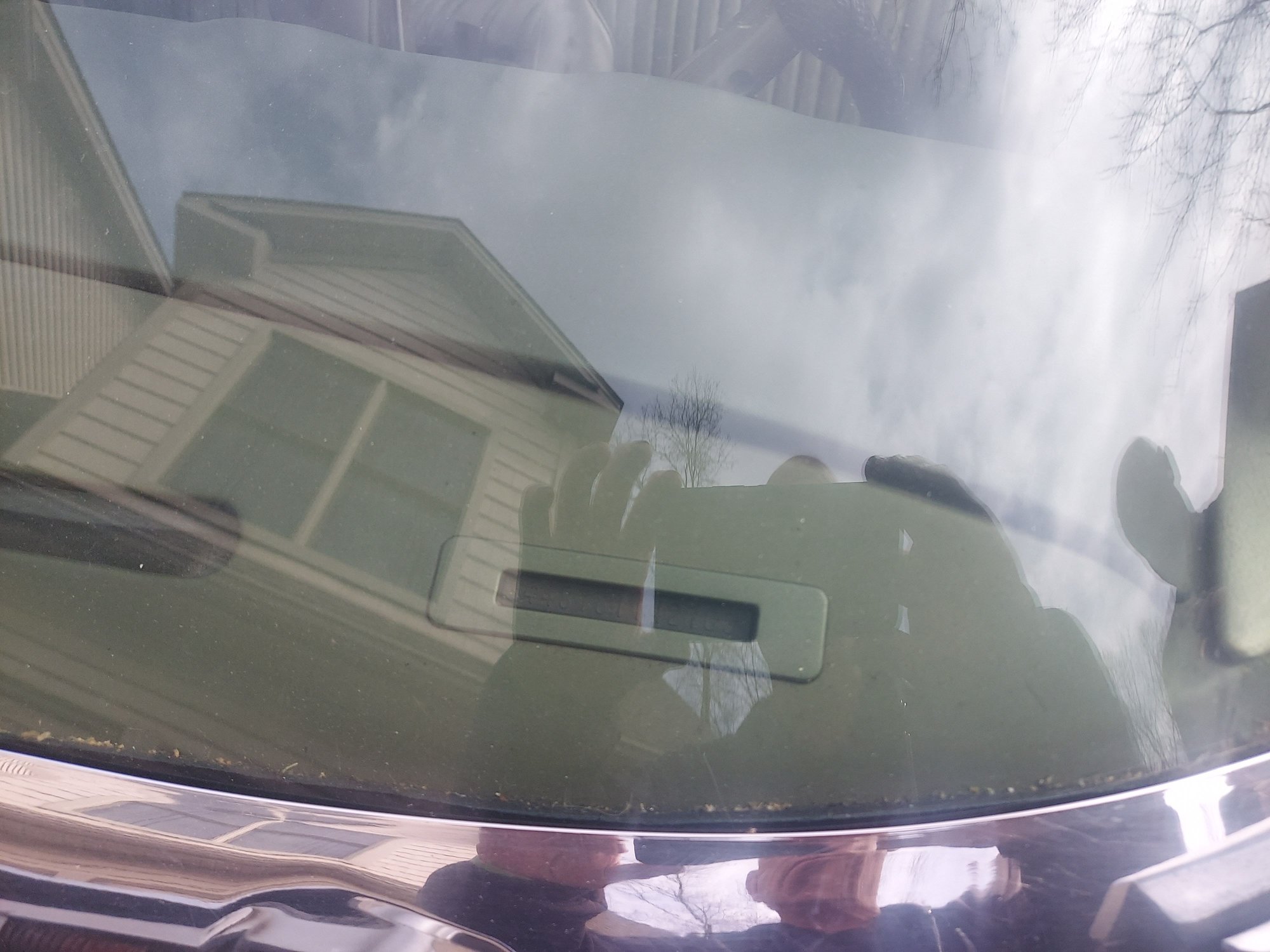

Speaking of hidden rust. This picture scares me ..
Moisture along the windshield channel from the inside is never a good sign.

you scare easily

To be honest from the photo I can't tell if that's rust, moisture, or just delamination in the glass.

I actually thought it was bugs and dust that had gathered in that area over the past 50 plus years. It is a pretty hard area to clean without an air compressor and a blow gun.

Blown up veiw, pretty sure it is just dust, and debris.
