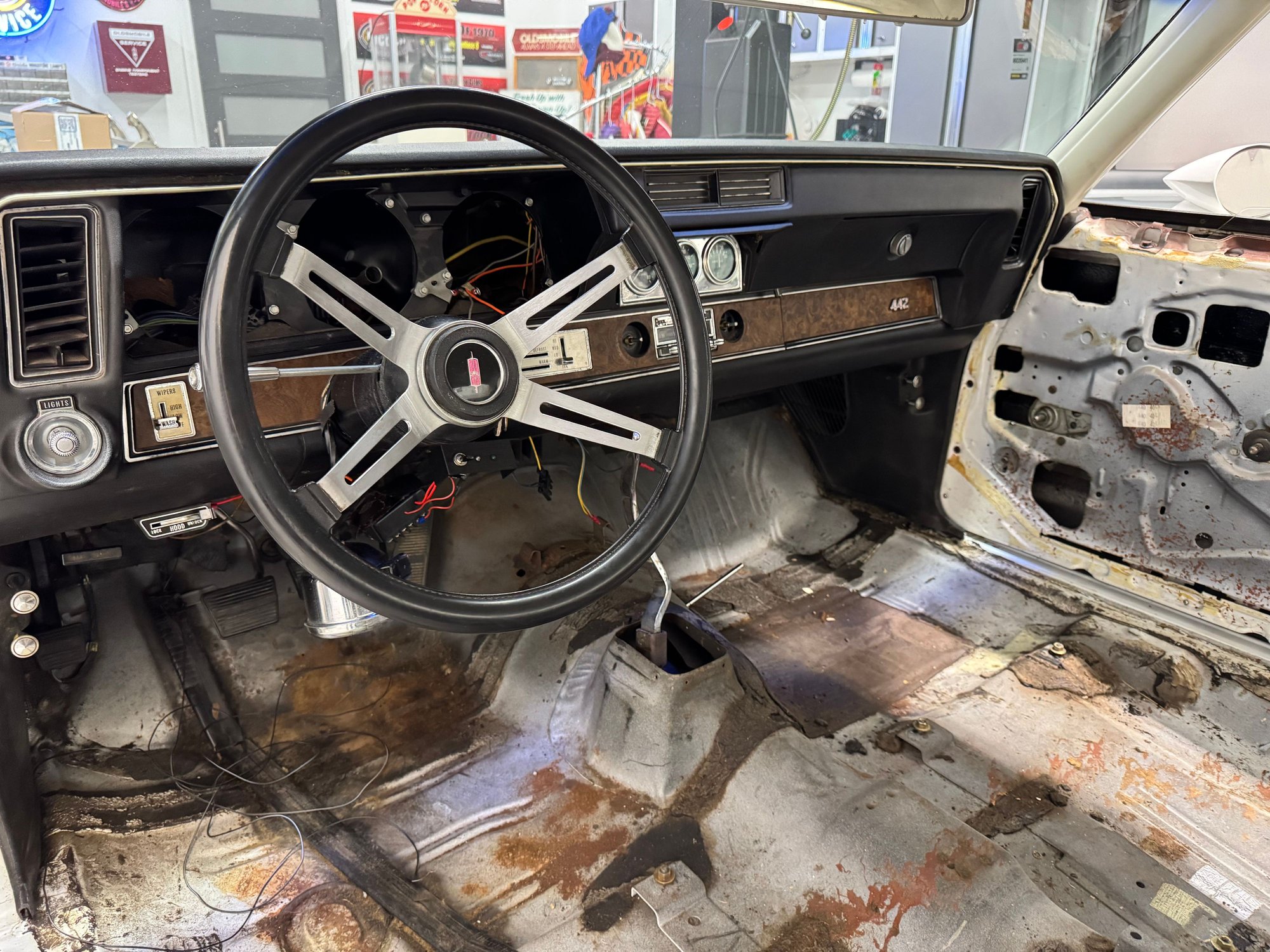

Going to tackle the dash removal next week. When I removed the dash in my W-31, I took every little component out on its own, and I think that probably wasn’t the best way. What are the pro tips for pulling the entire dash out with most everything attached? Radio is out, front speaker is out, gauges are out.

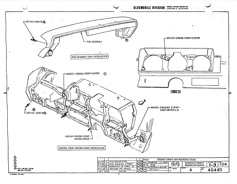

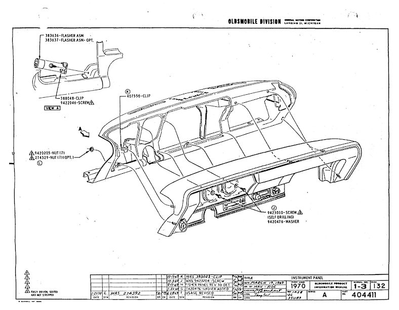

Getting the dash out isn't all that bad, but the metal frame can be sharp and will cut your hand & fingers. Also, the main electrical harness to the fuse panel is attached to the back side of the dash and was installed as a unit: fuse block, harness & dash. Most attaching points are 8-32 castle-nuts along the top & bottom, but there is one point that uses a special "press-on" clip which will require a bit of brute force to release it. Don't lose this clip as they are not reproduced in the aftermarket. Here's a pic from the assemble manual which should be helpful.
