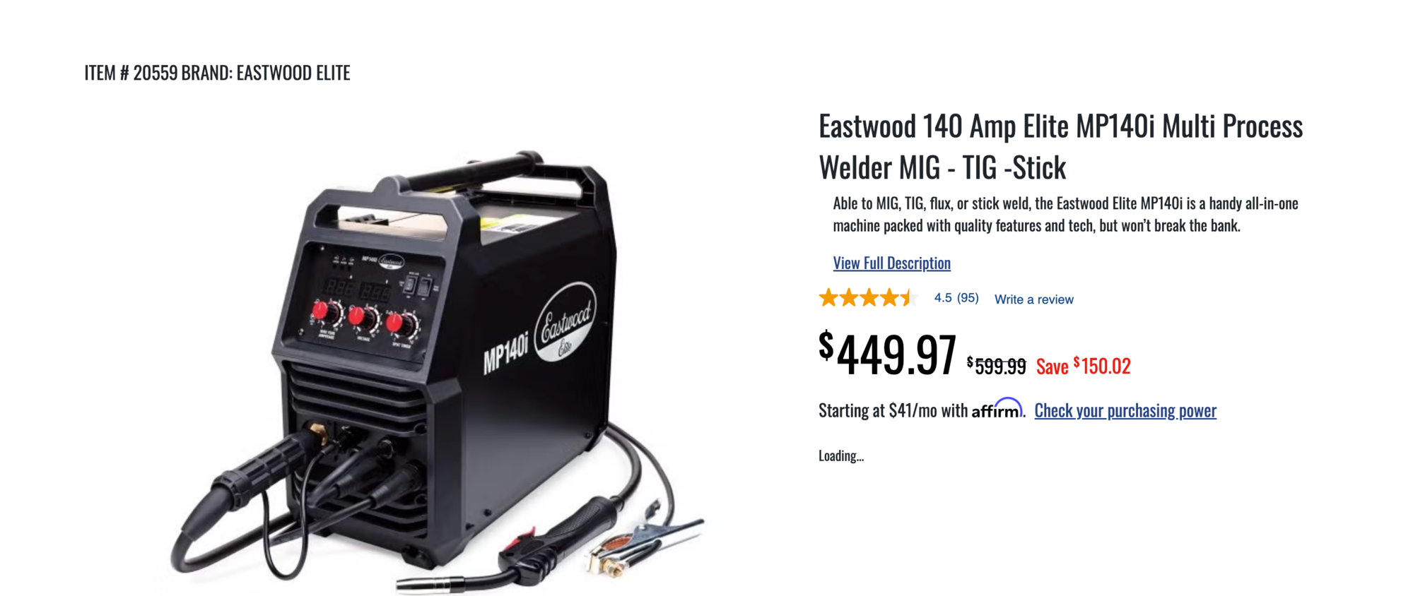

I am considering adding a Tig welder.
I have a hobart 200 mig .
But would like to try my hand at TIG.
Is this any good https://www.eastwood.com/eastwood-el...tig-stick.html
Or am I better off getting a dedicated TIG?
Thoughts?

I have one, but never even tried to TIG with it. First, it's scratch start. Second, it has no remote controls, and no way to add any. I ended up buying a used 200a dedicated TIG rig with a foot pedal and thumb button.
The MPi does MIG very nicely, and has a spot weld timer built in. There's a saying that goes something like something that does everything cannot do it all well, or something like that.

Get a real TIG. Foot control, AC/DC, so you can weld aluminum, High Frequency start. Your weld quality will increase tremendously, with a bunch of practice!
