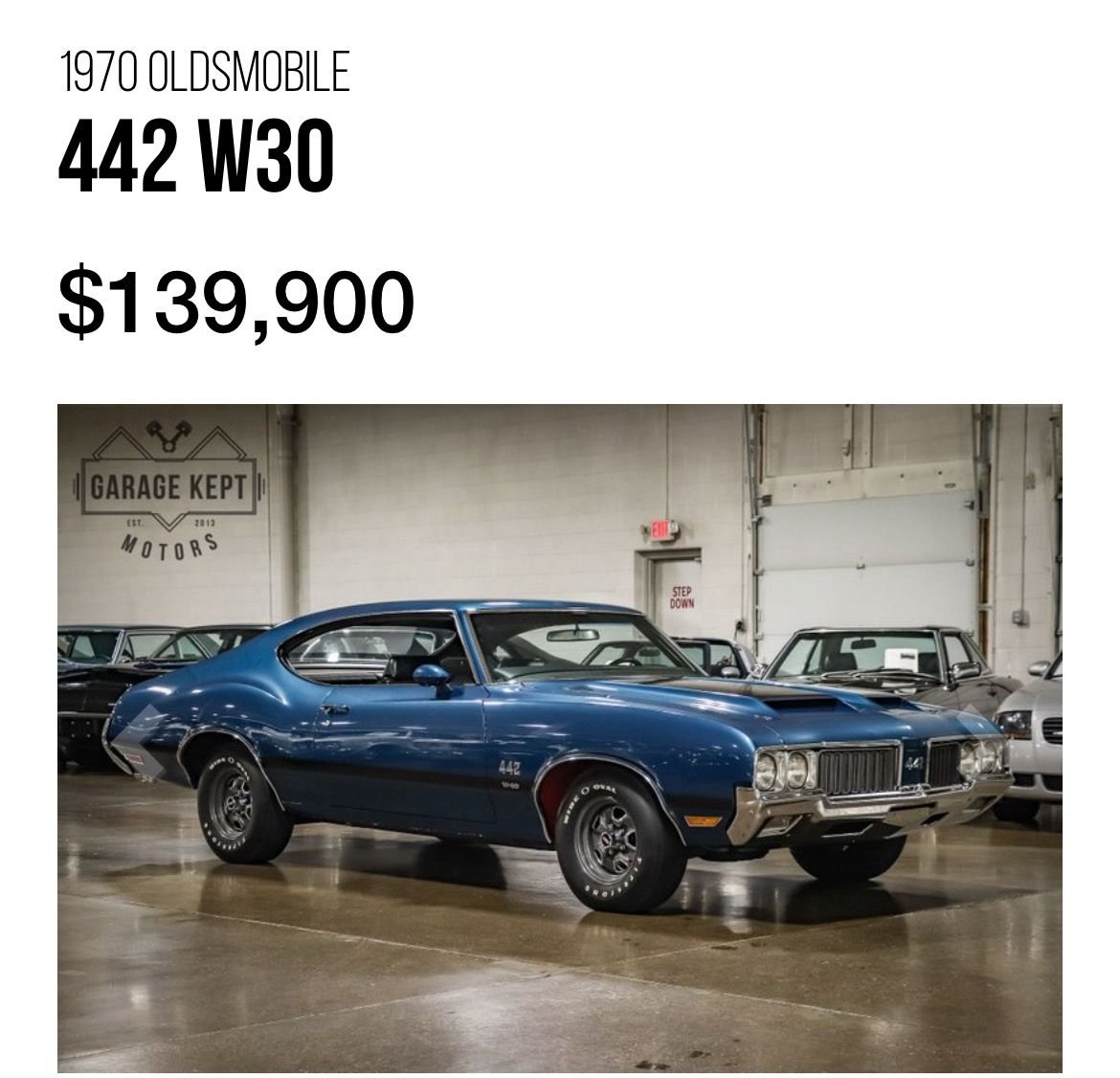

Thoughts?
Old Oct 28, 2021 | 10:29 AM
ericisback's Avatar
Joined: Nov 2018
Posts: 104
Thoughts?
Automatic
https://www.garagekeptmotors.com/veh...mobile-442-w30

Looks to have docs. I am just blown away what people get out of an Oldsmobile these days. Everyone is jumping on the band wagon too. Blows me away. New Vette or ...

Beautiful car
But why take all those pictures and not include pictures of the "OW" transmission tag, the VIN derivatives on the trans and engine block. Pictures of the F heads, the aluminum Oldsmobile 455 intake, the 7040258 carb stamping, and the distributor number.
At least it has the open face alternator.
Not sure, but is the OAI hood supposed to be white on the underside. Ive only seen black on the underside, unless it was an aftermarket hood.
AND, who drove the car thru a puddle and didnt wipe the under side off when detailing the car?

I think it's an aftermarket hood.
The front bumper is tweaked, the trim rings on the wheels are awol, the exhaust is put together with sheet metal screws, the underside is the wrong color. Red fenders look repro, everything is too glossy. A lot of chassis stuff is the wrong color.
All of the above notes on underhood numbers.
Here's the big one for me. That sticker does not match the accessories. That sticker calls for a hood lock, 8 track, safety sentinel, deluxe belts, deluxe steering wheel. All those are gone, and a sport wheel and a 33k mile non original speedo is there instead. To me, this thing is a high mileage, restored 442 with a replacement interior or parts of it. It's an automatic. Assuming that all the powertrain codes are legit, if it were top, top notch, I would say it could get 100, maybe 110. It's not top notch. I think that's a 70k car at most.

Oh yea, the front seat covers are wrong, they should look the the top of the backseat, with the individual padded rows. Not flat. Its a cheap set of reproduction vinyl covers.
Couldn't agree more. Hood does look aftermarket. No screen for one.
What is up with the red underbody? Same for the gold rear end chassis parts etc. Oh but all original numbers matching authentic car...🤔
Hell it's only 140 thousand. That gives you plenty of room to fix what needs to be fixed...🤣😂🤣

Wrong stance in rear. Cutlass springs not 442.

What is up with the red underbody? 😂🤣
Someone was trying to duplicate the red primer overspray that is found on some original cars. Obviously didnt understand the meaning of overspray

The body number on the cowl tag coincides with the build sheet so its definitely a W30 car..as for the other things pointed out, cannot say with any degree of certainty. Underside hood white ring is odd, didn’t see a clear pic of it tho.

Bet the restorer who did it had plenty of experience ... on Mustangs. The red oxide floorpan is a Ford thing, innit?
My arlington built 72 supreme has a red oxide floor

Seats look funky

That car has extreme documentation, but some of it doesn't line up and there is odd stuff going on. If all the stampings (not seen) matched the docs, then that is a W-30 powertrain. Careful examination of the cowl tag and vin rivets would show if it were the original body or a rebody. The interesting thing is that it's not the original speedometer, and that's what they're basing the miles off of. I bet, if one were to question the salesman, they would play dumb and just say they were selling it and know nothing more.

It might vary with assembly plants, but most floors I've seen were some variation on Chassis Black, maybe with body color overspray around the edges on the bottom (exterior), and red oxide on the interior side.
Some years ago, just for S & G I got a reproduction dealer sticker for my '69 4-4-2. It looks pretty convincing -- with a little effort to "antique" it, I'm sure it could be made to look really authentic. I listed all the equipment that my car was originally ordered with (per the GM Historical Services paperwork), but the vendor would have put anything on it that I wanted.
I guess I'm just saying that the info on the sticker is no indication of anything.

Their close up shots of the interior did not do them any favors. If that is a restored interior, I don't want to see an unrestored one. That dash and console look terrible. $140,000? not even close. But, as was stated earlier, some people and their money. I may be an oddball, but I still don't see the point of a W-30 with power brakes and A/C. My two cents.
