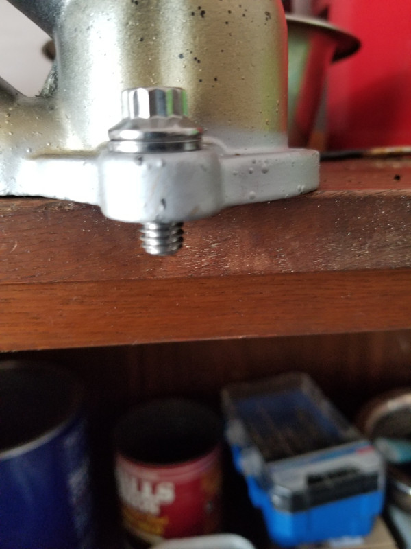

Those ARP bolts are bad@$$. Make sure you show us an after pic.

Make sure you have enough length into manifold as to not pull threads out.Those bolts look short.
Your sir are correct, so I guess I will have to get longer bolts or studs.
