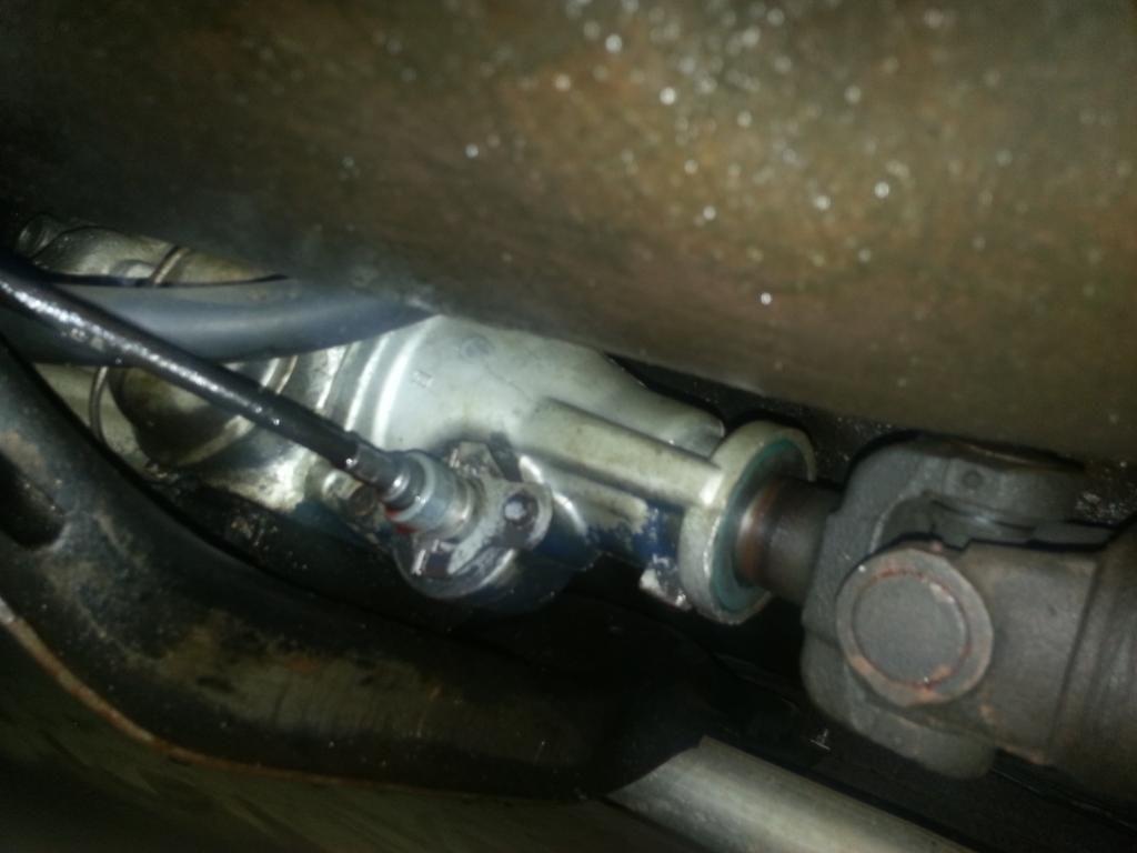

Well, if you need to do freeway driving and are concerned something will break even "worst", then disconnect the speedo cable at the transmission. It's a simple task to unscrew the lock collar and remove the cable end from the trans speedo housing.
https://classicoldsmobile.com/forums...r-housing.html
Cool...thank you!
