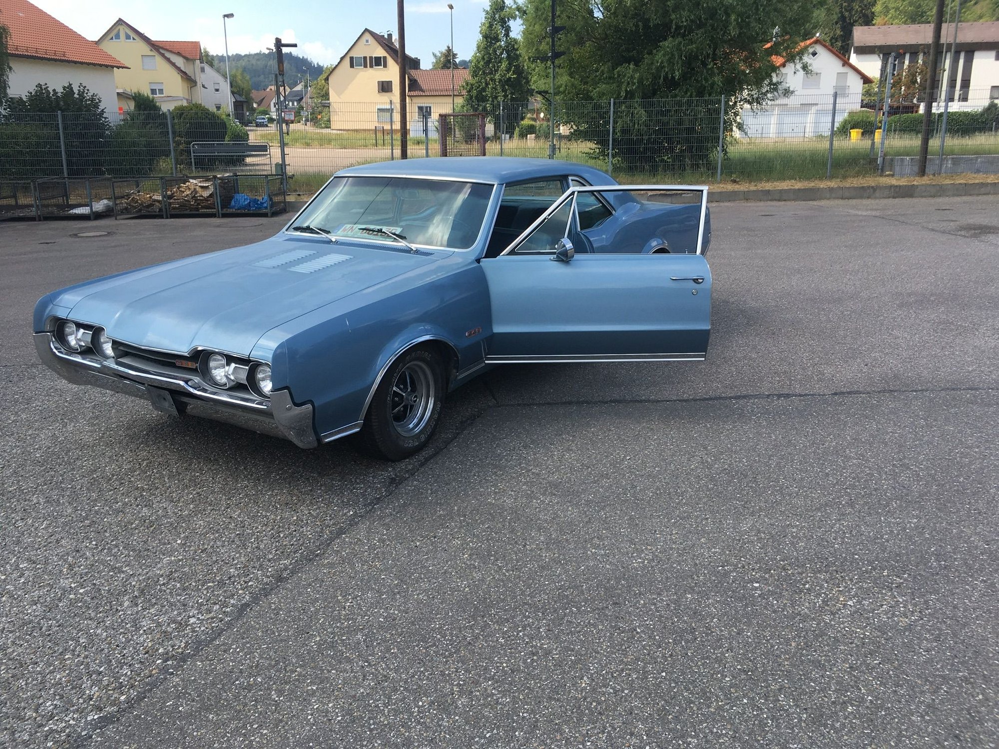

Hi 👋 I’m new here!
I hope my following question is not too trivial:
Short Info: 1966/67 CS 442 400cui -3gear automatic - 120.000 miles - Edelbrock Carb, new headgasket - good compression.
My first American V8! A Dream Come true! But new territory for me:
I‘ve been driving for three hours on the interstate today. It felt like the car was most comfortable at around 55-60mph at ~1.500rpm(if the gauge is right)
My Question is: what maximum speeds or rpm would you guys recommend for this kind of engine (age/ mileage). I don’t want to compete on the left lane, but I’m wondering if I should really rev it up from time to time(of course when engine warm etc) for the engines sake(the official max speed for the car is said to be ~125mph) or if I should just leave it and never go over 80mph?
Thanks a lot !
Moe

Recognizing your license plate you seem to be in Germany.
