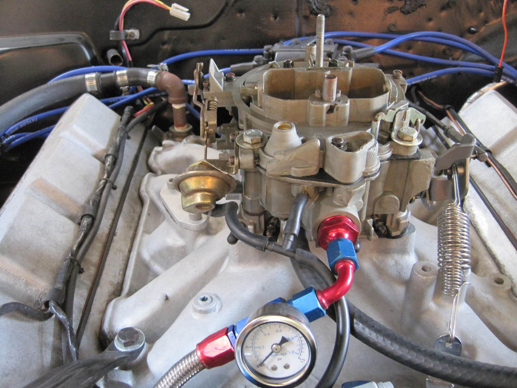

Here's my rare piece of Olds history. Trying my best to get the 455 in this thing by new years...But, you know how that goes..

Before spending $$$ on EFI, you might investigate a good Q-jet. @rickw30 has two nice 800 CFM cores for sale, your choice for $100.

So you have FiTech EFI on a SBO engine in your Omega now?

Hey, as far as throttle body EFI on Olds engines--I've done installs with Fitech and Holley Sniper. Fitech was nice with support for PWM fuel pump, but a little more finicky with getting the inital timing set (once you are there--it's all good). Holley Sniper was a breeze to set up, but didn't support PWM. New sniper 2 is out, haven't had experience with one yet but I've heard good things.
I'm currently running the Sniper Quadrajet on my G-block 400, and it performs nicely.
For either, I highly recommend upgrading to a CS130 alternator if you haven't already, install the MSD 8830 across the battery, and use MSD Superconductor plug wires. RFI will drive you nuts, and taking this advice might save you from stroking out.

As for my alternator im already running a Tuff Stuff 7127k

I went to sniper, best money I have spent. It starts hot ​​​​🔥 or cold 🥶. Idle is bang on all the time, smoooooooth. Good mileage to boot.

I honestly havent put many miles on mine since swapping. But ive had ZERO issues and its truly turn key.
