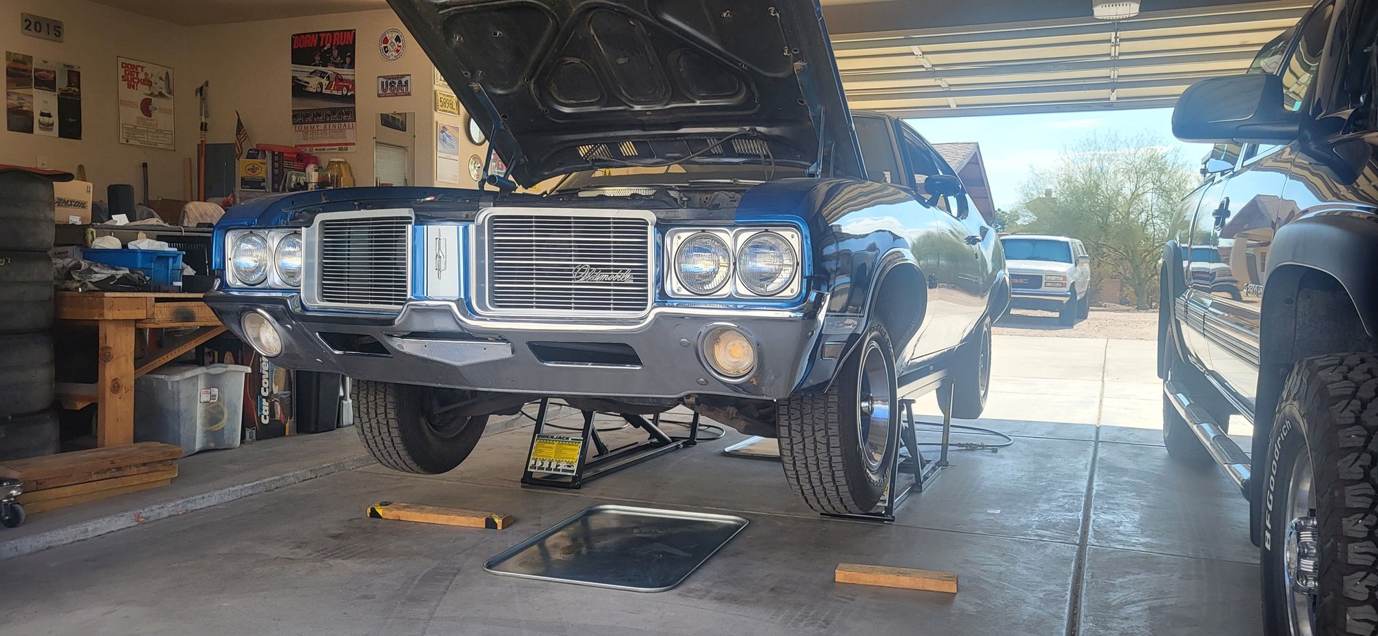

Had the Olds up on the QJ the other day and noticed my shocks are still the Sears units my Dad installed back in 1978. Car does roll quite a bit during aggressive corner hanging so it's time for a few upgrades. I'm not going to be Autocrossing or Roadracing but I'd like it to be a bit more predictable during therapy drives. Keep in mind I'm on BFG 215/70/14s so I can only expect so much. Thinking about KYB Gas-a-Just shocks as an affordable option. Anybody use these and are they of good quality?

Az, How do you like that lift you have there? I was wondering if those were heavy enuff for our Cutlasses, Your pic says so... About shocks- I was always taught that if car doesn't continue bouncing after a good 2 or 3 bounce on bumper or they aren't leaking they are OK..?? I replaced mine way back in middle 90's with generic Monroes- been fine since, but I have wondered if a "high performance" shock would be a improvement? I do know adding a factory sway bar to my Cutlass 'vert made a big improvement.....
The Quickjack works GREAT! I've got the discontinued 5000 SLX which I purchased originally for my C5 Z06 and my 5th Gen Camaros. I added the extensions and they give the lift a bit more versatility. The newer 5000 TL model would probably work perfect for the full frame A-bodies.

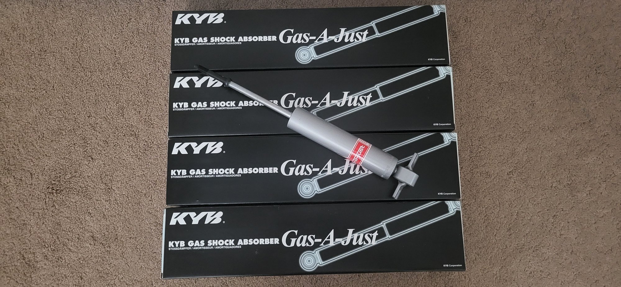

KYBs arrived today. Had a $20 "Summit Bucks" credit so the total price came in under $200. Plenty of good options out there but these should suffice for my driving style.
