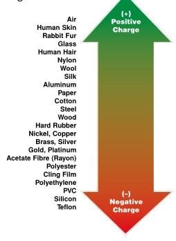

Yes. Plastics are non-conductive - they will not conduct (transport/transfer) electrons, they are insulators. However, there is often significant electrostatic charge on the surface of plastics (some plastics far more than others). Plastic surfaces can store significant amounts of electrostatic charge. Basically two forms of static charge - volumetric & surface charge. The greater majority is surface charge - electrons will congregate on the surface of plastics & can buildup significant electrostatic (negative) charges. Plastics have a very low capacitance but a very high voltage associated w/ electrostatic charge (the opposite of metals).
The sole reason for suggesting the grounding of the plastic is to dissipate the buildup of electrostatic surface charge & not to conduct an electric current. For the same reason you place a portable plastic gasoline tank on the ground instead of back of your pickup truck - static electricity will jump to ground. I can't say if my suggestion will eliminate your issue - but it sounds like you're a large mass & have it figured out. Good luck.
Example of how much surface electrostatic charge exists on certain objects (Triboelectric Charges) - PVC and all plastics have high surface negative electrostatic charges.
