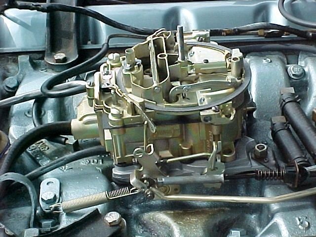

The difference is even greater on the early Qjets. The assembly line carbs for 66-67 used a round tag with the carb number that was pressed into a recess on the driver's side of the carb. The service replacements for these carbs don't have the recess or tag and have the number stamped on the side like the 68-up Qjets.
Here's an original 1966 Oldsmobile Qjet. Note the round tag with the carb number.
Here's a service replacement for the for the 1966 Toro. Note the carb number stamped on the side of the carb and no circular recess.
Excellent example Joe. I have thought about that particular carburetor example quite a bit and I find it interesting how they dealt with the fuel inlet valve issue on those serv replacement carbs but didn't change anything with the secondary damper. They first appeared on the scene in 1971, so you'd think they would just be updated to the more functional design.
I've seen the inside of that service replacement and the fuel bowl is different. They didn't just block off the old fuel inlet passage, like you would do if you were eliminating the valve, it's not even there! Totally redesigned. Seems strange that they left the secondary alone in it's original 1966' form.
