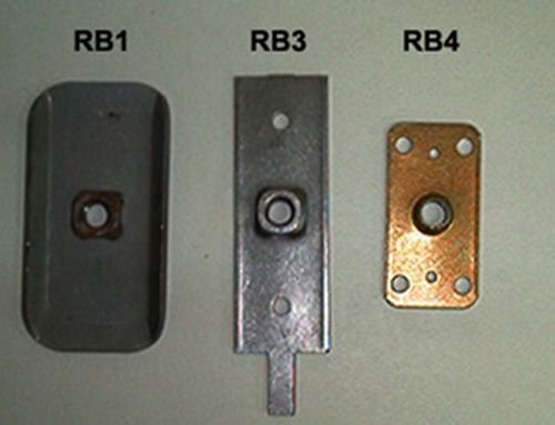

As noted, there are a lot of vendors selling DOT-approved aftermarket seat belts. The body mounting is what matters. The factory used attach points that passed through reinforcements in the floor pan - the thin floor pan sheet metal is NOT sufficiently strong by itself. Typically the mounting points for the front belts pass through the floor pan crossmembers, which provide sufficient reinforcement. The back seat belts will usually need to be mounted in an unreinforced part of the floor pan under the back seat. You can buy aftermarket reinforcement plates with radiused edges for these locations.
