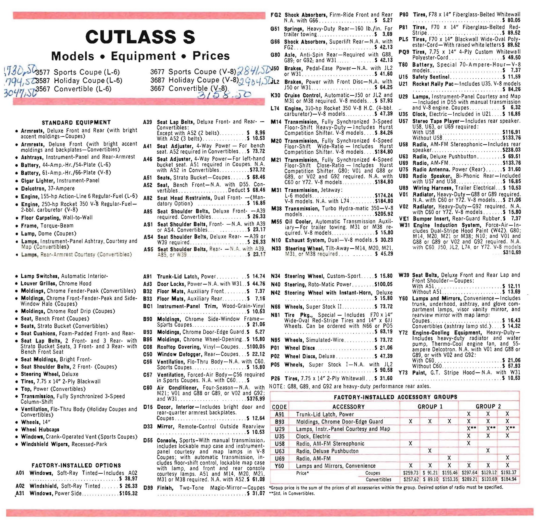

Shoulder belts on the outboard front seat locations were federally required starting with the 1968 model year. Your 1969 car left the factory with shoulder belts. Rear seat shoulder belts were an available option. The hard points are already located in the body structure. If you are asking about retractable three point belts, that is not what was used in 1969. From the 1969 owner's manual:

Ah, sorry, I missed that. Thew were optional and are shown in the Fisher Body Manual. Available under RPO A85 and AS1, depending on standard or deluxe. The convertible front shoulder belts anchor to the brackets that mount the top mechnaism.
