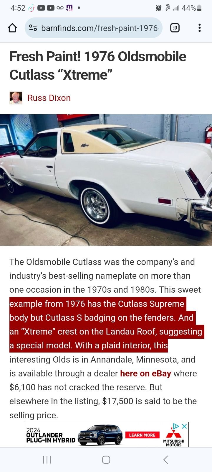

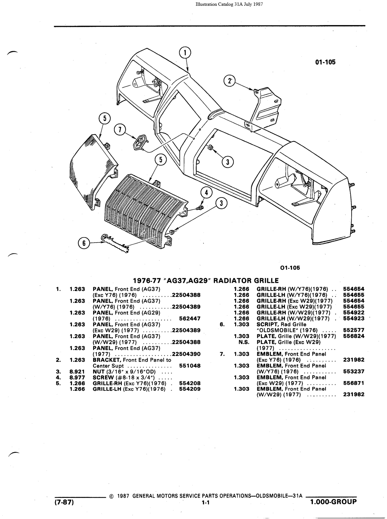

Automakers do not randomly make "running changes" without a paper trail, despite what sellers of one-of-none cars try to claim. Having said that, here's the paper trail. It wasn't a "running change", it's part of the Y76 regional special package. Note in the parts book that the 1976 Y76 cars do not get the sloped nose of other AG37 cars. Header panel 22504389 is the "squared off" header used on the Supremes.

Originally Posted by javon7065
Plus I find it hard to believe the two different vehicles from completely different former owners would have changed the emblems.
Please read red highlighted area.
Dealership hodgepodge.
