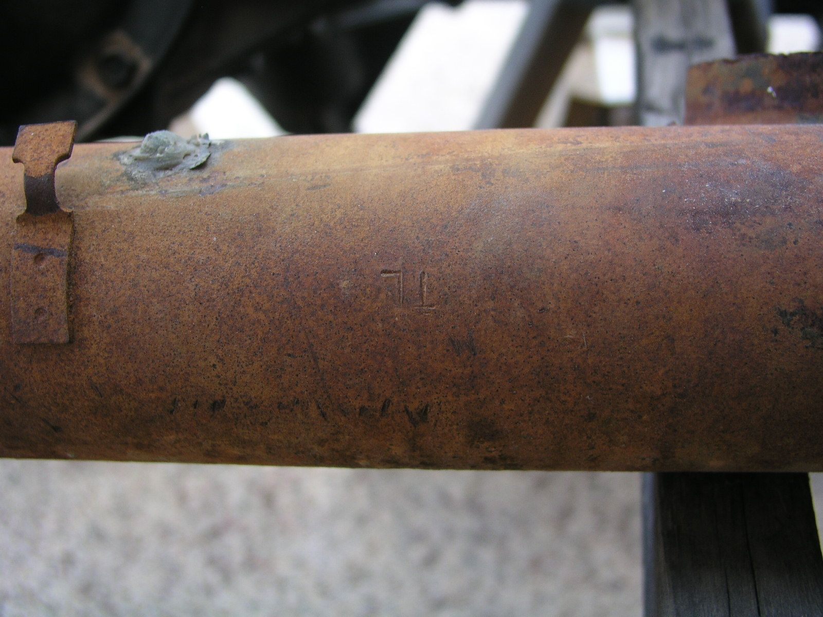

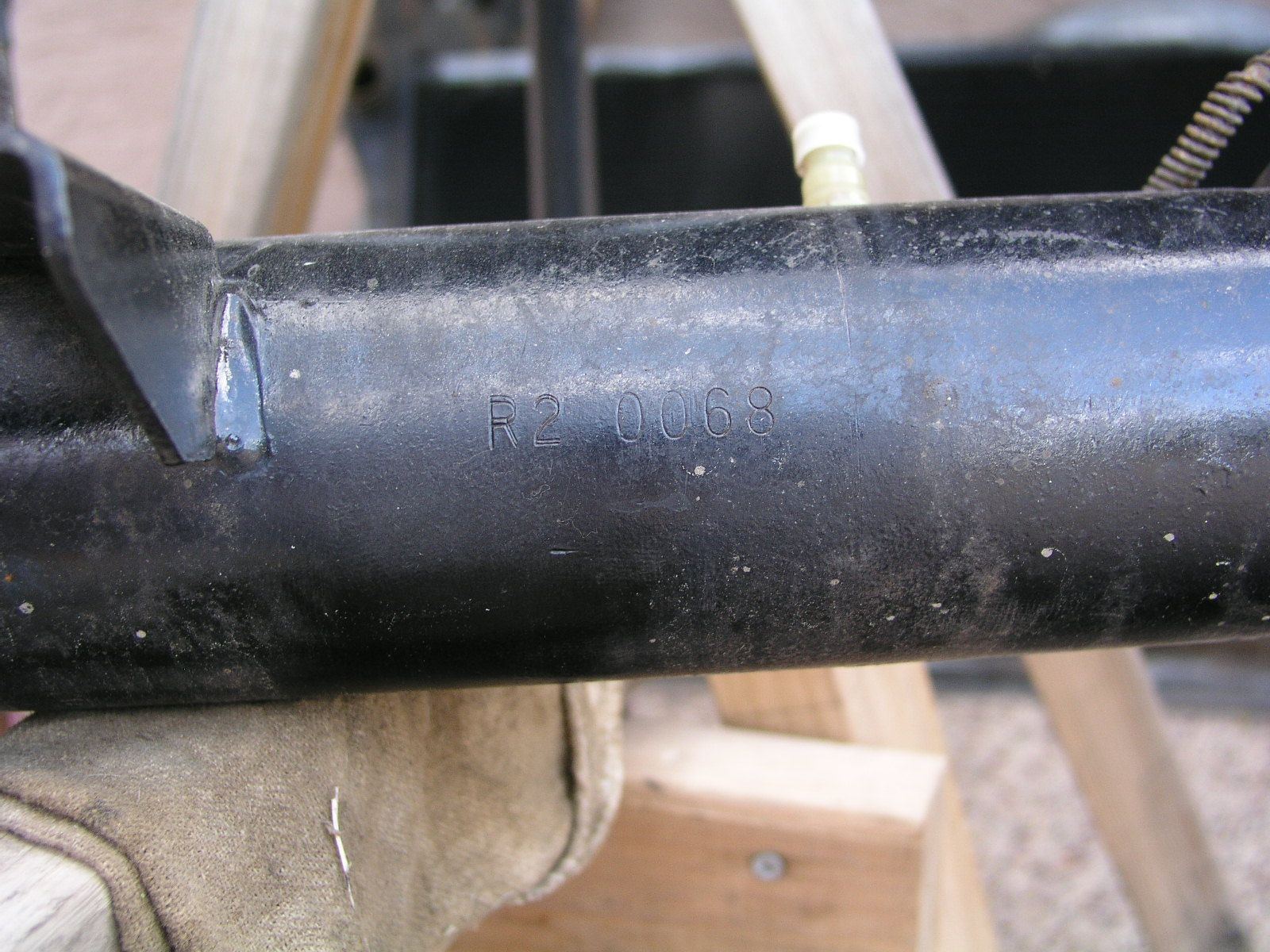

Below are pictures of the O-Type rears in my inventory showing the code on the passengers side axle tube.
1968 "TL" code (3.42:1 ratio, open carrier, HD 31 spline axle shafts)
1970 "R2" code (2.56:1 ratio, open carrier)

Sorry, you said you were looking for the stamping for an O-Type rear. Your 1972 car would have a corporate 8.5" 10 bolt rear, not an O-Type as those were last used in 1970.
If you have a Chevy 12 bolt, that is a very strong and desirable rearend. Unless you were wanting to restore everything to show quality original, I see no reason to change it for a different rear. Having said that, assuming you could locate a correctly date coded 3.73 TO code rear, you would be able to sell the Chevy 12 bolt for a decent amount of money, likely enough to cover the cost of the TO code 10 bolt.
The corporate 8.5" 10 bolt code is in the same location but is different as it incorporates the GM division and the date along with the gear ratio designation.
This is the axle stamp on the 1971 8.5" corporate rearend from my convertible. The info I was able to get says:
R2 = 2.56:1 gear ratio, open carrier
0 = Year (?) still not 100% on that
068 = Julian date (68th day of the year)
Kenneth, the first "O" is actually an O and in between N and P, signifying Oldsmobile production. The fact it looks like a zero is likely just laziness on a factory working stamping the axle.
Old Aug 24, 2020 | 02:47 PM
  #32
Posts: 15,409
That is what I originally typed, but then I got to second guessing myself since the two characters looked like zeros. It is an Oldsmobile produced rearend as it has a block "O" on the forward facing areas where the axle tubes attach.
N
I am so glad those are stamped what appears to be upside down. For the life of me I couldn’t find my code 6S in the CSM, then I realized it was actually S9 (3.42:1 anti-spin), 🤣
