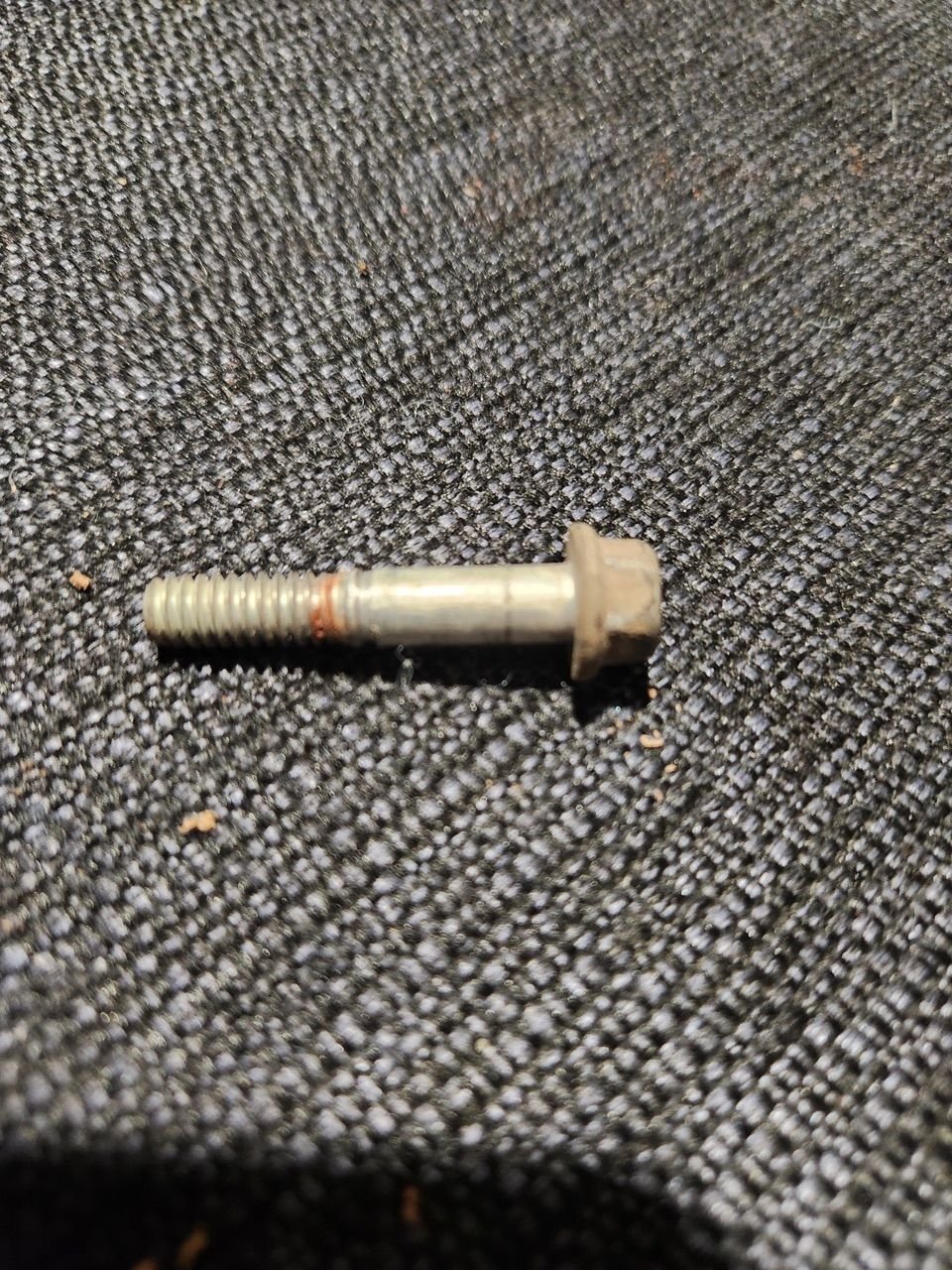

Thank you for replying, unfortunately I was not the one who took the bolt out, as I had a friend over working on the brake master right above it. I have a picture of what I think it looks like, but I am not quite sure. I was hoping somebody would know what it looked like.
Attached below is the picture of the bolt that I think it could be

A quick look, I could not find an extra, here is the one from my 70 for ref though.
3/8 head, 1/4 bolt, thread section length from tip to head 1.41”, overal length 1.65”
I hope this helps

The trick with that connector fastener is the length of the unthreaded portion (to preclude crushing the plastic connector) and the small head (to fit the socket down into the hole in the connector). Most hardware store fasteners will have a longer threaded portion (typically about 1" long).

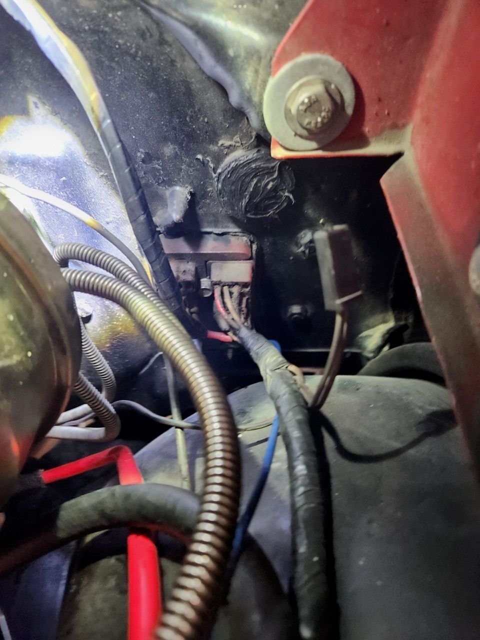

Hello everyone, thank you for your replies sorry for not being mor communicative. What seems to be the problem on mine is that at one point in time before I owned it, somebody stripped out the plastic that the bolt screws into. While it is temporary, I have remedied this by taking the fuse box off, and sticking a bolt through the stripped plastic, putting the connector on and snugging them together with a nut. Here is where i am wondering, should I be worried about the metal bolt head causing a short in the fuse block? I have made sure that it is not touching anything and that it has room. should i switch from metal bolt to nylon?
