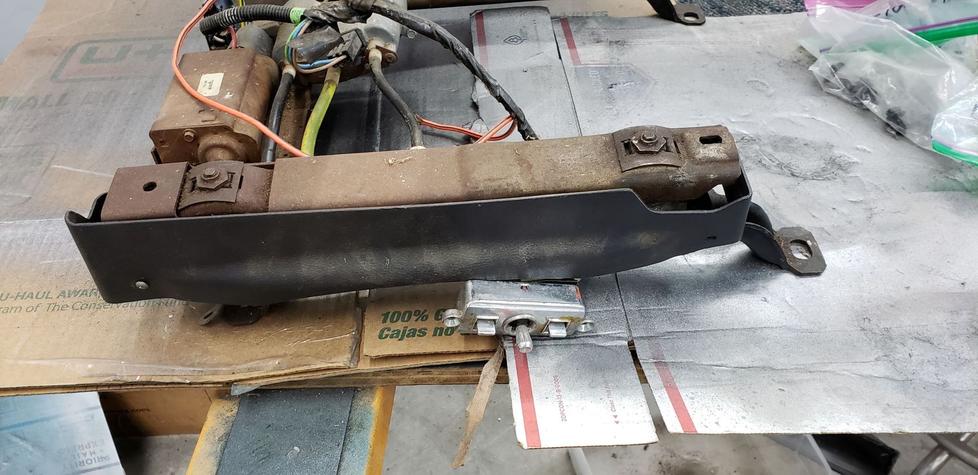

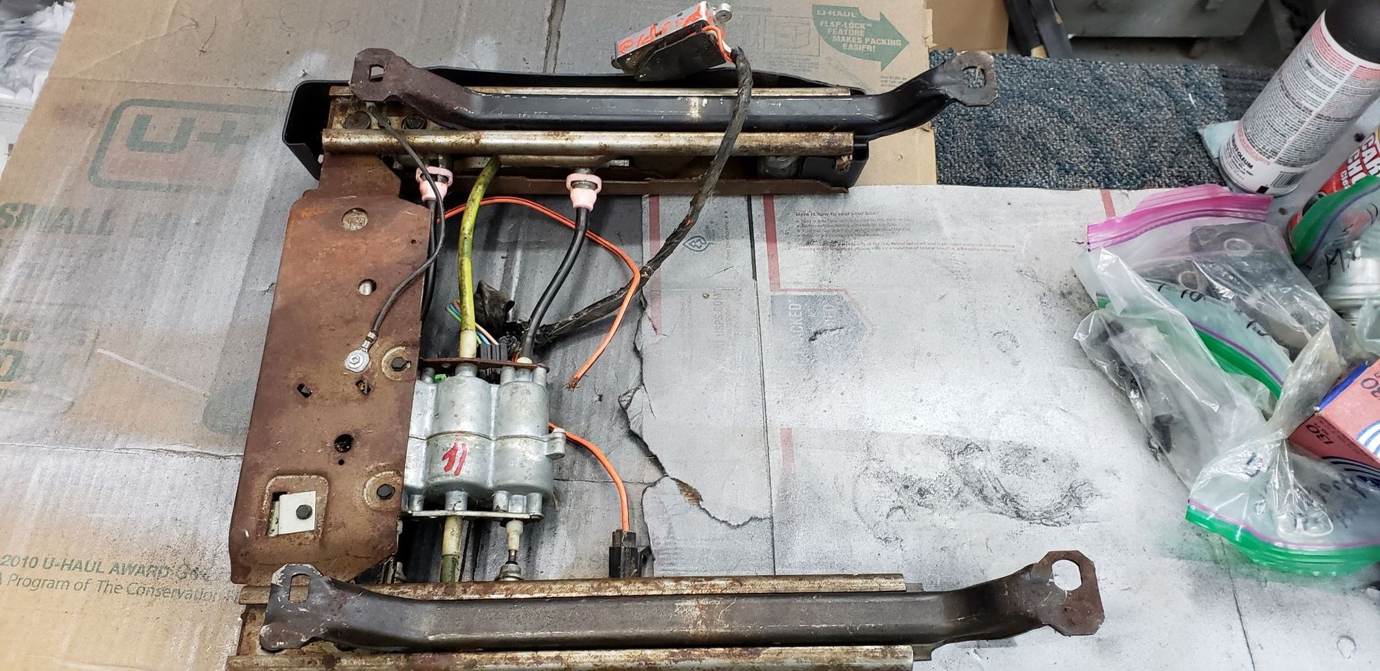

I took some pics of the power seat base. Maybe that will help.
And here is the seat it came out of. Hopefully somebody can tell me what this seat is actually out of?

I can't say for sure what your seat came out of. But I do have a 6 way power bucket seat track that looks just like yours. I think mine came off a Buick Riviera seat. A lot of Riviera's came with bucket seats and consoles. The bucket seat is the same as the A-body seat, the only difference is the seat rails where it bolts to the floorboard.

I just looked more closely at your power seat setup. The cables connect with a pink quarter turn clip, mine don't. I did pull power seats from a 1978 Delta 88 years ago and they had the same style connectors. So your seat may have come out of something from the mid to late 70's.

Thanks for the replies. It always amazes me the details that the guys on this site can pick up on out of pictures. I guess at the end of the day, it doesn't really matter what the seat came out of as long as I can redo it in the 70 442 style and have it fit my car. I was concerned that the big car seats would be wider than then the A body seats. It doesn't sound like that will be the case.
