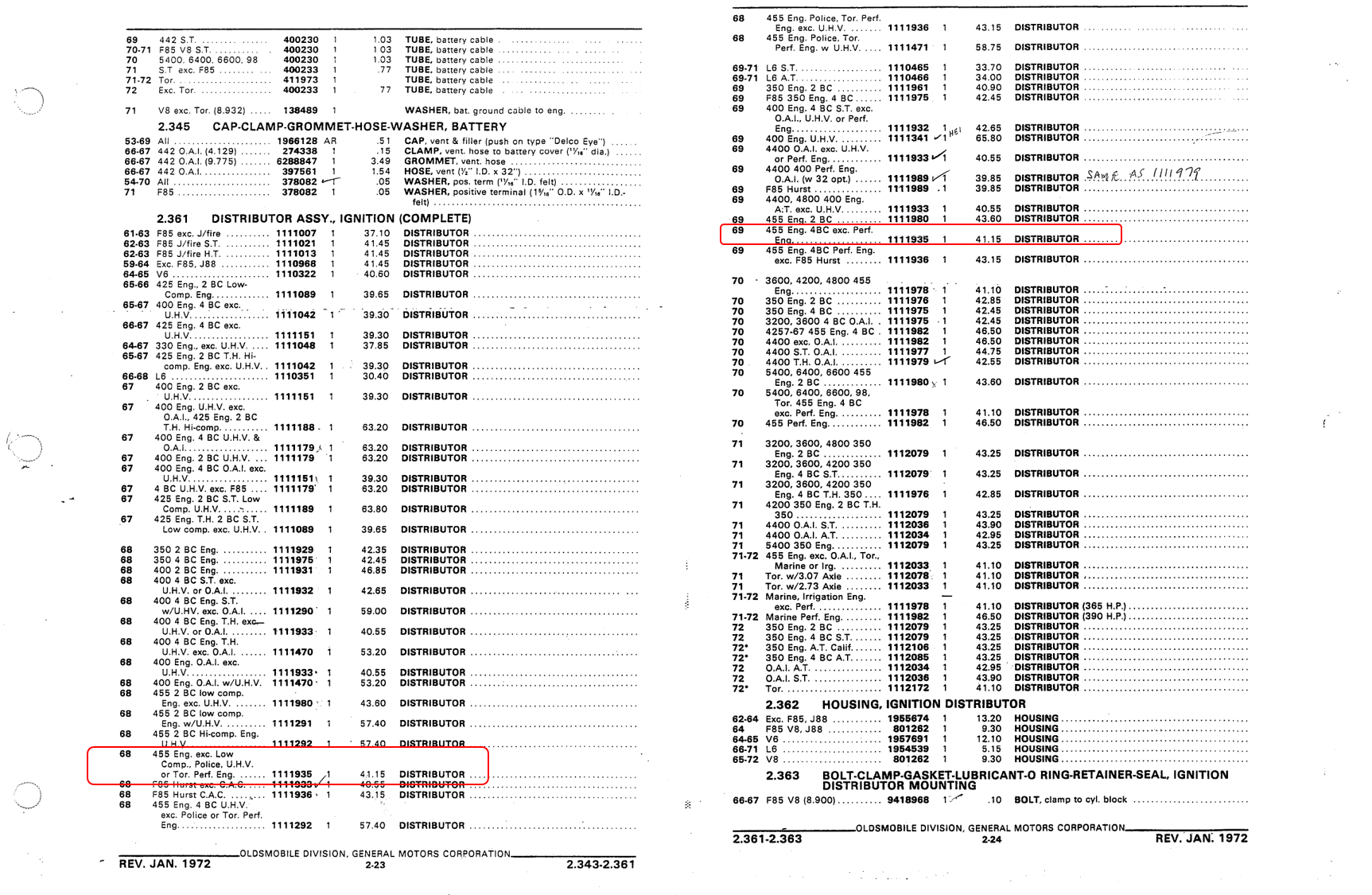

I have a 1969 Olds points distributor # 1111935 date code 8L7
Can someone with a 1969 shop manual tell me what engine and model it came from? Thanks, Bob

Thanks guys, but can someone look up the exact fitment in the 69 chassis shop manual? See the chart in engine tune up section 6C. I have one to sell. Thanks

it is not listed in Mondello's technical reference manual and I don't see it in the 69 CSM . are you sure you are reading the numbers correctly? what car did it come off of and do you have any pics of the numbers?
Old Aug 17, 2019 | 09:05 AM
From the Jan 1972 printing of the parts book, that is a run-of-the mill 455 4bbl distributor, used on 1968-69 full size cars. Specifically not used in performance or Toronado applications.

One of my friends sent me a copy of a page from section 6C - Engine Tune Up, from a 1969 Chassis manual. It lists all the 69 distributor specs including this one. See Second from the bottom. It is apparently for high compression 455's (except W-34) My 68 & 70 chassis manuals had the same chart in the same section 6C.
except W-34
Old Aug 17, 2019 | 06:05 PM
Posts: 26,066
Note the W-34 option applicability for the 1969 Toronado. The standard 455 engine of this model year was a 375 h.p. engine. The W-34 option was the 400-hp engine. This distributor was only applicable to the standard Toronado 375-hp engine.
Old Aug 17, 2019 | 06:27 PM
Sorry, but that's not correct. The '935 distributor was used on EVERY high compression 455 except performance versions like the W34. That means Delta 88s and Ninety Eights in addition to Toro. All 4bbl versions of the 455 were high compression in 68 and 69. As I said above, here are the pages from the parts book. Note also that the H/Os used a different distributor.
Old Aug 17, 2019 | 06:37 PM
Posts: 26,066
Right-on, Joe. I should have perused the following. DEALER SPECS 1969. Thanks for the clarification.
