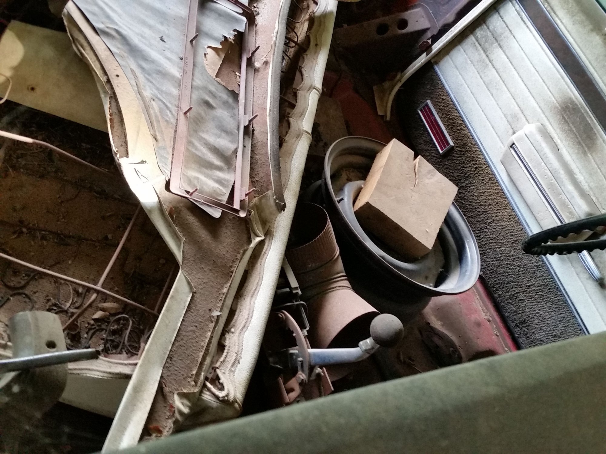

Dash

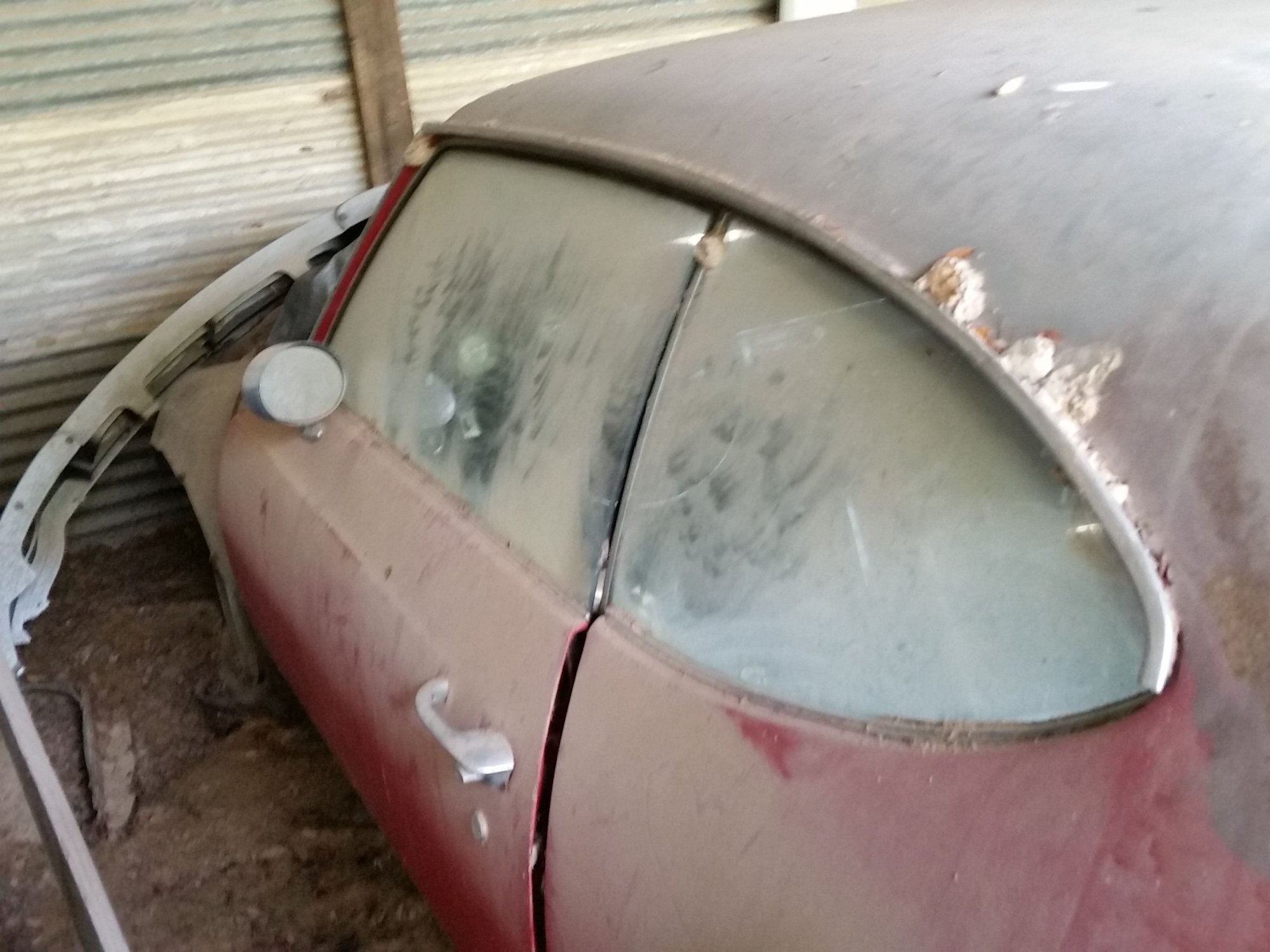

Left Side
Right Side..
Yes it looks rough.. Not as bad as the pictures look. Still in the barn. Sorry for the big pictures.

Looks good but I'm pretty sure that's a 70'

Rear View
Will this help in deturming the year? They were saying 1969... They could be wrong.. I am going to get the VIN number AND that should nail it down
Old Apr 17, 2018 | 04:59 PM
zeeke's Avatar
Joined: Jan 2016
Posts: 1,019
From: Nassau County, NY
Definitely not a 69' could be a 70' to 72' those years had horizontal lights the 69 where up into the trunk vertically. I'm more familiar with the Supreme body style and that is definitely a Cutlass "S", not sure if the 71' 72' had the chrome roof gutter rails. I remember those years being painted for some reason so I'm sticking with 70' until proven wrong. That should happen shortly.

+ 3 on it being a 70. The steering wheel is at the least. Dash is 70-72 for sure.
Also the 70, didn't have the rear qrt extenctions like the 71-72. Almost positive it's a 70.

Inside wheel in the floor
