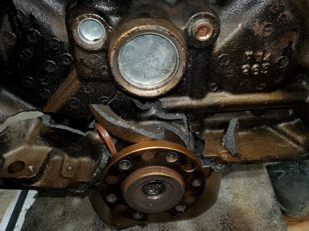

OUCH 403 Goes Bye bye
I'm a fan of the 403s but stuff does happen. Owner does a good job of explaining and picture taking. Imo.

It definitely tossed its cookies, but with a new bottom end, back in business.

He should have used a solid main web block

Just shows what happens when a 403 makes power with a manual trans, boom! Marvin is a good guy and his diesel build will go like hell. I am definitely staying automatic and not using a 403 crank to avoid this carnage.

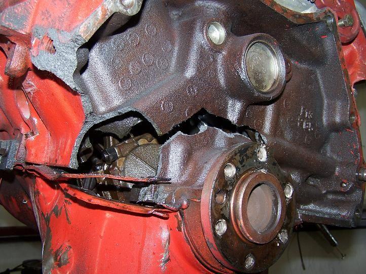

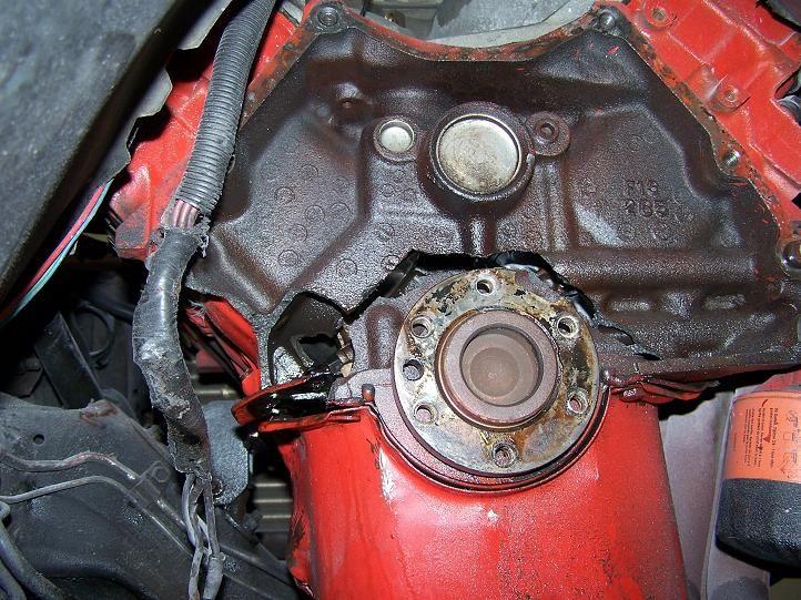

Hmm...the same type of failure.
These two are from this site. I know it happened at least 10 years ago.
http://www.jsmachineoldsmobile.com/403CARNAGE.html

Kennybill thanks for providing the link and thanks to Marcar for providing this information as a fair warning. With that said sorry this happened, but as he said he was definitely pushing its limits. 6000 + RPM shifts and 106 MPH in the 1/4 is brutal. This engine on its best factory stock day and setup was lucky to see 80 MPH in the 1/4 and likely was meant to shift around 4000 RPM peak... Marcar was doing this in a 3800 LB car. So his 403 was pushing close to double the factory HP, DOUBLE. He's lucky it lasted this long.
