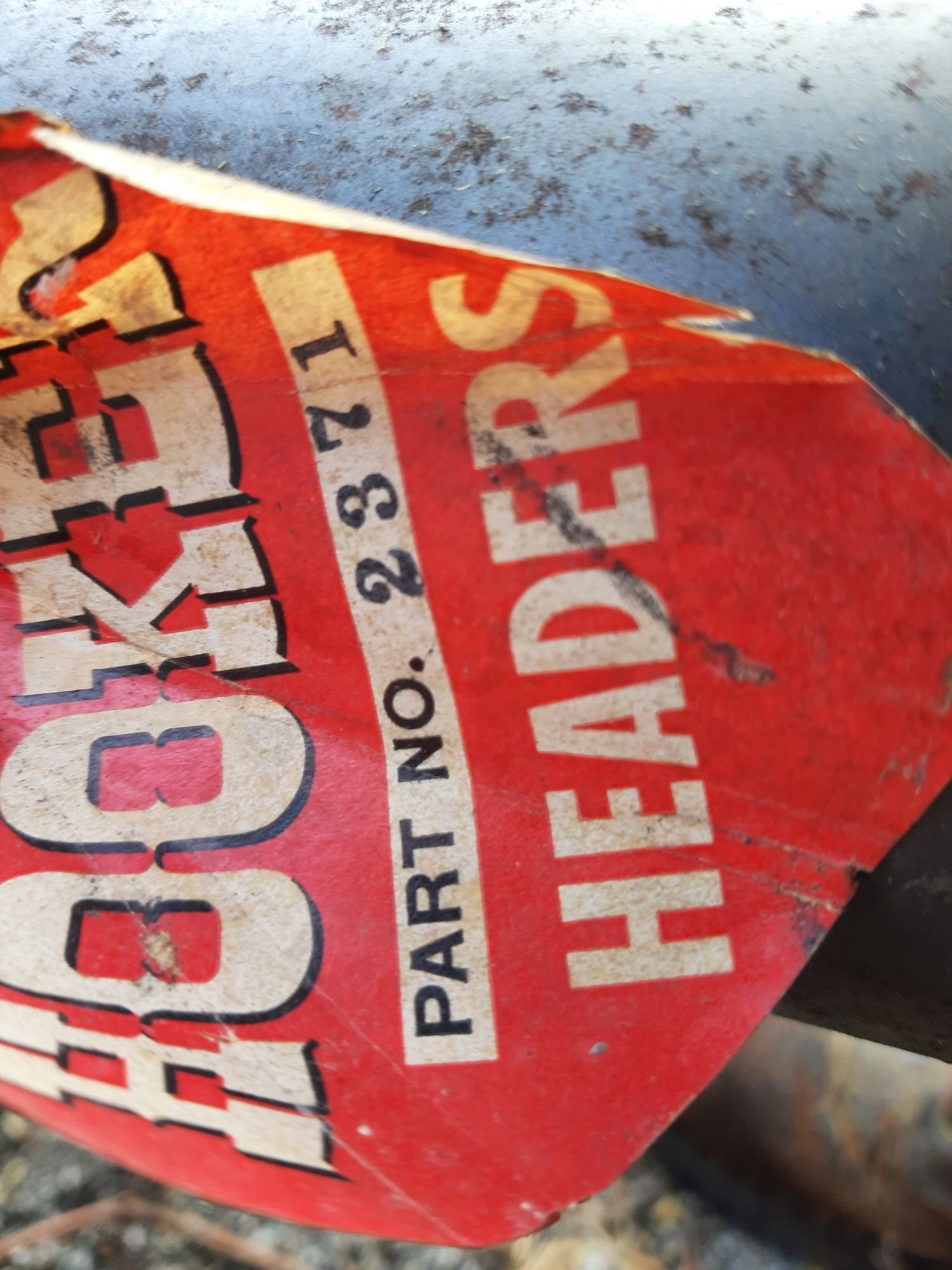

Old Hooker header Application #2371

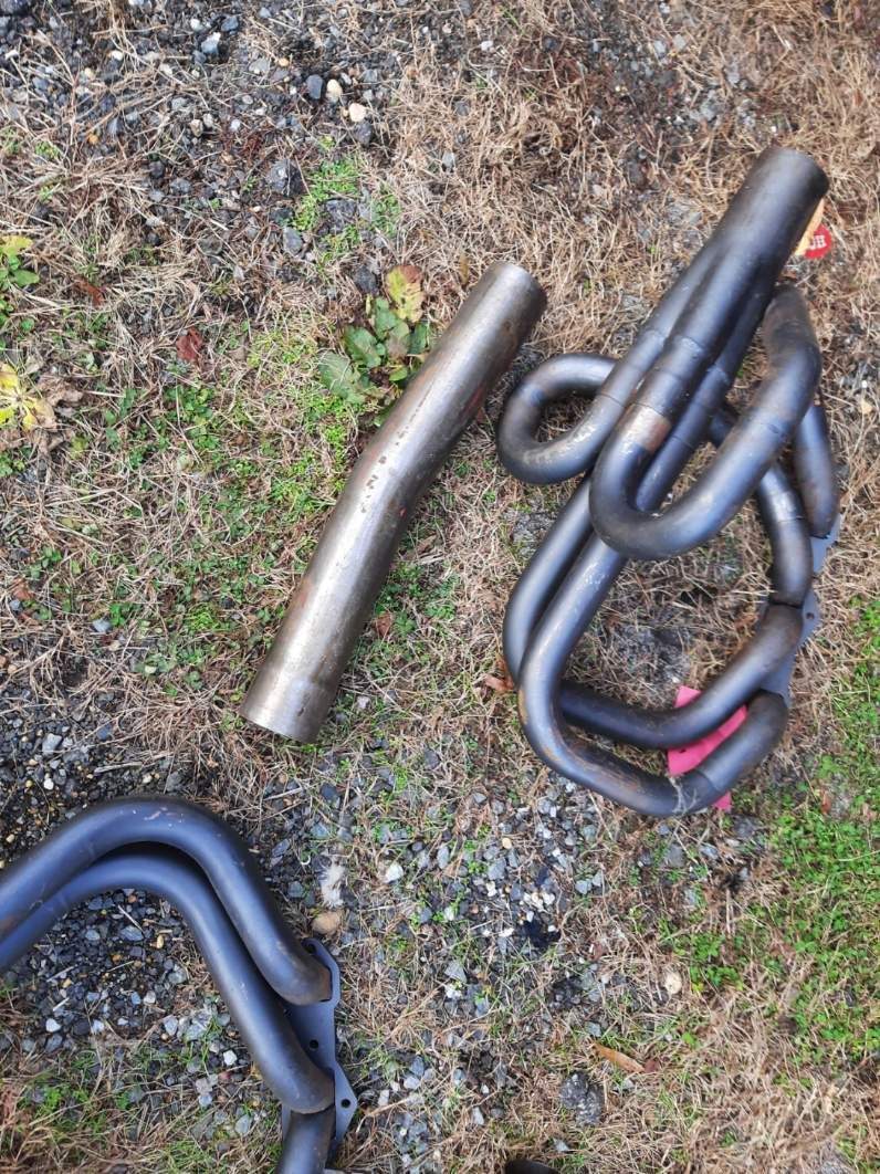

Sold these nos headers over the weekend. I bought them for a 67 so many years ago, 2inch tubes adjustable. It appears the fender wells would need cutting as one tube on each side is separate. Anyone ever have these and what did you have them on? just curious, guy wanted them for a 68 and up 442. Funny he called Hooker Tech, they had no idea.

They wouldn't be small block, 64-67, would they? They look really short from the collector to flange. ARH is the only one currently offering them.
The G body Super Comps wrap a tube around the frame.
Doubt they are small block, I believe when these were made they were designed for 65 thru 67 442. That was marked on the box and later written in black marker 68 up... These were probably discontinued in the late 1960's early 70's if I had to guess...

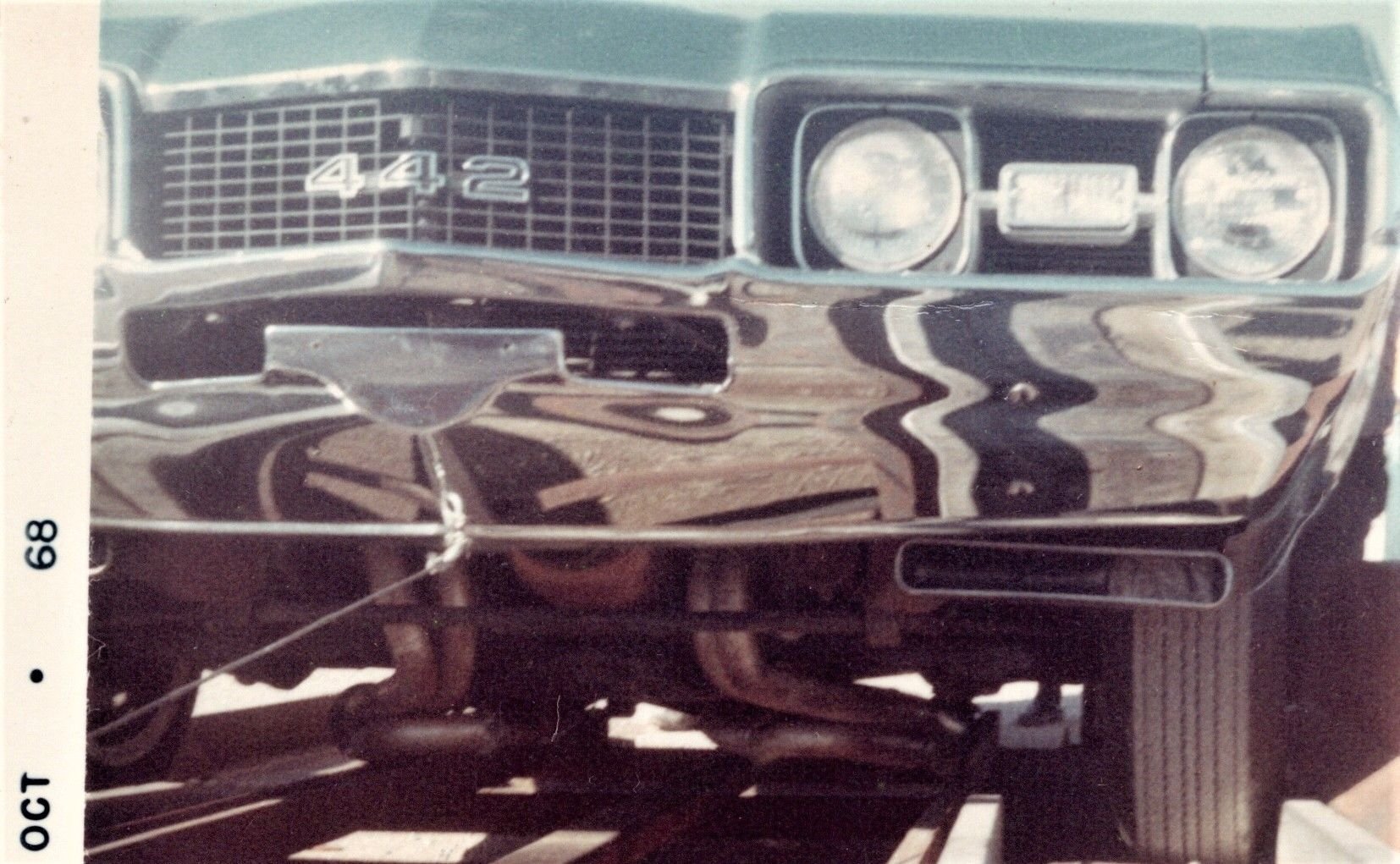

Two pics, maybe help to show them more clearly installed. This happens to be on Berejik's second car/ 1968 NHRA World Finals in Witchita, KS.

Duh's Avatar
Duh
Joined: Dec 2016
Posts: 353
Not 180 headers.

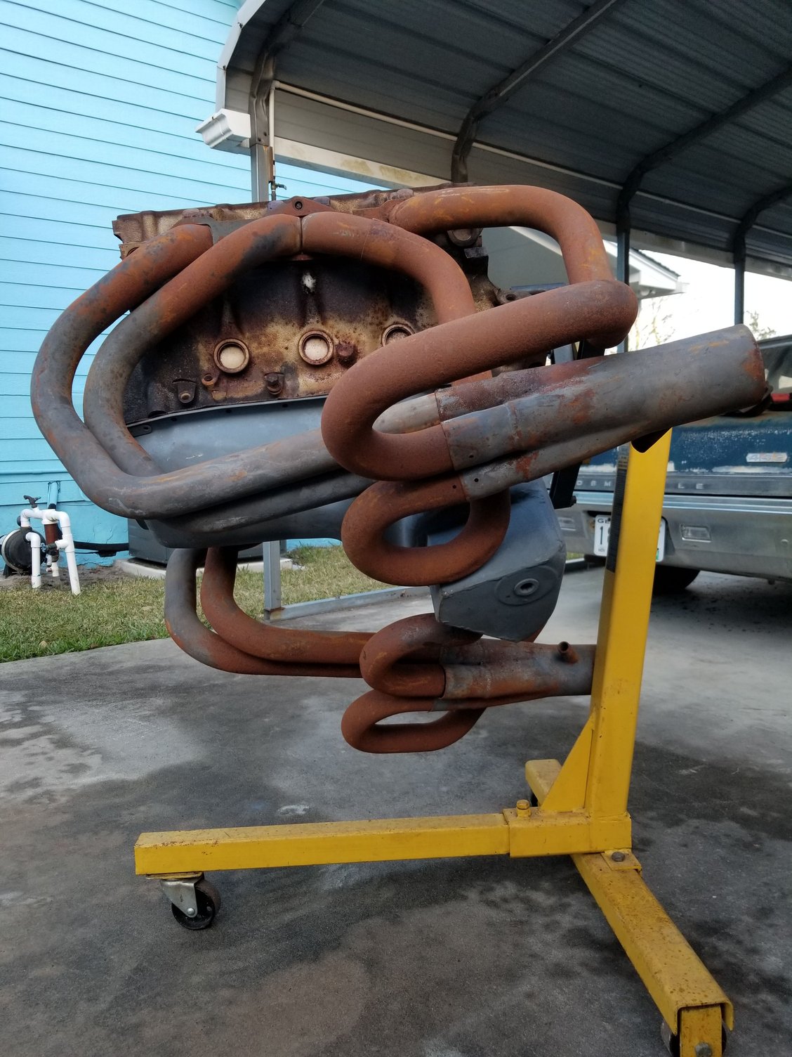

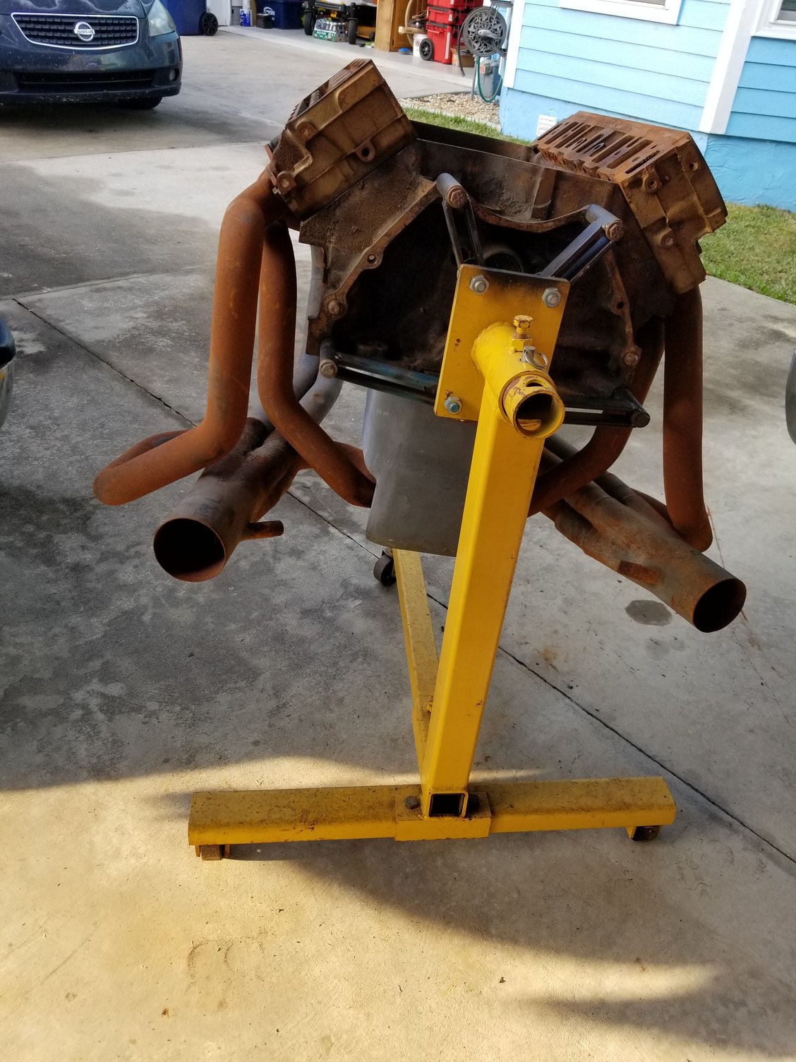

A couple pics of my early Hookers in "mock up" on the engine stand. These look the same as the ones Oldsmaniac posted in the opening of this thread; they do not go outside of the frame and do not require any cutting of the fender well. They do pass two pipes under the leading edge of the oil pan sump making a dropped sump pan a challenge as I have tried to show.
The same I agree.
