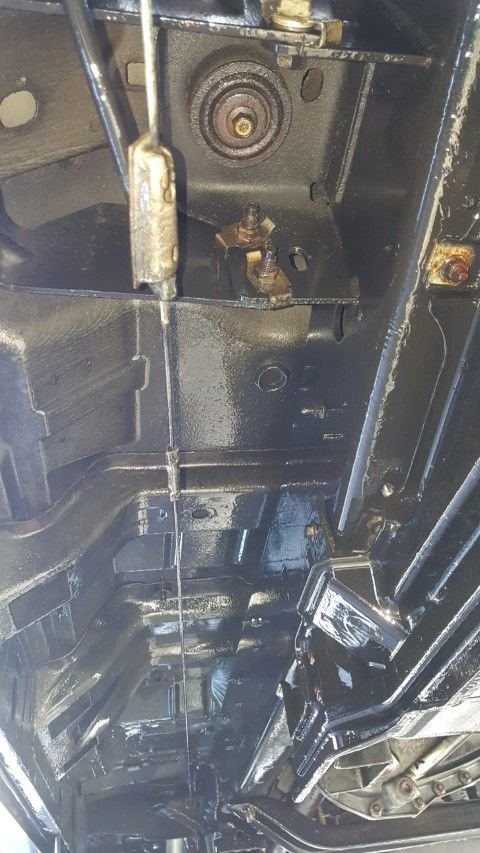

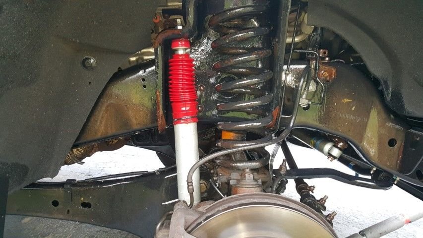

Krown, Fluid Film, LPS2. Do something. I've been having my F250 sauced with Krown annually for 13 years. No rot.
You can purchase Krown in spray cans, gallons, 5 gallons, 55 gallon drums.
The 442 got the spray cans in all the right spots.
Used oil has corrosive acids in it.
https://www.krown.com/en/
https://www.krown.com/en/locations/u...east-rochester
$160/annually.
My truck has not depreciated because its not a rot box. Dealers are constantly asking to buy it for what I paid it for.
Takes about an hour if you have Krown do it. Make sure they sauce the sczhit out of it. One branch here doesn't do it as heavily as the main branch.
If you drive it through salt I suggest annual treatment. It has to be reapplied every 364 days for the 10 year warranty to apply.
If you live in non-salt but damp humid regions I suggest doing it at least once.
-Don't park it on concrete, it will stain.
-It will drip for 2 weeks.
-Its water soluble.
-It creeps, lubricates, has inhibitors.
-It readily washes off black top, coveralls, and body parts.
-The undercarriage gets slimy to work on after 13 years of being sauced.
-It will swell some rubber items.
-Its designed to be reapplied annually.
-The alternative is ROT. Ill take all the negatives over rot.
I do see another produce out there called Corrosion Pro Plus. From what I'm told its a one and done application $1500.
Below pics are right after an application on my 2011 F250. This truck has been driven in salt.
