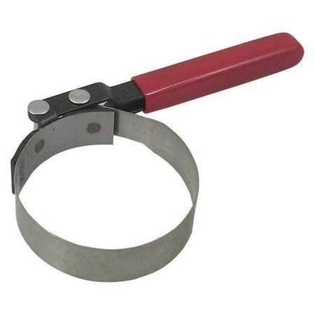

I've never found an oil filter socket that worked worth a damn. I've been using a version of this band style wrench since the 1970s with no issues.

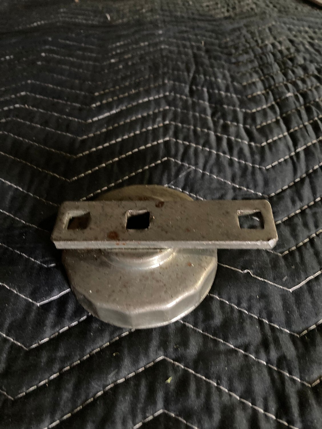

This is the one I’ve been using for 50 years, I’m sure it was made before China existed

On a '70 455 I'd prefer the band type with a pivoting handle if the car has factory exhaust. If it has headers or pipes in the way of moving/swinging the band type wrench then a socket may be the better option. My experience with socket type/cap style wrenches is that they slip on filters that are on too tight.

"before China existed." Excellent.
