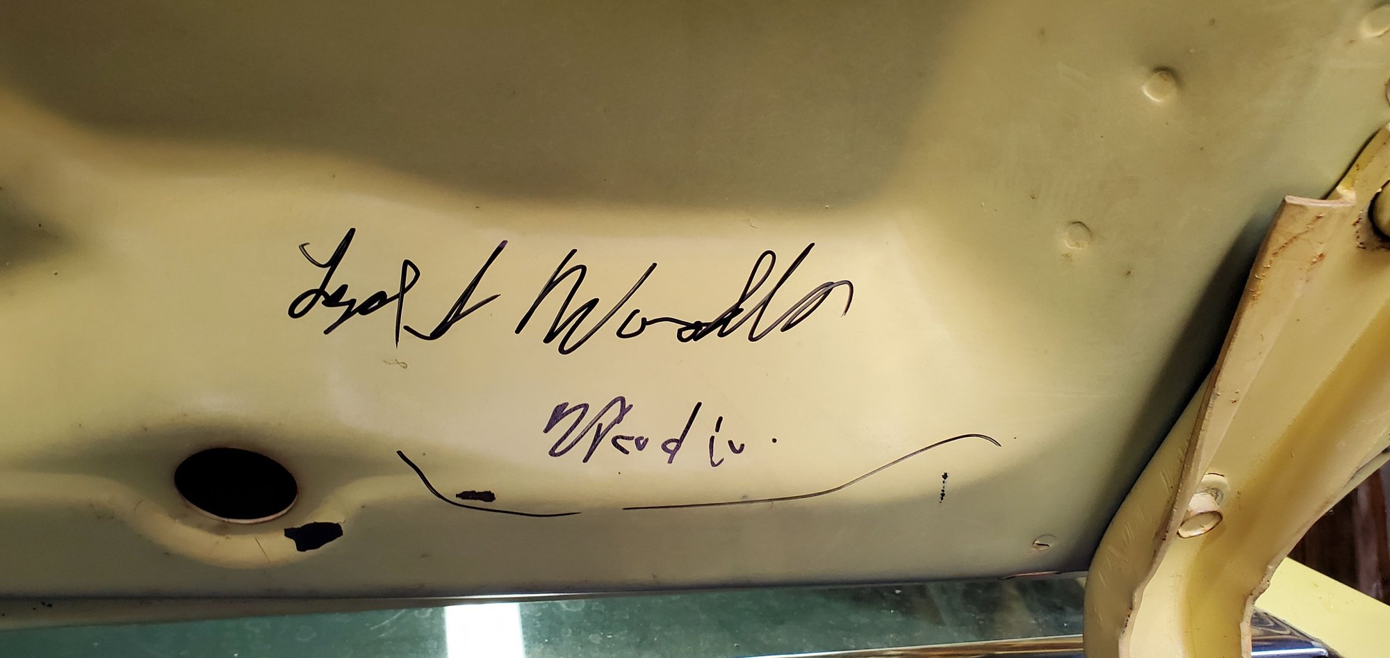

Here's some of the great people I met sign my car!
