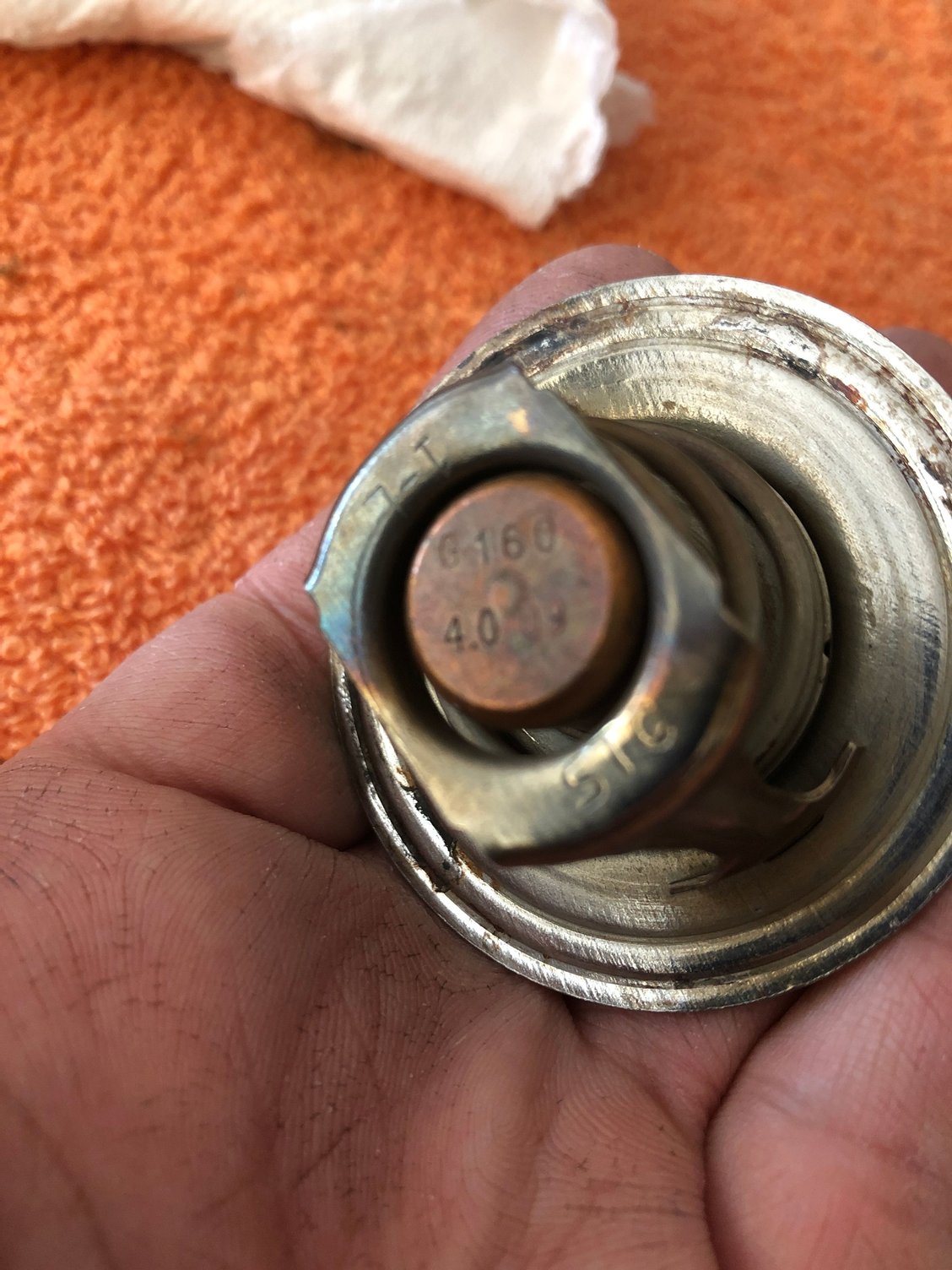

Hey guys!
it has a 160 in it not sure if it was opening I didn’t boil it but took a torch to it probably not the brightest idea and it opened which who knows what the temperature was maybe a lot higher.
I ordered a New 160 i already put a New cap on 15 pound closed system.
15 pound cap closed system ok?
