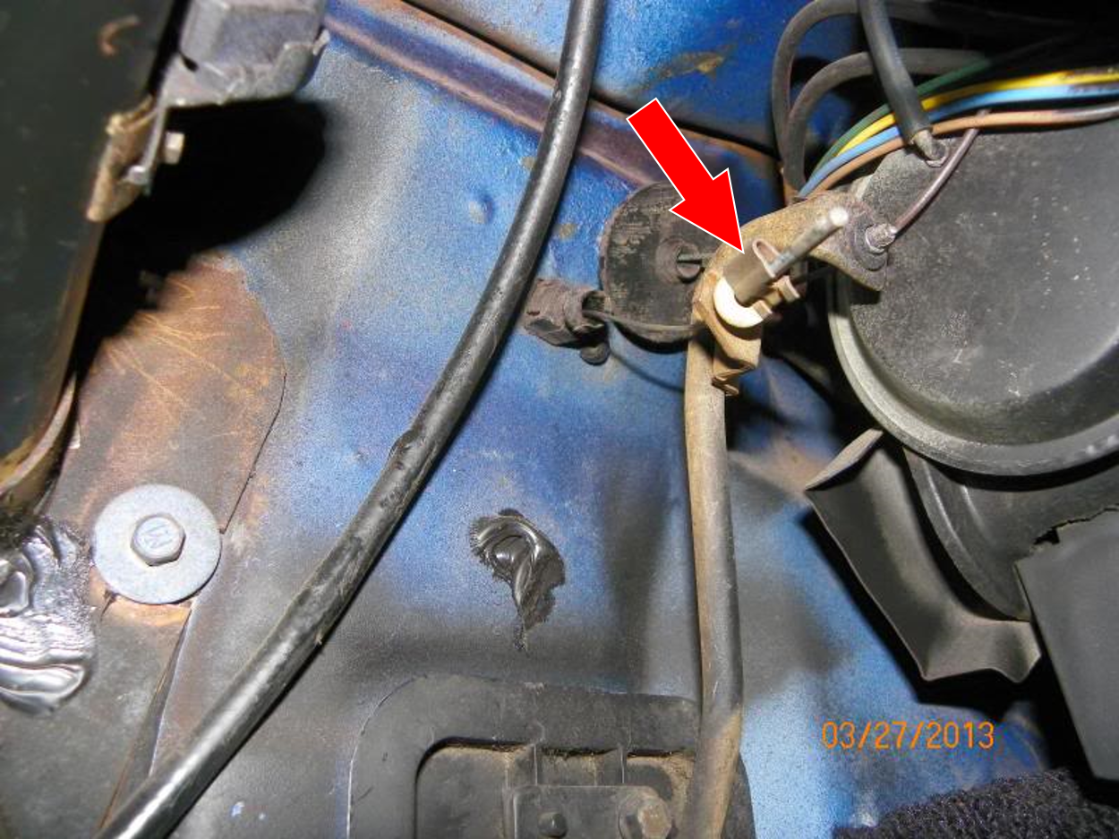

The TH350 kickdown cable attaches to the gas pedal, not the carubretor.
It's the lower cable in this picture.
https://classicoldsmobile.com/forums...ckdown-130920/
Just an FYI, the cable in that photo is NOT connected to the accelerator using factory parts. Here is what the factory connection looks like, with the spring clip that can be adjusted.
