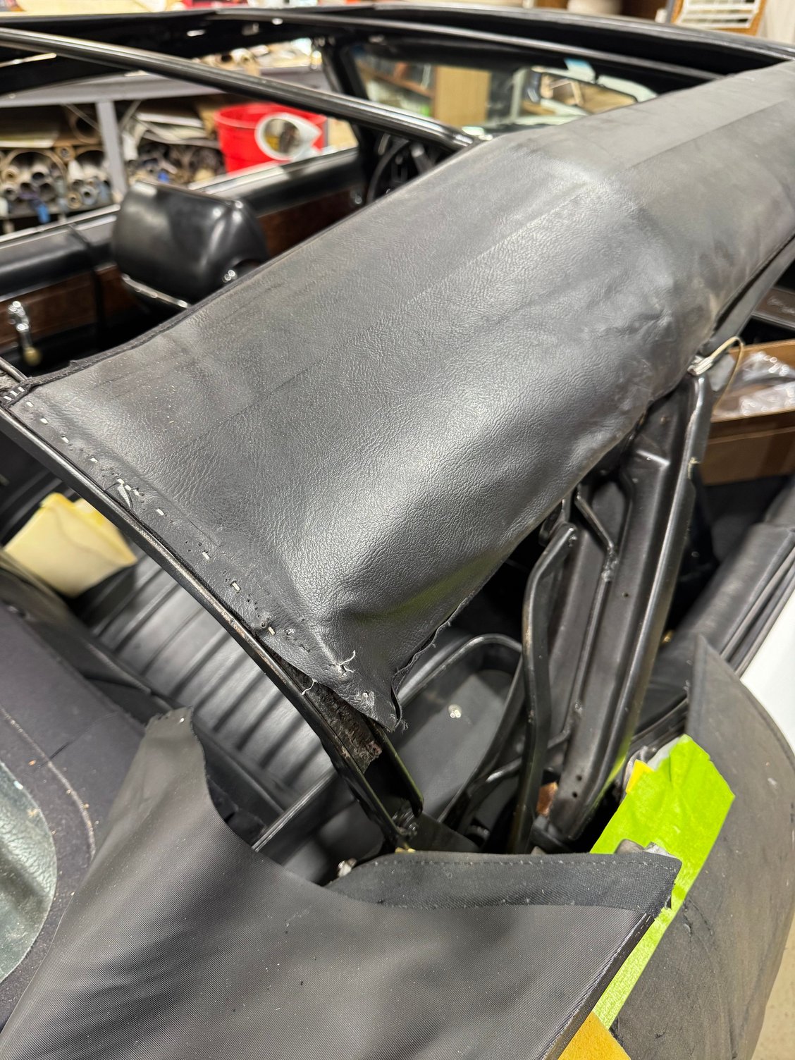

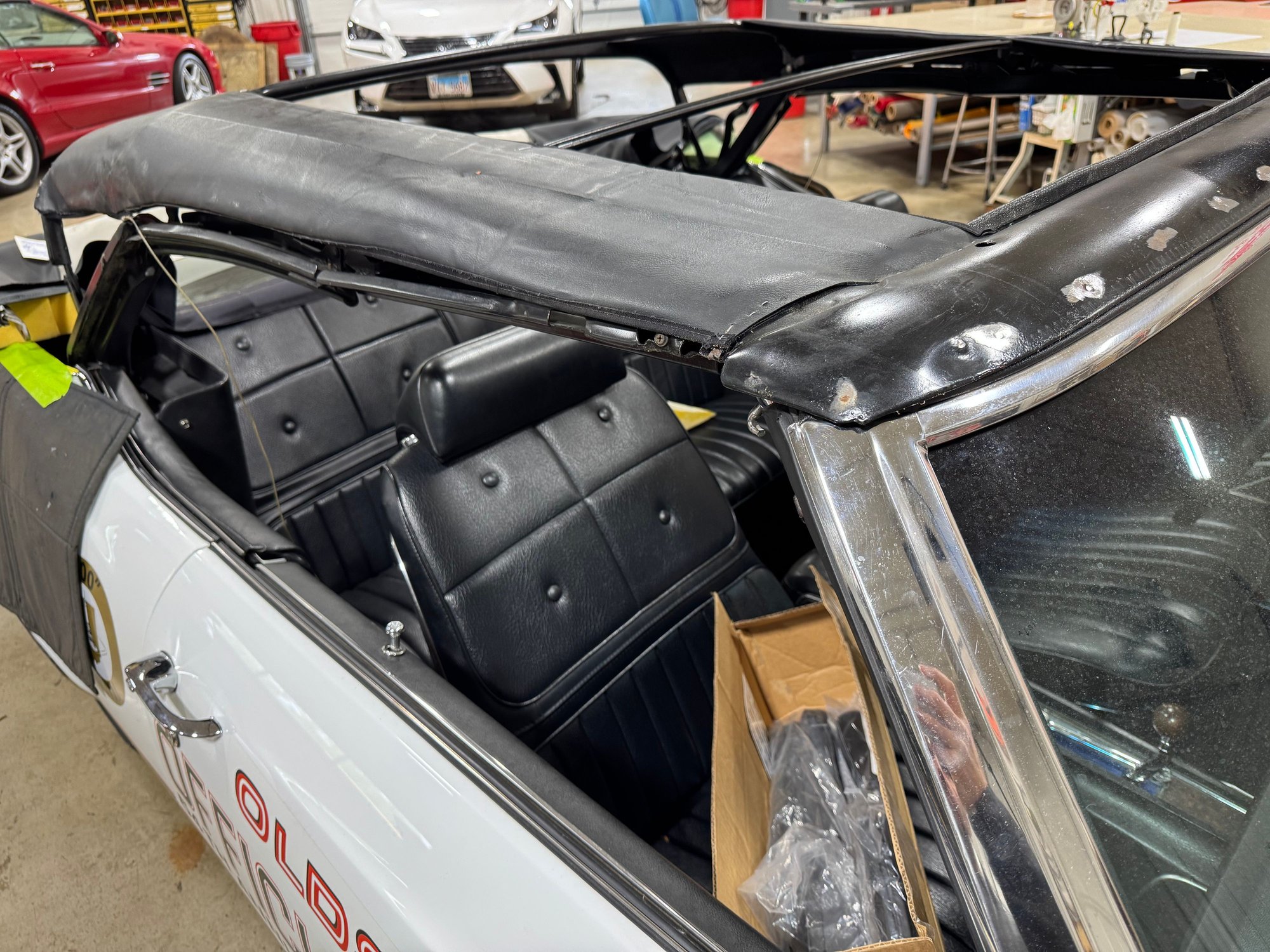

Dropping off the pace car for a new convertible top tomorrow. Anything in advance I should keep an eye out for or mention? Shop is quite reputable and does very nice work.
I have new rubber seals all around, black vinyl for the header area, and I know they're going to need to reconfigure the side glass as the two chrome strips on each side need to be installed, etc. Any lessons learned from those out there that have had top work completed?
The frame has been "restored" but a previous owner left the top down for 5+ years and the material didn't hold up. I installed new cylinders and pump a few years back.

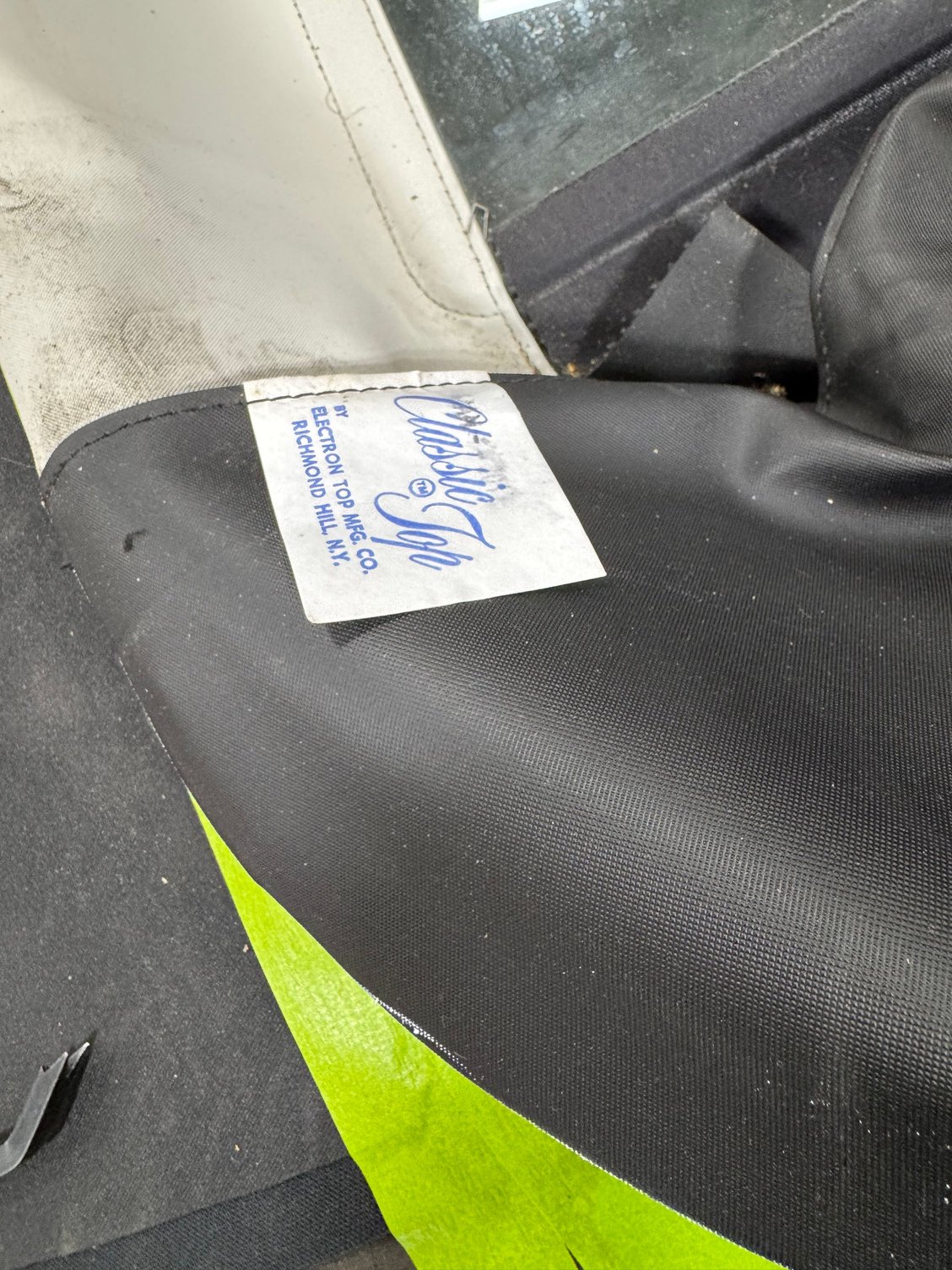

What brand top are they installing? Electron was the best for a long time but they sold out to another company and word is quality is no longer there.

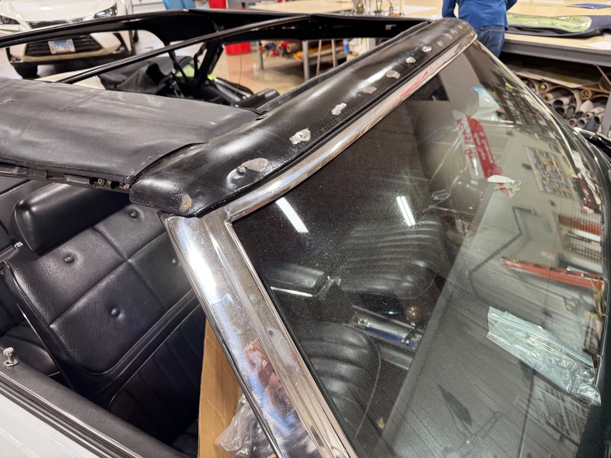

Good pointers, thanks. The top is from Robbins, I believe. The side glass is the biggest concern as it's a mess in terms of alignment. Hoping they're able to get it dialed in.
The installer suggested new cables so we're doing that as well.
Hoping the new chrome side glass trim with the rubber from Fusick fits well. I believe in the package it also came with the tape for the edge of the glass as the trim appears to be compression fit.

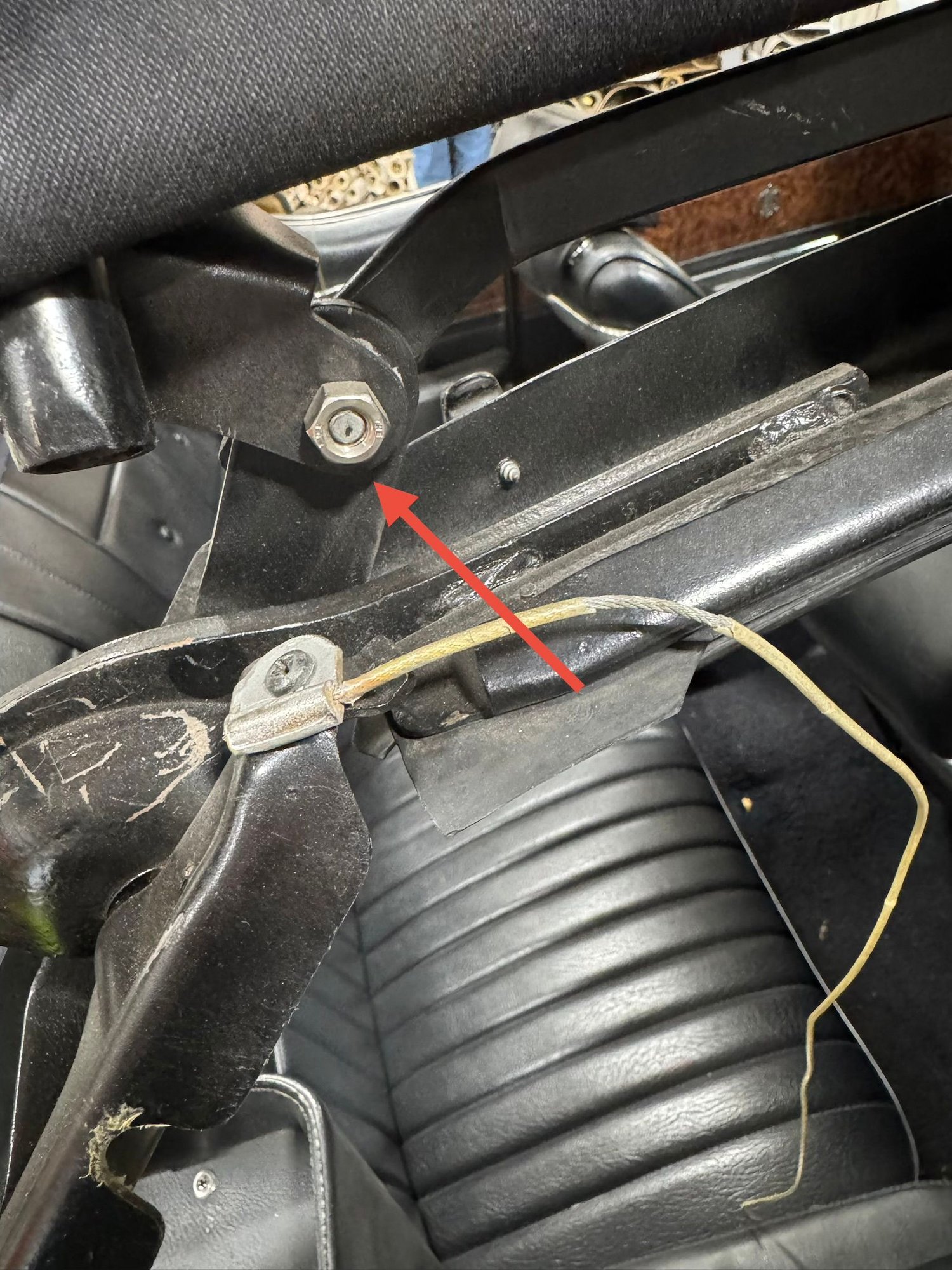

Shop called me today and asked me to stop by. When the top is operating, there appears to be a "popping" sound with the frame and then it starts to move. He showed me the hardware on the frame is Home Depot junk. I went ahead and ordered a bolt / pivot kit from the Parts Place. Not sure how correct TPP hardware will be but it'll certainly be better than what is in there now and it's close enough to pick up. Anyone use their kit?

In case it helps, you can get good hardware which is not exactly factory standard.
The outer diameter of those bolts and related nut thread aren’t exotic. It’s mostly a matter of finding hardware that will be easy on whatever fabric or parts rub against it. More or less this means hemispherical (rounded off) bolt heads and nuts.
On my ‘66 98 convertible, it always had acorn nuts on the inside of the cabin (i.e. the factory bolts were fed in from the exterior facing direction - inward). But perhaps they were wrongly reinstalled in reverse & the hemispherical acorn nuts should have been on the outside so that the rounded hemispheres didn’t tear the top fabric.
Anyway I always thought acorn nuts were a good solution to secure the lifting mechanism and have a safe surface for the top fabric to ride against here & there. Their rounded nature seemed to be a good way to _not_ wear through convertible top fabric.
As I recall my original factory bolts were chrome plated bolts with rounded edges that also had a hemispherical shape. You can guess I liked these too on the idea that rounded bolt heads would hurt fabric less than standard hex bolt heads. But if you can’t find those these days, I’d put the acorn nuts on the exterior side of the top-raising bolts and go with hex-head or (like I did) use Allen wrench nuts to screw into the acorn nuts on the outside.
I’ve never needed to shim the outer diameter of my bolts with teflon or any kind of gasket since the hydraulic systems are so strong. Just acorn nuts, bolts and maybe if you’re into it, a teflon washer or 2 on each end, just to encourage smooth top movement.
The washers I’m referring to here would go on the inside and/or outside of the black top hinges to create a flat consistent surface (that resists wobbling) to ride up and down against. More or less you’re putting in some smooth riding surfaces which should encourage smooth (up/down) top operation and limit/resist side to side loose hardware slop.
I’m not an A-body guy, but these tips & tricks worked for my ‘66 98 top which is mechanically pretty close to your Cutlass/442. I hate mechanical slop from 50+ years of wear and love tops that go up and down smoothly. Since we big car guys have to get creative, maybe this helps you.

The load bearing stresses on the top frame are miniscule so the cheapest hardware that'll fit would almost certainly get the job done. That is, unless (God forbid) you were in an accident or rollover. I don't think the factory hardware would do much to save your a$$ but it was/is much better than today's imported hardware store junk.
Luckily, my top has its original hardware and if it did need anything, I would have sourced used originals.
Looks like whoever put the last top on that pace car really took some 'creative liberties'.
