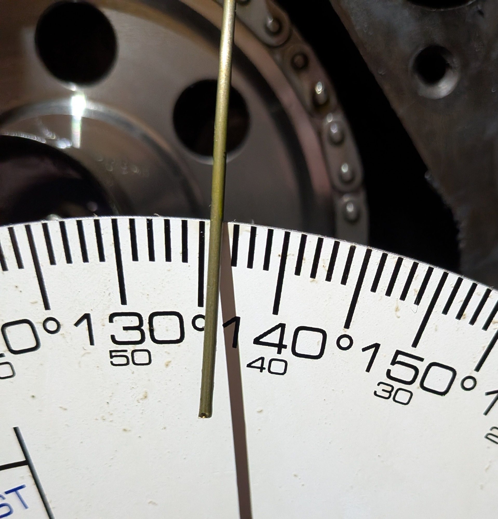

#6 Intake @ .050 closing.

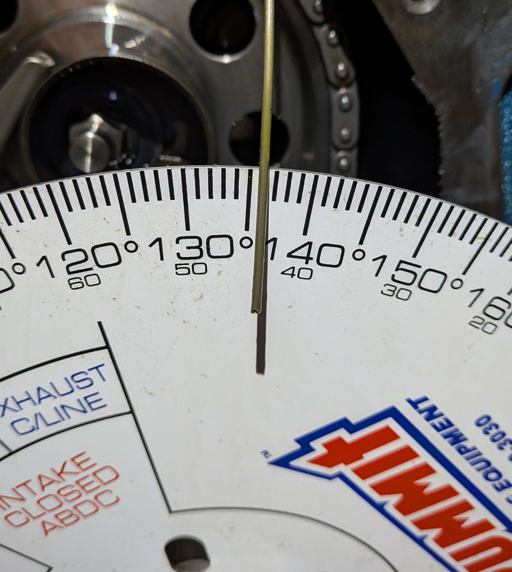

Moved dial indicator back to cylinder #1 and reran the .050 intake closing.
Old Jan 15, 2026 | 03:33 PM
CANADIANOLDS's Avatar
Joined: Sep 2013
Posts: 2,928
now your int c/l is 110 and your int closing on each bank is the same so my theory is out the window.

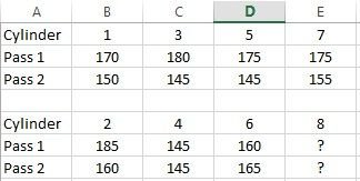

Before adjusting the timing/ICL I decided to baseline the compression check again. I wasn't able to thread the gauge into #8. All plugs out, throttle wired open, all passes done as found with no oil added to the cylinders.. I did two passes today.
Why am I seeing some 20 lb swings in compression? The only thing I think that's changing is that the lifters are pumping up.

Posts: 2,928
Originally Posted by v8al
Before adjusting the timing/ICL I decided to baseline the compression check again. I wasn't able to thread the gauge into #8. All plugs out, throttle wired open, all passes done as found with no oil added. I did two passes today.
No oil? you have to have oil pressure

That's not bad thinking. As for your timing issue try dialing just the open event. Then check the closing. This should be done at 50. If the closing is ok with the intake dialed in then measure you centerline using the ramps at 50. It should be dead on. If not check for something loose or moving like your degree wheel.
