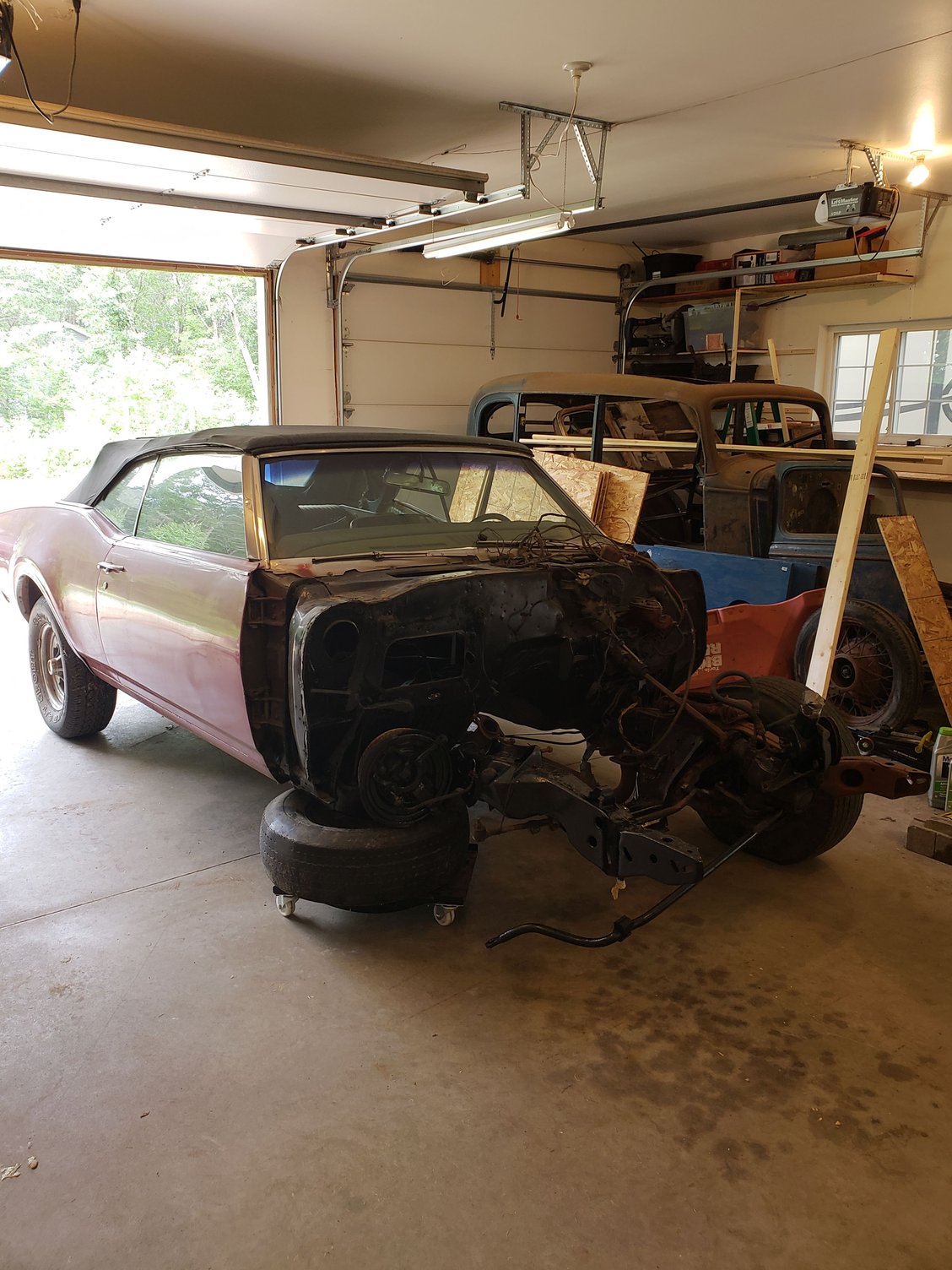

OK, here is the issue,
I am getting ready to put the motor back in the car, the car is just on dollies at the moment, without the steering column, brake and clutch pedals, emergency pedals, seats etc the car is facing into the garage with the engine bay at the back.
it's a one car garage , so there isn't really enough room to get the engine down the side, so I will need to move the car down and out of the garage, get the motor dropped off and moved to the front, then get the car back in so I can put the motor in, then the tranny , etc etc
I thought about getting a tow dolly and place the rear on that and pull the car out and try to back it in afterwards, but what if the front wheels move ? is there a way to either lock them in place? or steer them without the column in and without using a big vice grip as a tiller?
should I just get a flat bed tow service to winch the car out and up and then have him drop it back off?
I have a fairly steep angled driveway, and I generally work by myself, I can push the car back by myself on the dollies but once it hits the drive I envision whoosh down into the street and into the neighbors car lol.
The reason I am a little impatient to get the motor in as quickly as possible is I just sent the motor to be rechecked and restarted on the engine stand, it was built over 7 ( cant believe that) years ago, he pulled the top and relubed the cam etc etc etc and fired it up, I want to be able to start her up a couple of times a month to keep the internals lubed. plus put a fire under my azz, to get her done.
any thoughts?

i have a tow dolly and will say that backing one up is a bee otch.ya know a pic of your driveway could shed some light as to a better solution,or not.but as always we love pics.
