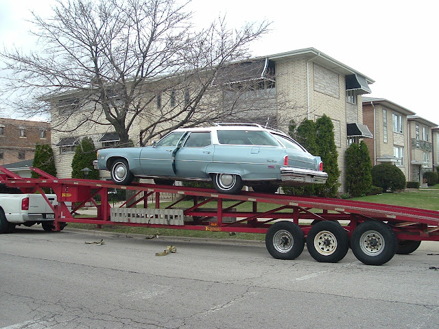

ok so I got busted on my air cleaner decals (thanks Jaunty) so I decided to come clean with all of the little "personalizations" that I have made to my car(s)
I have always prided myself on originality, but truth be known, I have made some enhancements. All for the good of course.

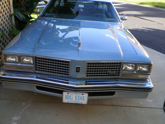

I have added a hood ornament to the wagon (the 88 had one when I got her - not right but I like it - need it in fact to aim down the lane
I added a 455 emblem to the wagon's grill

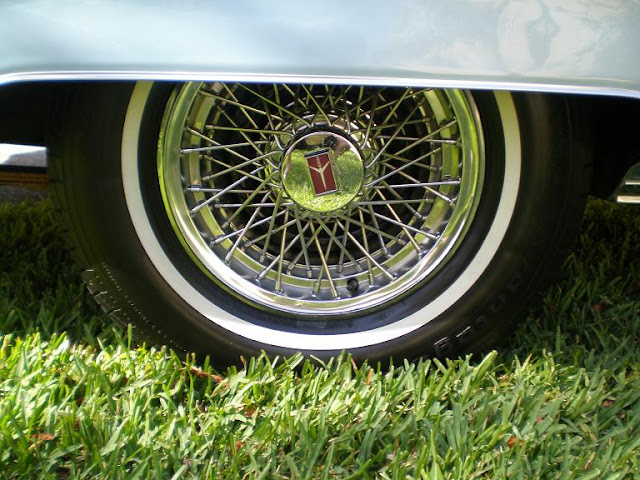

The wagon got 77 vintage wire wheel covers
old:
new:

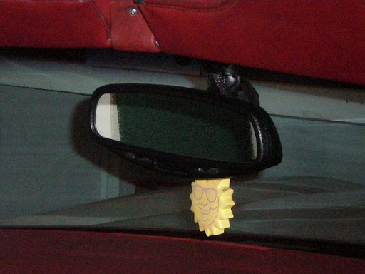

Oh yeah the mirror on the 88 was in need of replacement (dreaded sideways wobble) so I put one of those fancy auto-dimming compass/temp/map light ones on and I love it
)I added a 455 emblem to the wagon's grill
old:
new:
