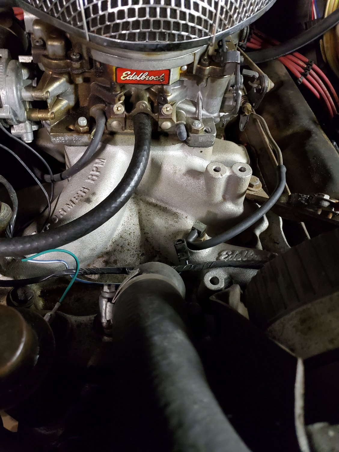

Got everything apart and ready to lift the engine. I'm going to try replacing the pan without removing the engine. Where should I lift it from? I have an aftermarket Edelbrock intake manifold installed. I don't see a loop for a hoist, but there are two bolt holes on the top next to each other. Is there something I screw into there? My old oil pan is pretty banged up and I'd like to replace it. Which replacement should I choose?
Old Jan 16, 2021 | 10:10 PM
Posts: 12,801
There's factory lift points on the intake in a crevice and a loop. I've had below-the-hook lifting devices made for Toyota for my job, and we cheat and use holes drilled in the heads and remove the hooks after we land the engine for reuse. I'd recommend a bolt in an accessory bracket hole on the head on the front corner and a similar hole on the opposite corner.
Please do not work with it suspended. You may wish to consider blocks and longer bolts on the motor mounts or something, but you need the equivalent of jack stands to hold it up. Use the cherry picker to raise and lower it, but not hold it there for work. If it comes down on your hand, it's done.

There are two bolt holes at the bottom front of the block that seem like they would be a sturdy place to lift the engine from. Problem is, the chain would have to pass by everything else.
These are the holes on the top of the intake manifold I was talking about:

If your motor doesn't have the lift loop bracket bolted to the intake, you can also remove your carb and bolt an engine lift plate to the base - lift plate should be easy to obtain from any good auto parts store for maybe $20 or so.
Old Jan 17, 2021 | 09:27 AM
As long as the transmission and xmember are still in the car and attached, lifting the engine at any point will accomplish the same thing. There are many points to attach a chain below the intake on the heads or block.
