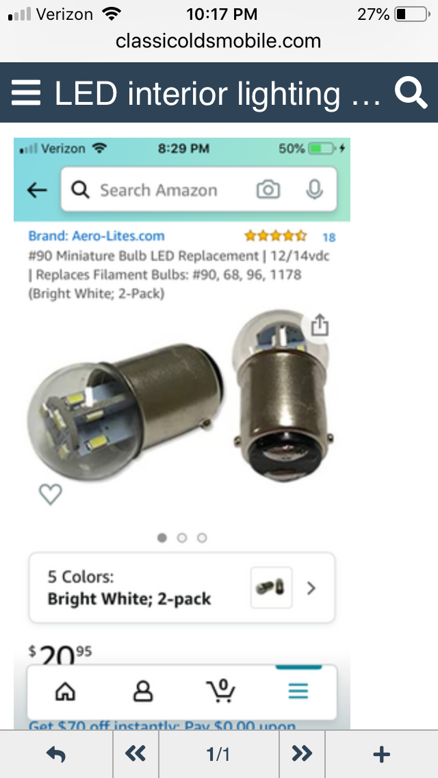

Originally Posted by oldsmobilejim
Ya 71 convertible rear quarter window interior lights get a little hot for me. Tried leds from campers, all are to tall for lenses. Any suggestions would be appreciated.
Did this a few months back, and if I remember correctly after much trial and error these LEDs did the trick for the rear interiors on my 71 vert.
