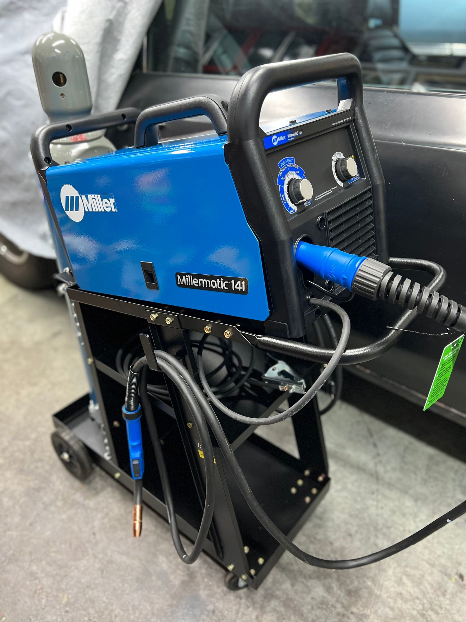

For years I have wanted to learn to weld.
But I've always pushed it off and found someone else to help. But after finding a few holes here and there on my 65 I decided to just do it.
Lotsa research and lotsa buying later...I made my first "weld" last night.
The wire, the gas, the regulator, the helmet, the ground, the distance, the speed...it's a LOT to figure out for a first timer.
But I'm really excited!
Lotsa practicing to do now! And lotsa video tutorials.
Any tips and tricks you learned that upped your game? Share 'em please!

You purchased one of the best machines made. Just pay attention to the videos and you will be running beads like a pro. Listen to the sound the arc makes, it should sound like frying bacon. And be sure to push the arc, not pull it.

That's a really nice set-up you have. Frying bacon is the best description. Inside the covers usually will show recommended wire speed and amps. Usually tilt the gun at a slight angle and slowly drag it back for starters. It shouldn't take to long to get a feel for it. Gas does not need to be excessive, a slight hiss. Keep your metals tight together, clean, and use similar thickness materials. I wish I recalled more been a decade for me. Top right and bottom right look best. Left edge too much wire speed. It will not stutter when you have the correct speed, just flow.

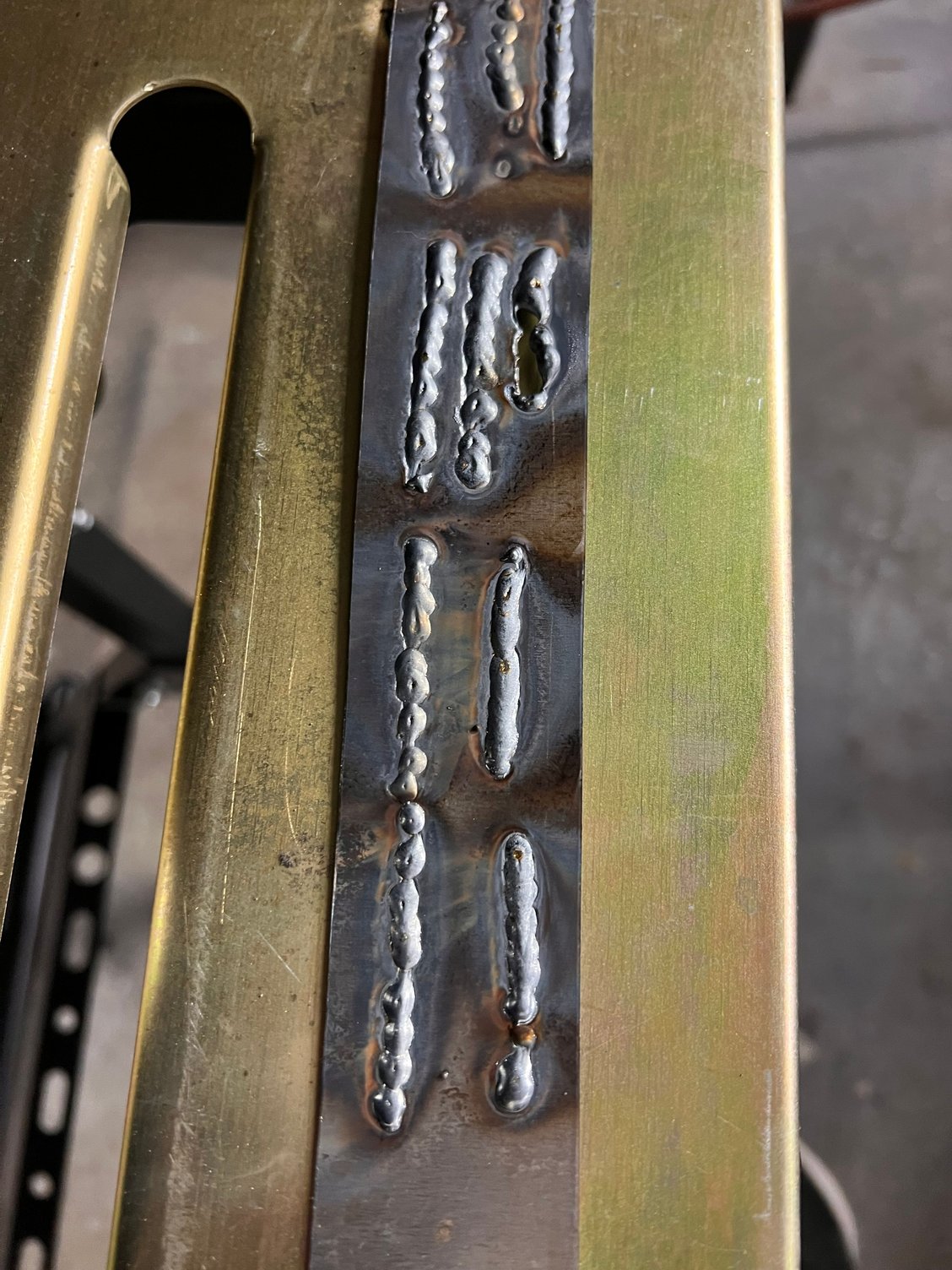

With sheet metal you wont be running any beads. Stitch weld your panels. Move around and have a sequence so you know where youve been.
Its really simple. The prep work is the key, just like body work. I bought a 211 and did the metal work on my coupe having never welded before.

^^^THIS. I found that the best way to minimize heat warpage on patch panels was to run the MIG a little hotter than recommended for the thickness and use really brief tacks. Of course, I also finally parked the MIG and got a TIG for that, which is MUCH better for sheet metal. I'll also add that with either, the panel fitup is key. There should be NO gaps. Those stupid panel clamps that leave a small gap are trash. Any gap is an invitation to burn through, plus you need to add more heat (and thus warpage) to fill the gap.

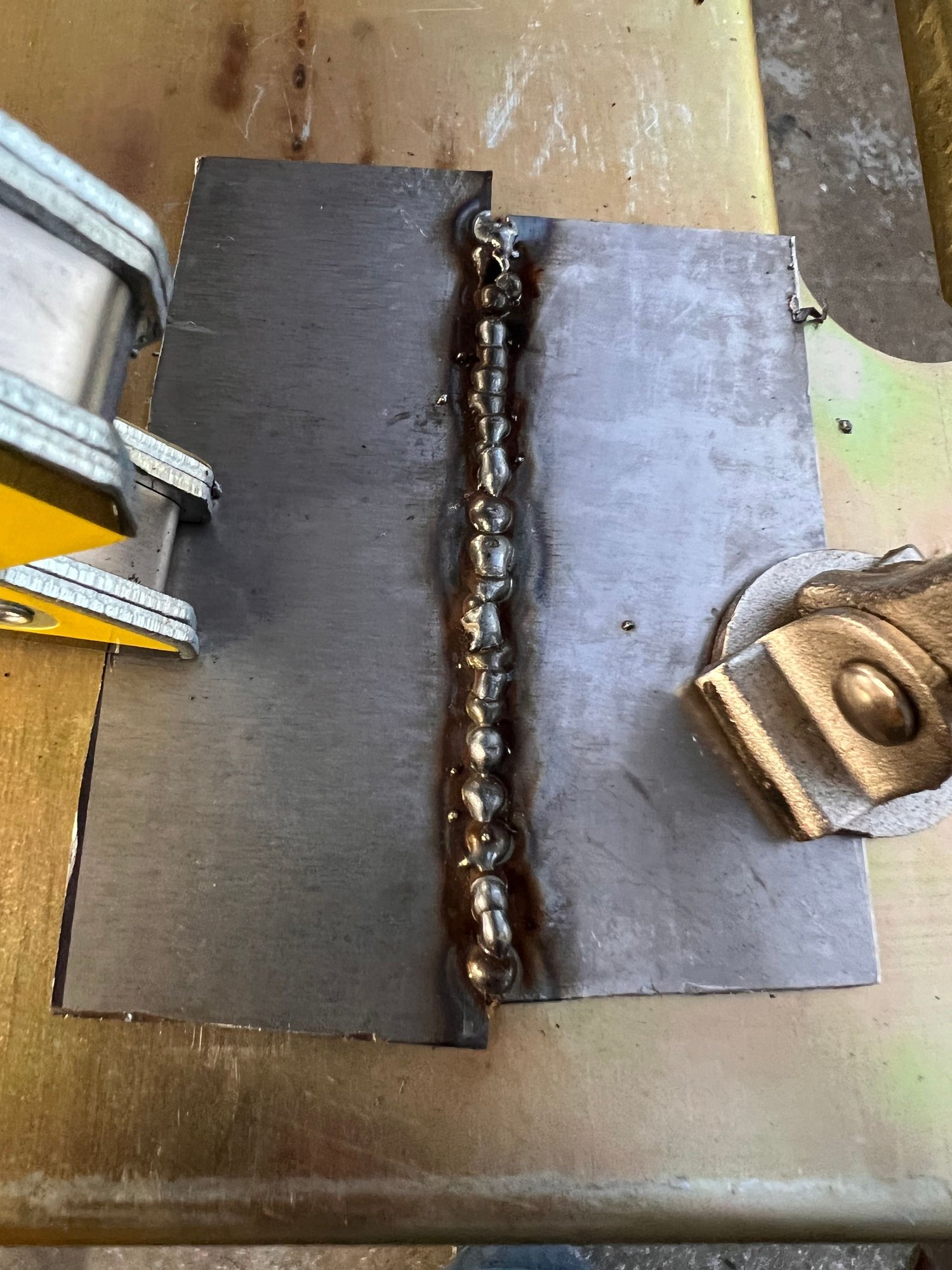

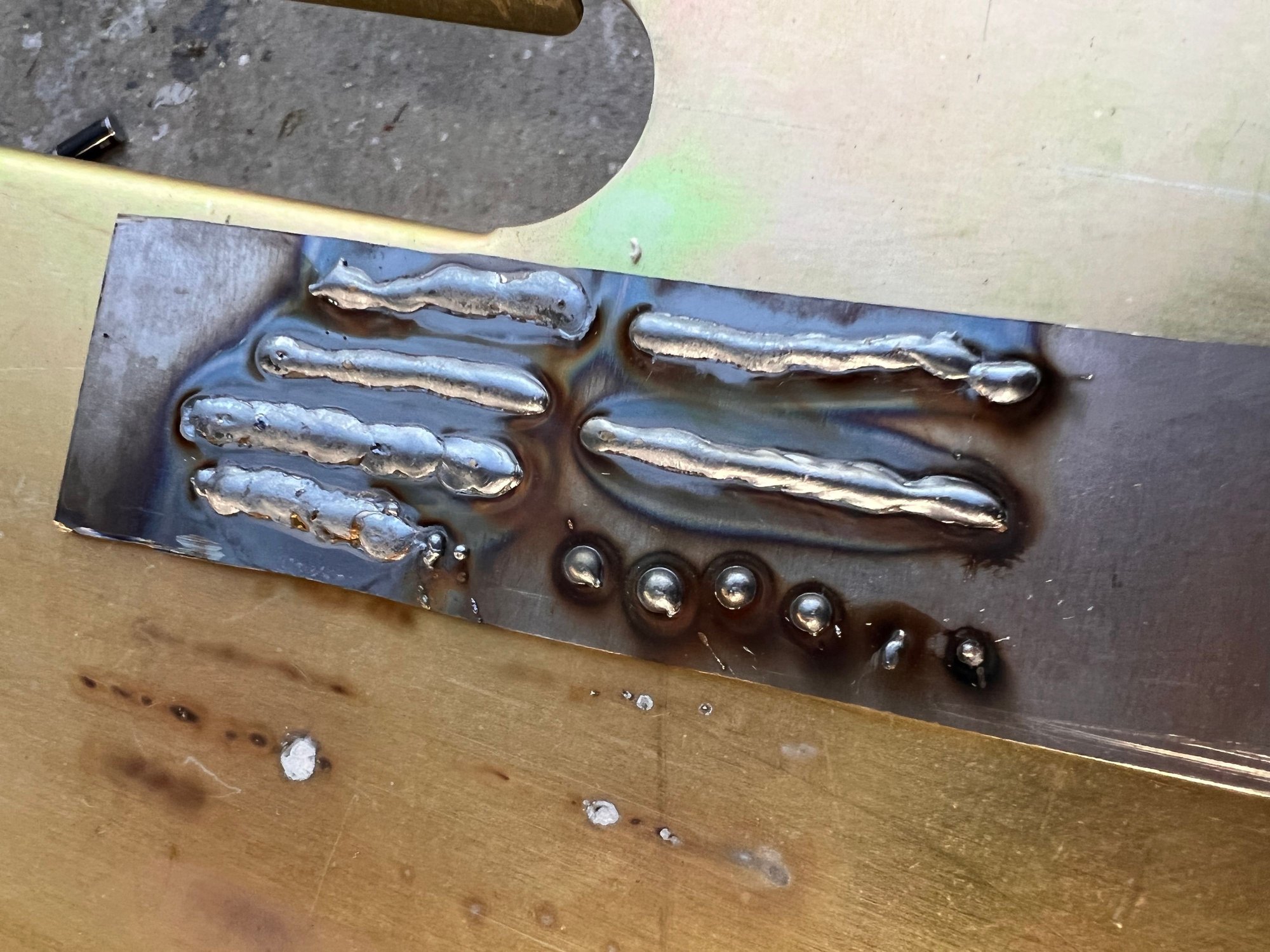

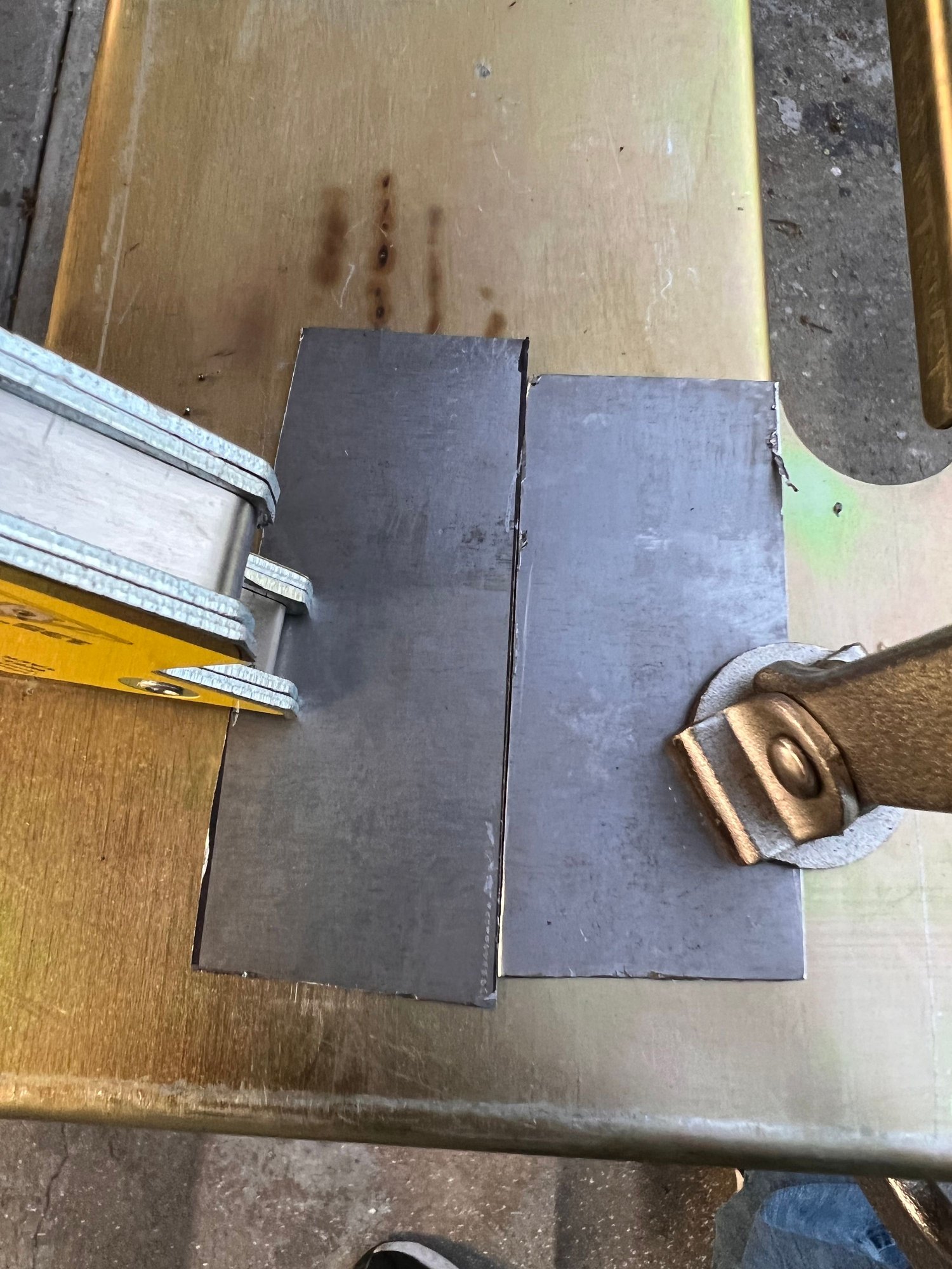

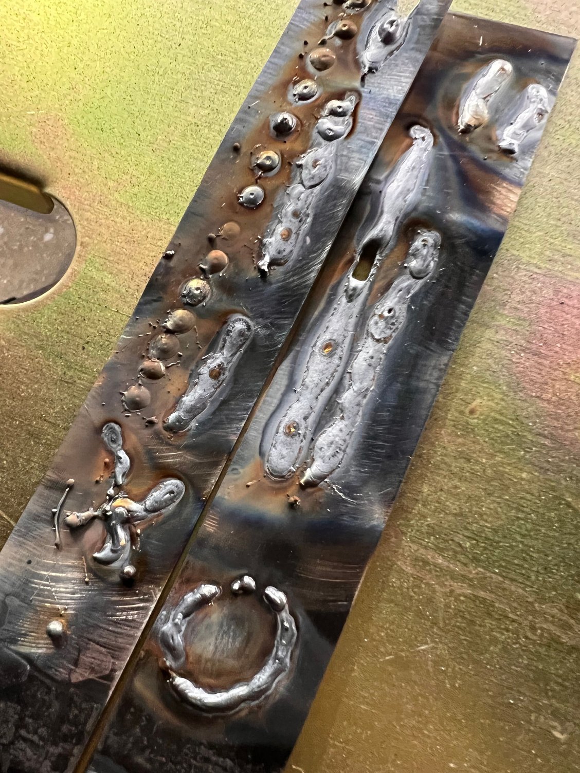

Here's my practice for the night.
I tried my hand at butt welding. Tacked the piece along the seem and then used a grinder to smooth it out.
A little porosity in the finished product but not bad.
And then a few more lines. I'm getting a little better already.

So when you weld. Take a breath. Slow it. Watch the heat that you are working with. Practice little circles. Allow yourself to burn thru here and there as you practice. When welding things like body panels it is very important to not overheat. Thin metal will warp and you are screwed. Testing yourself on all types of metal is very important. I used to use the same motions on a welder as I did my airbrush. Feel the metal. Let yourself learn mistakes. You got this

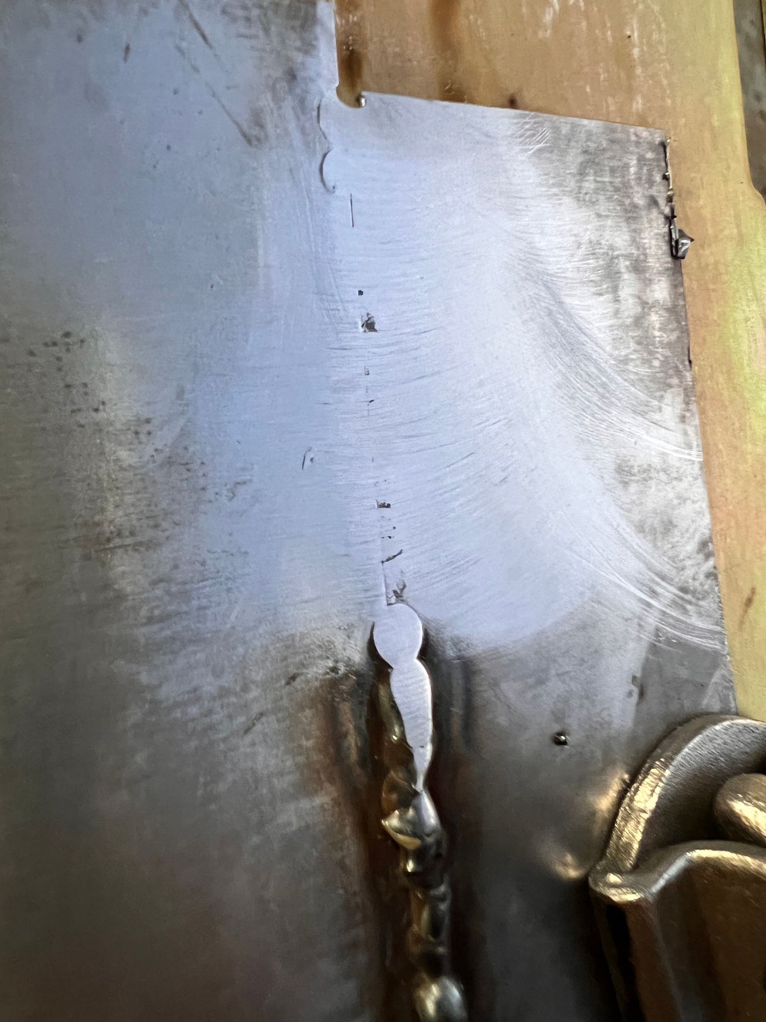

Oh I've burned through too! (evidence in picture)
I've been letting myself make mistakes just to see what the metal can handle.
-peter

Follow thru on your welds. Don't stop. Keep the flow. Keep moving. Think small circles. Bruce Lee would teach you on the follow thru. Where your impact is follow thru beyond that. Welding. Painting. It is flow.

x2.. body sheetmetal you will not run a bead, a series of spot welds that will eventually fill in..now a tig is a different story and a different learning curve

And yes…I’ve got 8” of .023 loaded and I’m stitching like a bastard!
