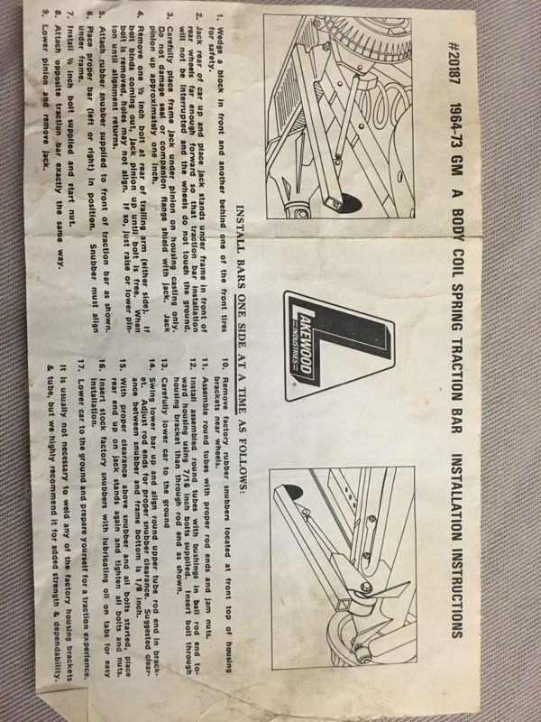

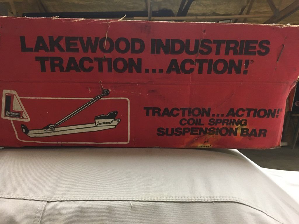

Ladder bars
I have a set of NOS traction bars if anyone is interested? PM for any questions.

Ladder bars and GM 4 links are an either/or decision, but not both for all the reasons listed.
Those Lakewoods look like heavy travel limiters.

The Lakewood bars shown above are slapper bars, not ladder bars. They really just limit suspension travel if the axle starts to wrap up. Bars of this style are somewhat effective on leaf spring cars. I've never really understood what they were supposed to do on a GM four bar rear suspension.

properly set up, slapper bars work great on a leaf spring car. As I mentioned earlier, they need to be long enough for the snubber to apply force to the leaf spring mounting eye, that applies the axle rotational force to the body of the car, forcing the fire into the ground. If not, the force of the axle rotation tends to force the leaf spring into a S shape, until the tire breaks traction then all the force from the springs straightening out causes the wheel the hop, and the cycle repeats.
Cal trac bars take the advantages of slapper bars one step further.
Slapper bars need to be made for the application in question. They also require some adjustment and trial and error testing to get them to work. Just bolting them on and hoping for the best won’t cut it.

^^^^ I had a set on 70 Chevelle. Broke the frame where front eyelets of ladder bar mount. So not worth it. Now Lakewood did make slapper bars for 4 link coil over cars. They worked well, but car was running bottom 12's it started bending the passenger slapper bar.
