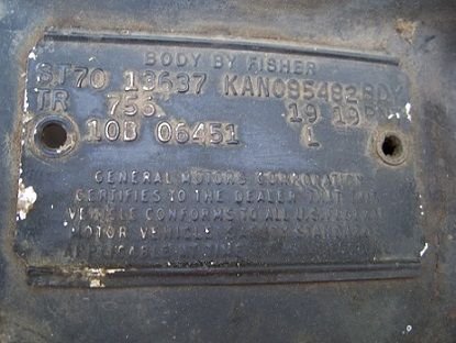

When I bought my car the cowl tag was dented pretty badly & was only attached by one rivet. I removed it, straightened it out, & would like to reinstall it. I know I could poke a hole in the center of the rivet to get it to compress but that's obviously not the way they were installed originally. The hood is on the car now which makes access a little difficult. I tried compressing the rivet with a set of long jaw vise grips for welding but it doesn't have enough pressure to compress the rivet.
What have you used to do this?
