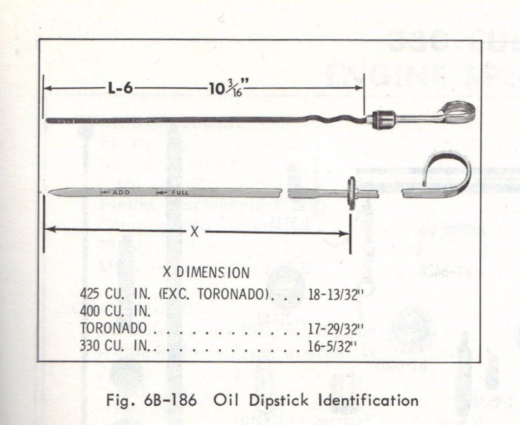

Maybe check the dipstick and tube as well.
Measure the dipstick length from the tip to the full mark and also to the top where it seals against the tube.
Measure the tube from the block to the top of the tube (assuming you can get in there to measure it).
This old post has the info for the stick. Just need to locate the indicator info.
https://classicoldsmobile.com/forums...uestion-34922/
Originally Posted by Jaybird
It's also different for 1967.
1967 Chassis Service Manual
Old Apr 23, 2020 | 01:29 PM
Posts: 15,411
I found the info below in Chris Witt's part number spreadsheet but there weren't any measurements for these sticks and tubes (indicators and guides in CSM-speak).
393974
INDICATOR, engine oil level [dipstick]
66-67 BB 400 425 exc. Toro, with Cruise Control
386319
66-67 BB 400 425 exc. Toro, w/o Cruise Control"
389375
GUIDE, engine oil level indicator Guide Tube
66-67 BB all 400 425 [Toro not listed separately]"

the pan looks like the one for sale, the part number on the stick does not match the ones in post #15 and the stick is 20 inches long. i guess that answers my question. wrong dip stick. Thanks guys i can sleep tonight. lol just got the car not long i put about 75 miles on it with 1.5 quarts extra. dont think i did any damage

The stick and tube lengths are matched as a set, so if you have one that doesn't match the other, the oil won't show at the correct level on the stick.
You can add the correct amount of oil and make a mark on the stick to show the "new" FULL level and then you don't have to worry about it in the future.

l posted the dip stick tube is 20" and stock was 18 13/16" so i have the wrong dip stick. btw i had my readers on.
