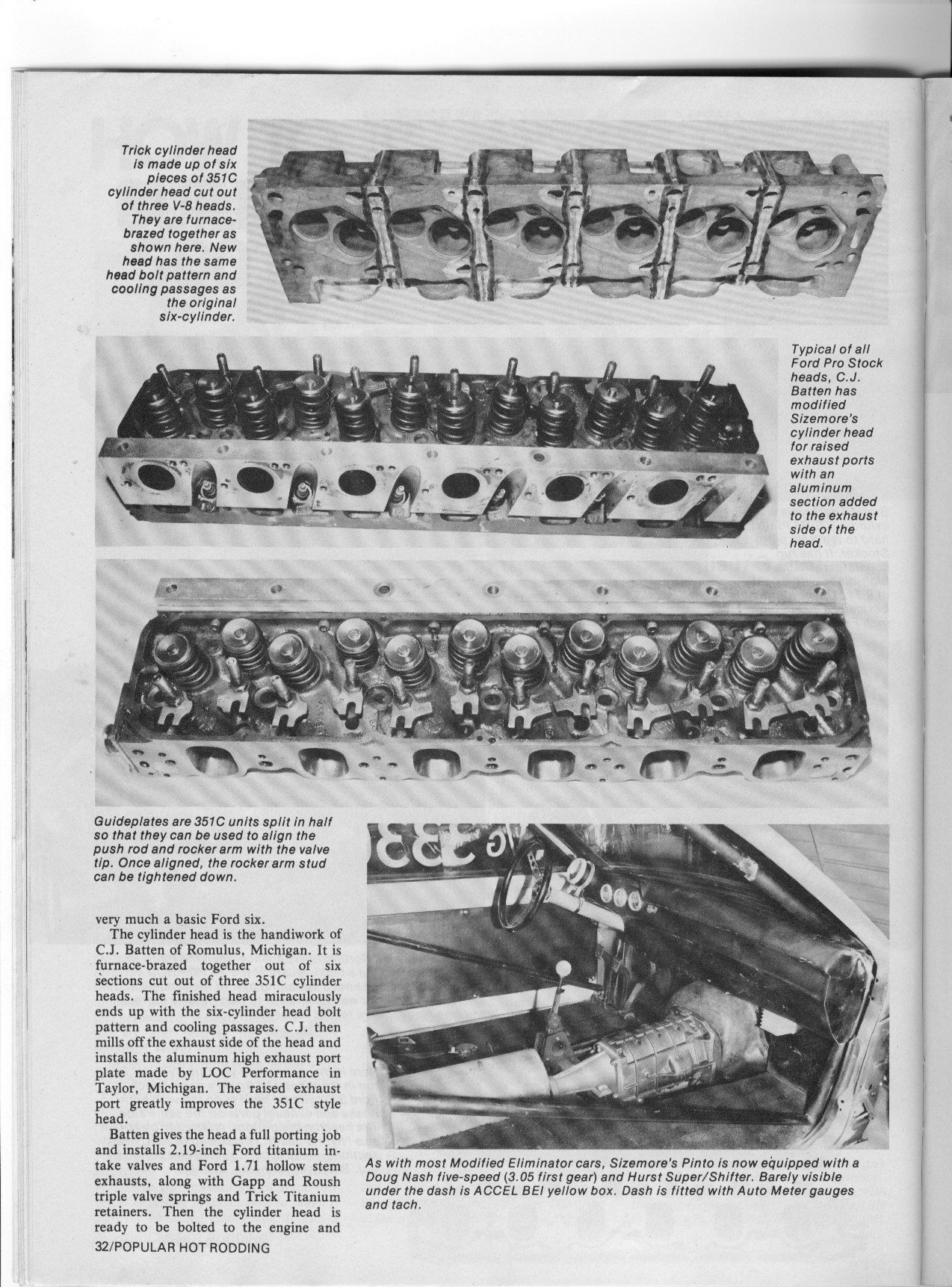

Actually, I've been wondering if it would be possible to convert one to gasoline and make an Olds V6 gas engine. The problem is that unlike the DX motors, you can't just bolt an Olds gasoline head onto it. You'd have to cut up and furnace braze a V8 head, which has been done before but it isn't easy. Then you'd need to fabricate an intake and cobble up a distributor or crank-fire ignition system. The block does have a distributor hole, however.
Think of the boost you could run. Build a GN killer Cutlass.
Just for grins, here's a similarly fabricated head for a Ford inline six made up of sections from 351C heads. Note that it was built by none other than C.J. Batten.
