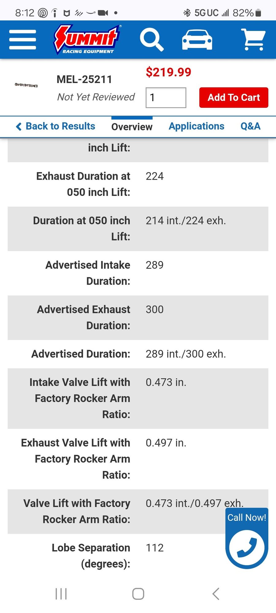

Before doing anything, remove the oil filter and cut it open. If it’s clean of debris, then you can continued with the diagnosis.
How much lift does the new cam have over the stock cam? If it’s considerably more, maybe the rocker is pivoting past the previously established wear marks? Did you change valve springs?
Some cams are just noisy, especially rowdy cams with aggressive ramps on the lobe. It sounds like your grind is fairly mild.
This is the cam I installed
Melling stage 2
Melling stage 2

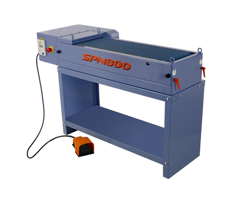

And on the head resurfacing, just so nobody thinks I am a complete idiot, I did not take a hand held belt sander and go to down on the head surface. My neighbor is old school and he has one of these that we used:
