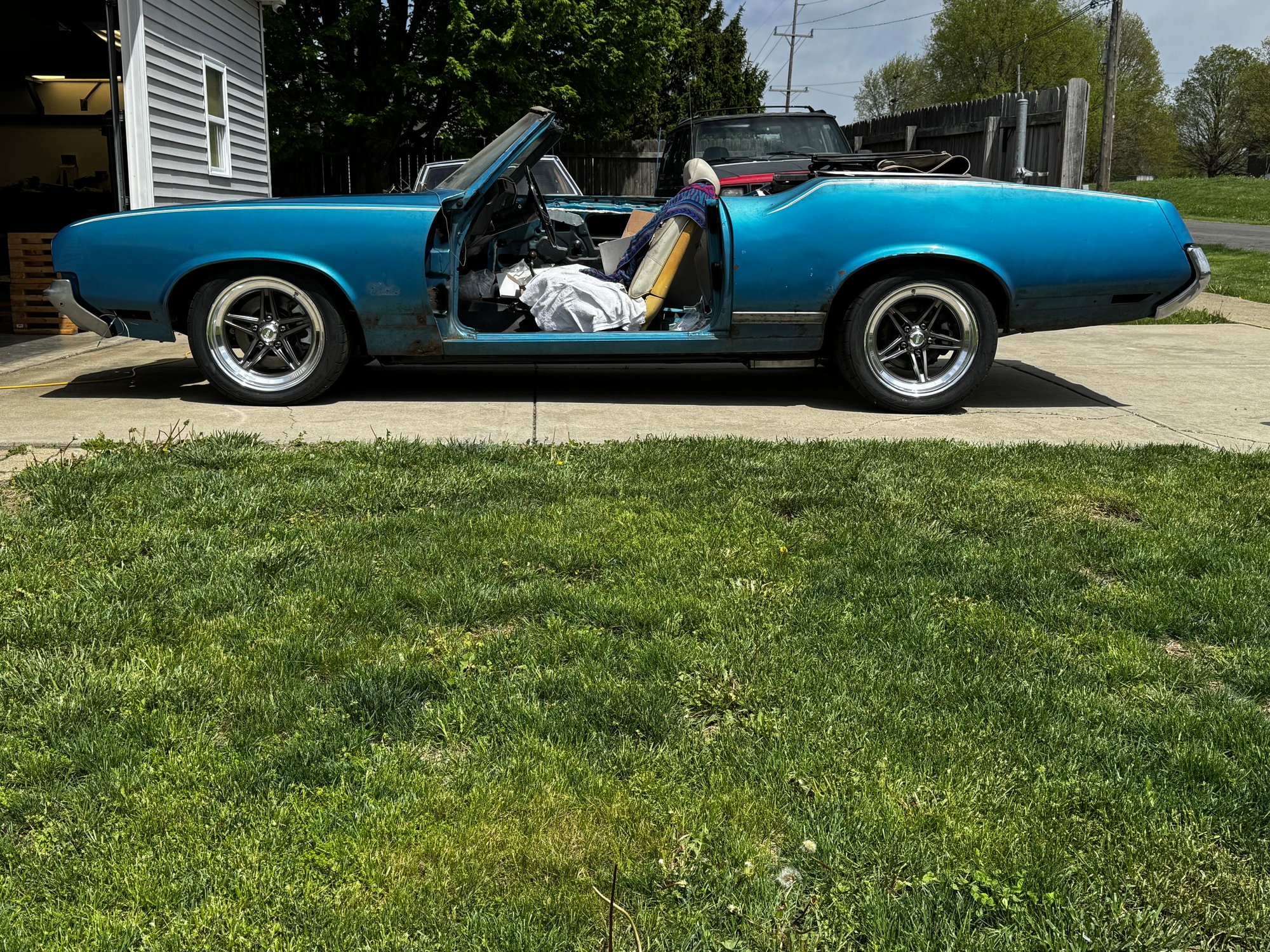

Please forgive the ls blaspheme, I know the drill, but I really need some opinions.
I am close to driving this and working any issues out before it gets bodywork and paint. I’m mostly looking for a finished value but as is value could be helpful. When I insure it about all that needs to be done is the interior, seat covers in progress from legendary, new top, body and paint. I’ll just add my copy paste list of things done. I’ll probably miss a few things. Axles tapped for 1/2” threaded studs

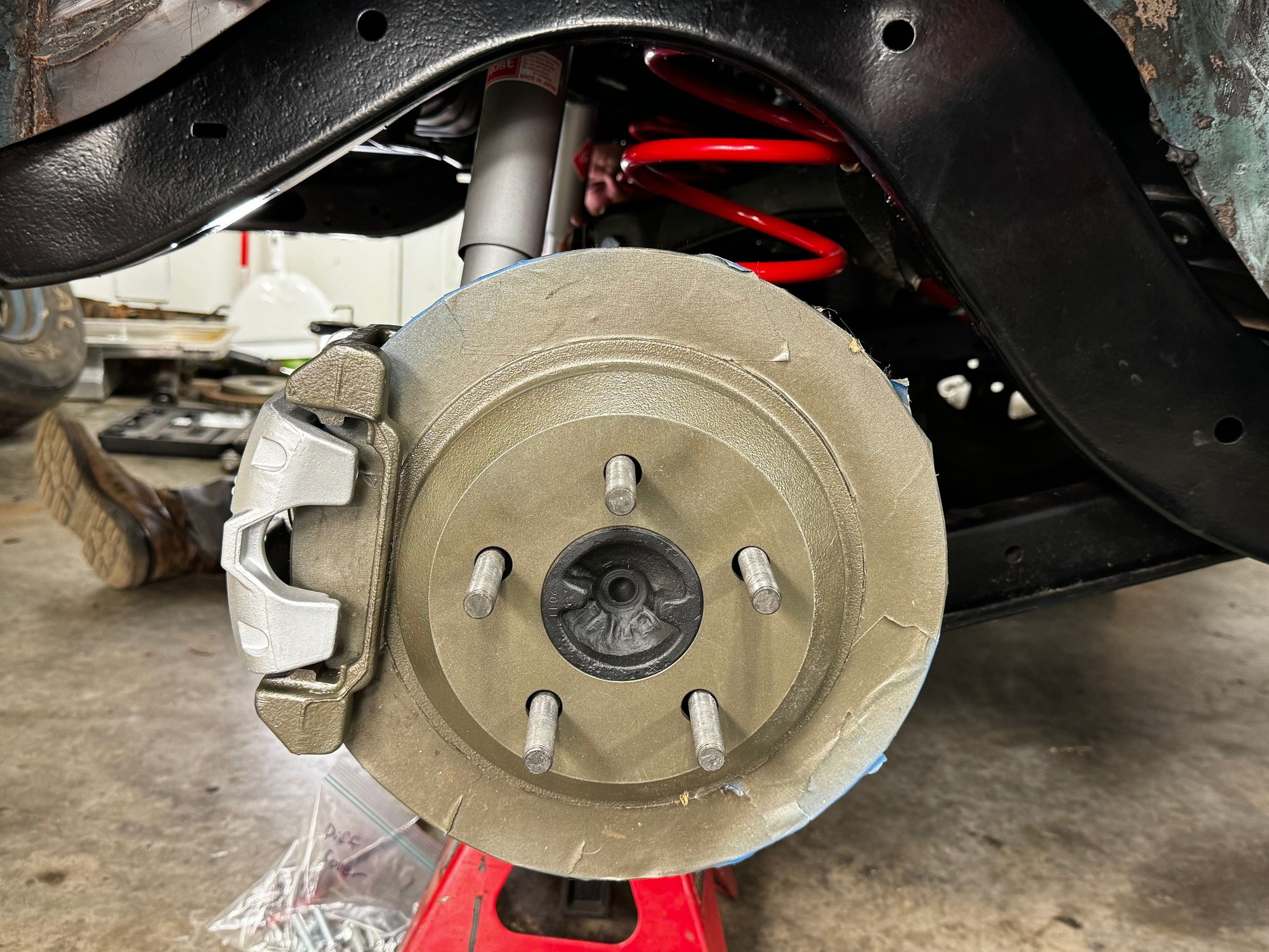

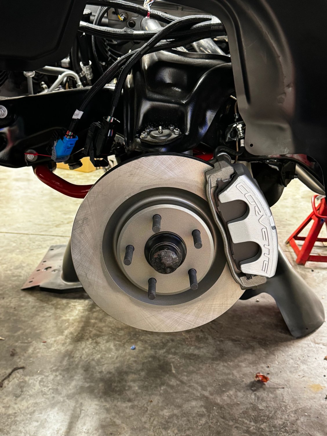

C6 corvette brakes
Front Kore3 brackets
Rear 2002 Camaro backing plates

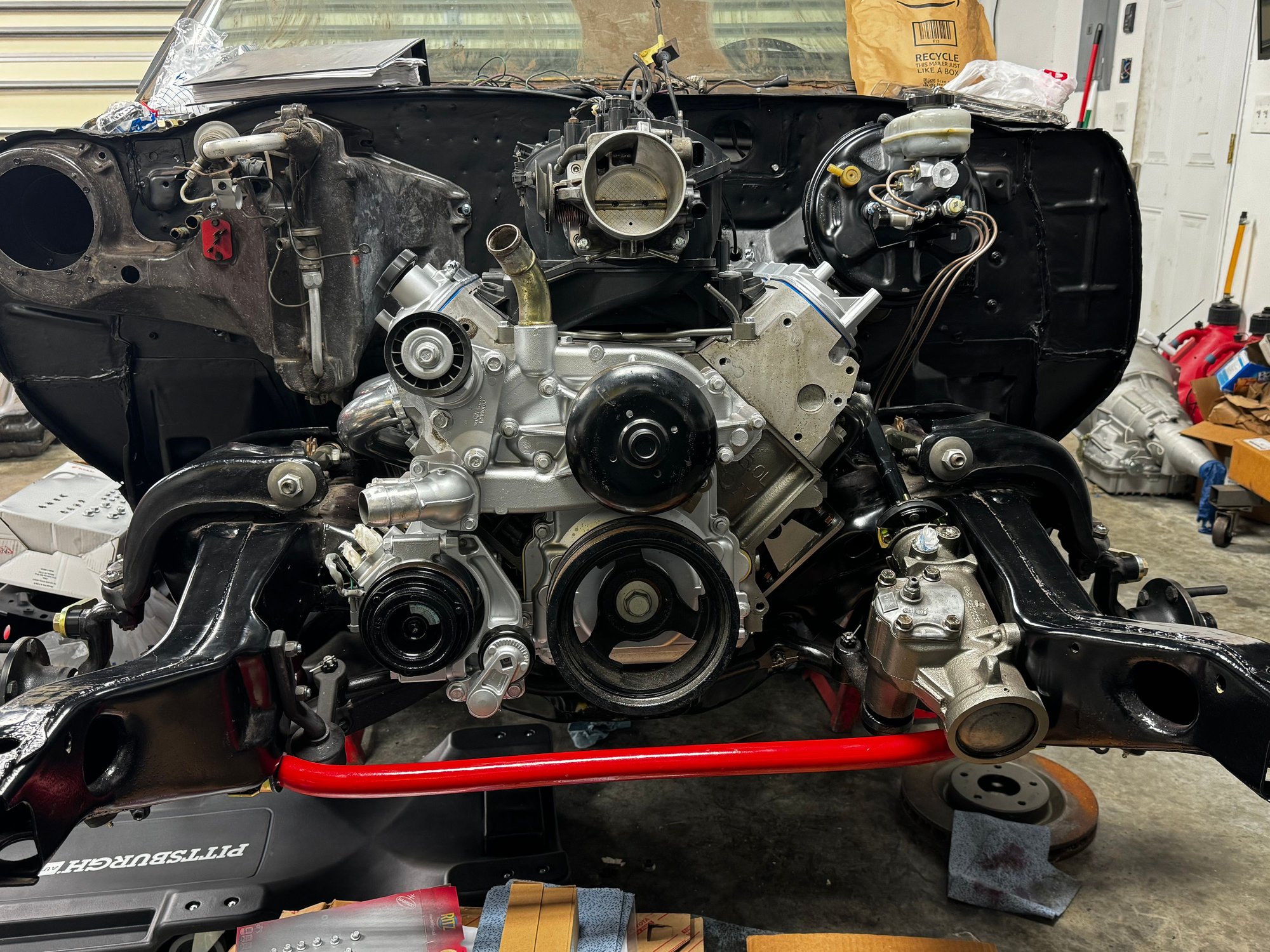

Jeep Grand Cherokee power steering box
Dorman power steering pulley from Pontiac G6

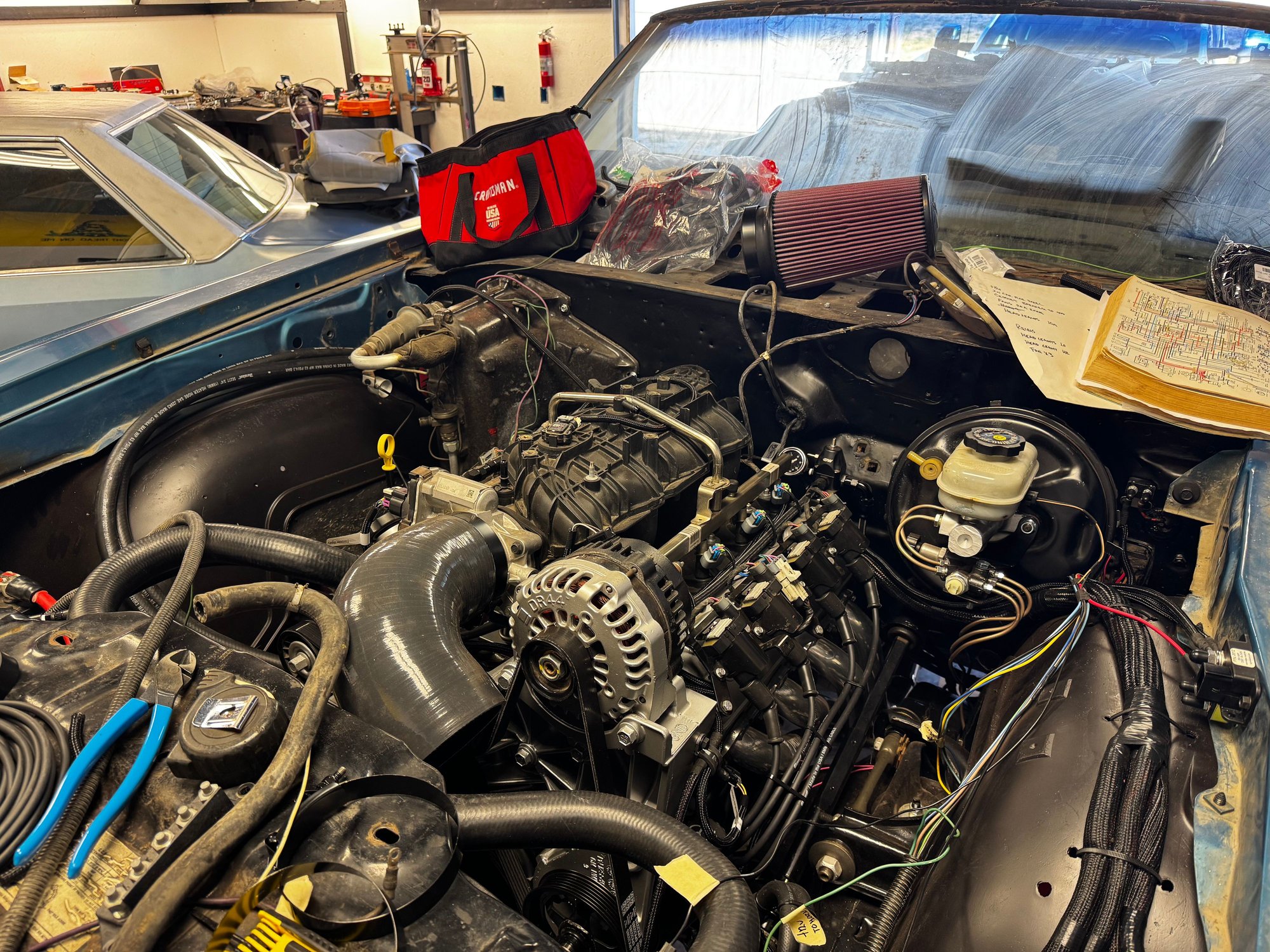

Engine is a 2010 Silverado 6.0 short block with TBSS intake, cam and truck accessories.
Ceramic coated headers
Dual exhaust with Spintech 3000 mufflers
Factory e38 ecu and t42 transmission controller
4L80 transmission rebuilt to handle 700hp
Circle-D 3200 torque converter
Tuned with HP Tuners for e85
BP Automotive engine harness

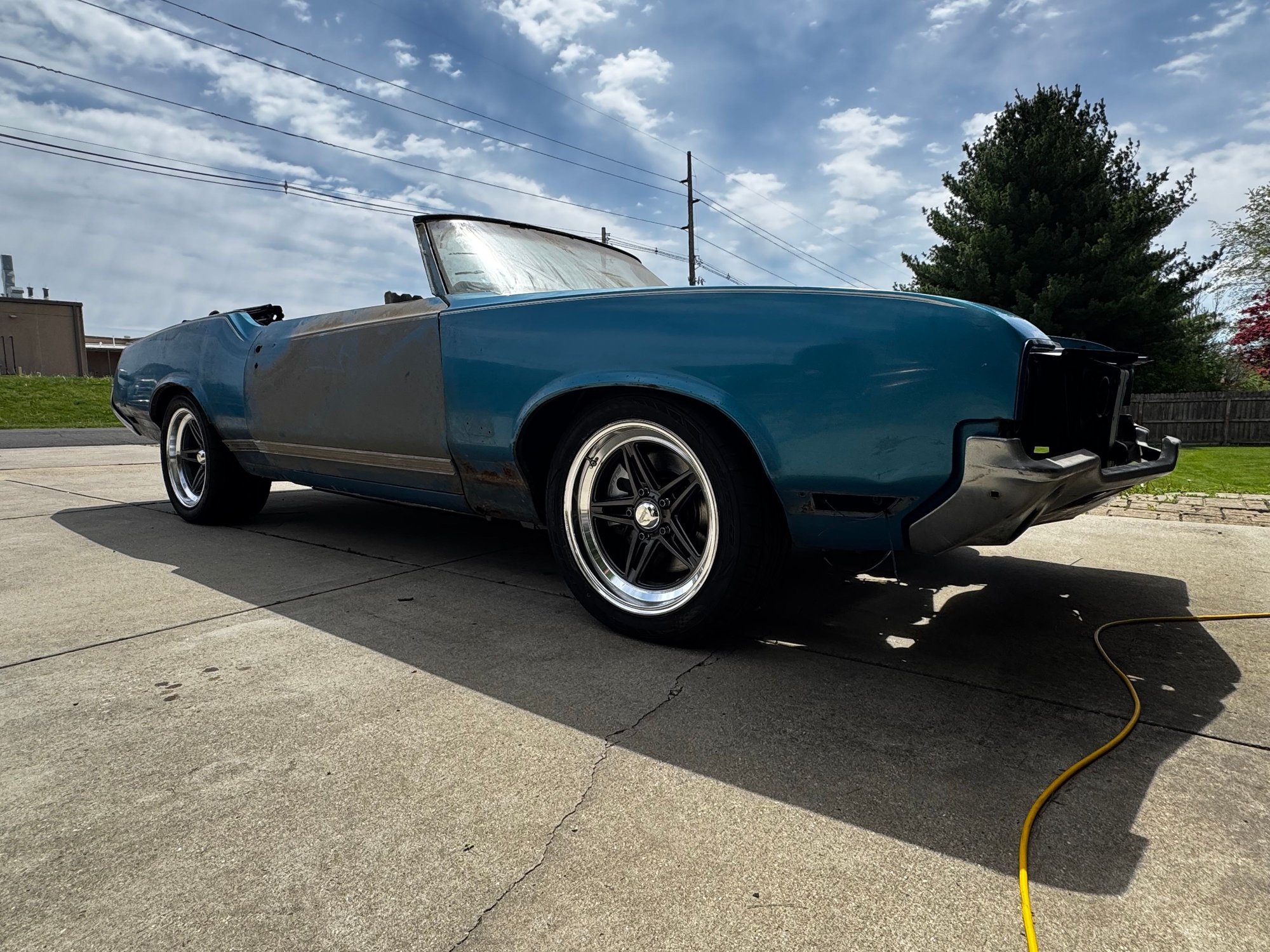

Nothing wrong with the LS swap, it was a plain-Jane Cutlass, big deal. Not like you put a wing on it! That is going to be a sharp car when you get it finished and I think those wheels look awesome on there, too. As far as insurance, I would say to get several comps for a convertible Cutlass then start adding retail prices for all of the parts and factor in your labor as well. I would think you would want it to be fully replaced in case of a total loss.

thank you! No wing for this car lol. I do have an oai hood tho.
I couldn’t decide what wheels I wanted. My son saw these on summit and I really liked them. Not to modern, no to old school. I wanted something fairly open. The rear tires are 295 and I could definitely go wider, but I played it safe. I would not have changed the engine if it was a rare car for sure. It was more work and money than I thought. I’ve got a lot more money in the swap than in the motor. 🤷‍♂️
