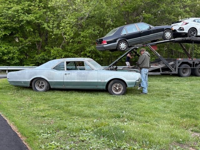

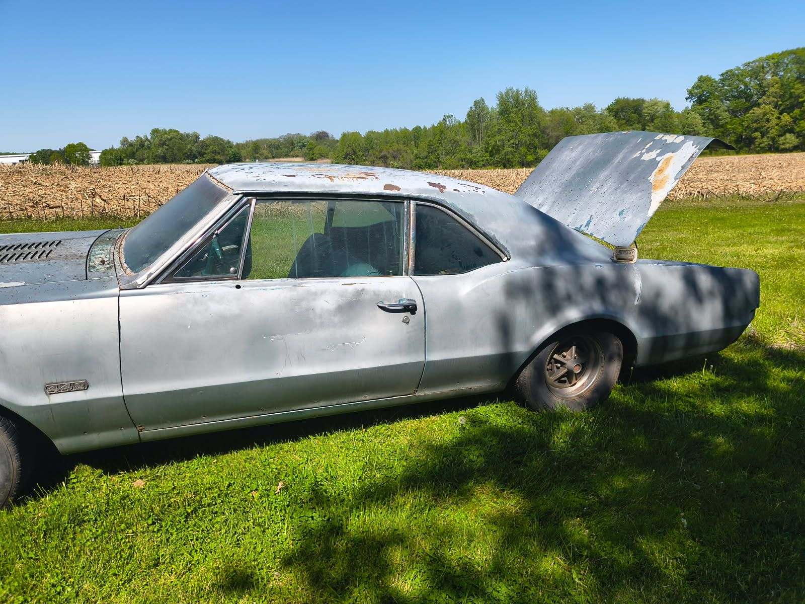

Another project car on the way, really dont know what I bought...yet! Car is coming from Colorado to NJ. Its a 67 post 442, 4spd bench seat car with Rally Pack dash. The 400 is gone, now a 350. Its a non running car 5V, 2L K-K paint. When it gets here will assess and report what find. Seller said it was his wife's father's car and has been sitting many years. Was tough to get any real answers about it as the seller not a real Olds guy or car guy. I know the resto will be costly with the aqua sport interior (Not Reproduced) but i just couldnt resist this one!

Here are a few more pictures, the ones that should scare a sane person away...
Old May 2, 2026 | 05:49 AM
Andy's Avatar
Joined: Jan 2020
Posts: 2,875
From: Sarasota Florida
Damn, she’s cherry!! Whats wrong with us guys, we see an old 442 sittin by the shed and damn .. we just got to have it!! Yea, i got that same disease 😎

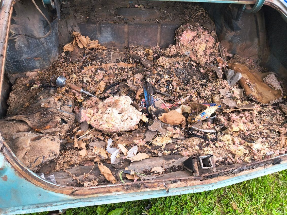

Turd take 2, arrived last night. I want to know if there is a market for rodent feces as there is plenty of it in the trunk, bigger turds like opossum or racoon maybe? Was late so will post picts. Car sold new in Ft Wayne Indiana in April of 67 says protecto plate.
Old May 4, 2026 | 11:06 AM
acavagnaro's Avatar
Joined: Aug 2014
Posts: 831
From: Western North Carolina
The car doesn't look bad at all. From all the pictures you posted, it looks to be mostly in-tact and rust free. The trunk photo looked a little scary and if it's covered in crap, you'll have your work cut out for you back there.

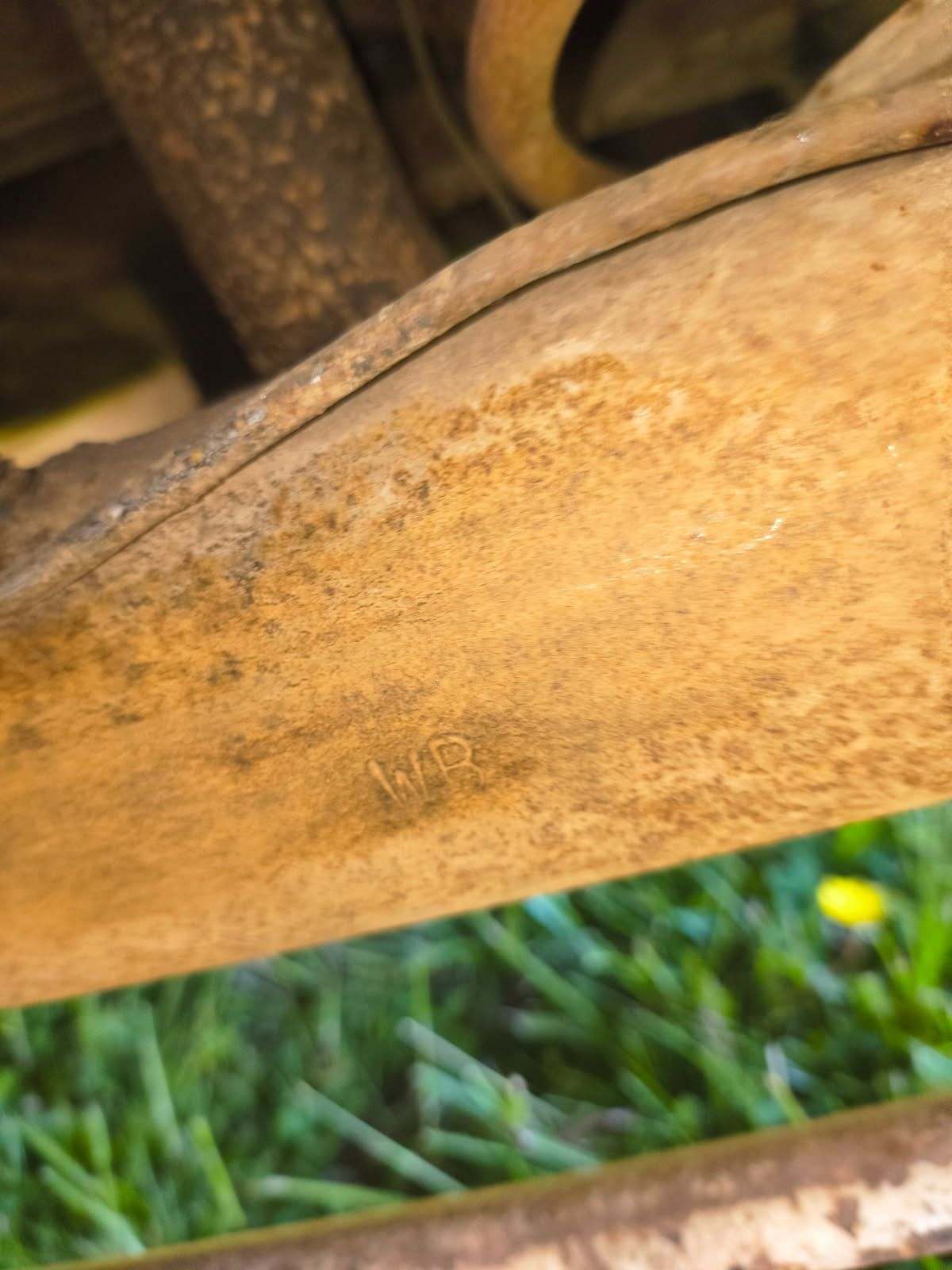

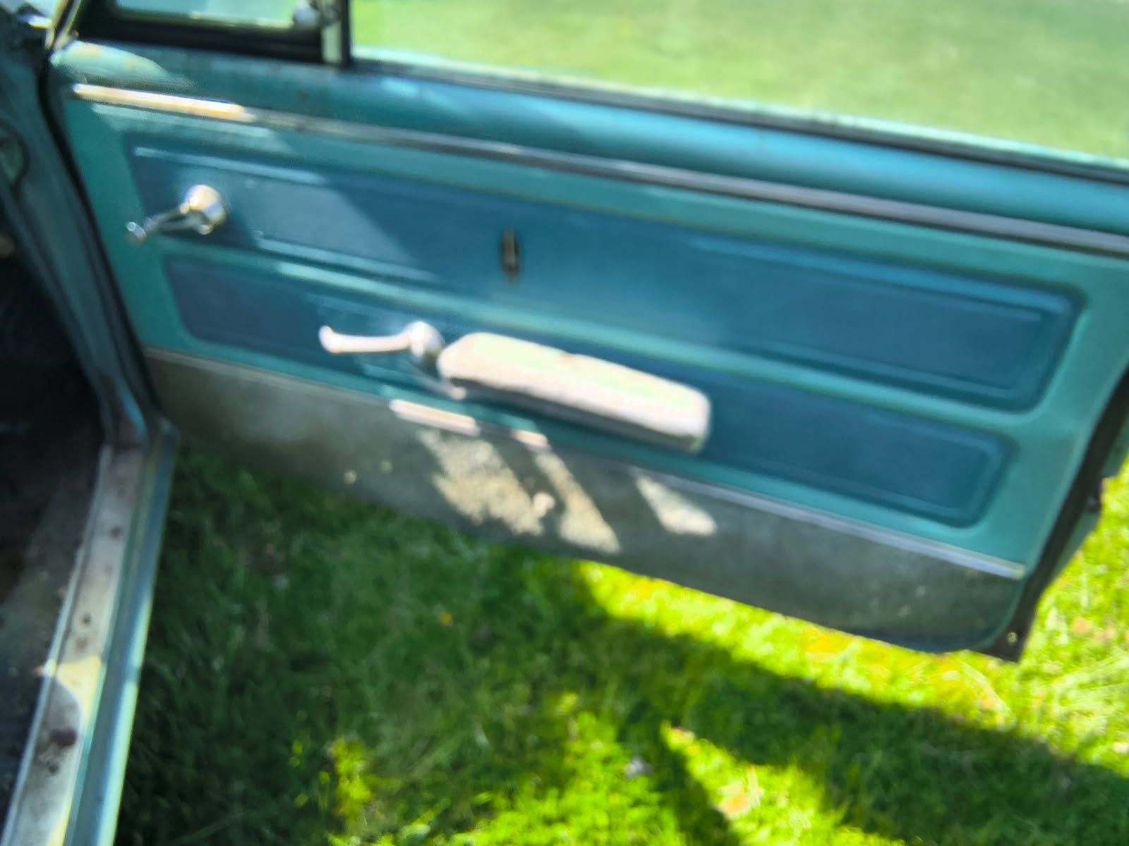

Looked the car over today and there are a few disappointments... The trans turns out to be a Saginaw 4spd, shifter though is nice and original 442. The rear has a code MB a P type 10 bolt cover which seems to be an open highway gear. Gas has varnished in the tank. Front floor pans are needed and possibly the trunk floor also. The 350 has #5 heads so its probably a 1968 unit, it is not seized and has normal looking oil on the dipstick. Hood lip shows no underside rot, 442 grill, headlight tins, front bumper, and core support are nice. Most side moldings are with the car and cleaned up well. In my 67 parts stash I have most things to make this car nice and correct! I still love it.

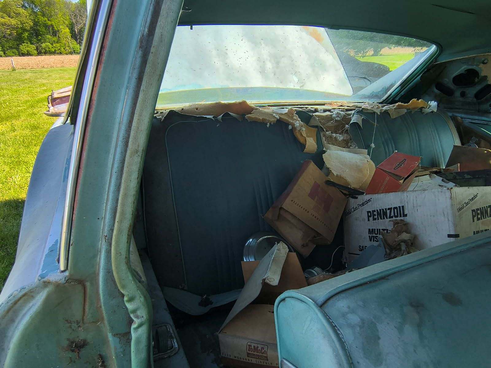

A few more picts.
Old May 5, 2026 | 03:41 AM
TRFREE's Avatar
Joined: Mar 2015
Posts: 274
From: Tuscaloosa, Al.
Great photos, looking forward to following the progress.

Moderator please move this thread to the Major Project Forum since now the 442 is being restored. Had today to to de-turd the car more cleaning is needed. So far a 5 gallon bucket full has been removed. Seller said there were pack rats living in the vehicle. I asked how old the feces were and he said about 20 years. With Hanta making the news I was concerned so I suited up with a hazmat suit and n95 mask. With a clear view of the trunk floor I see rot so new metal will be needed.
Old Yesterday | 02:08 PM
jensenracing77's Avatar
Posts: 11,858
From: Brazil Indiana
It really don't look that bad. Will be following along
Old Today | 09:40 AM
acavagnaro's Avatar
Joined: Aug 2014
Posts: 831
I agree. Amazing how good the trunk pan looks considering what was stewing on it for 20 years.
