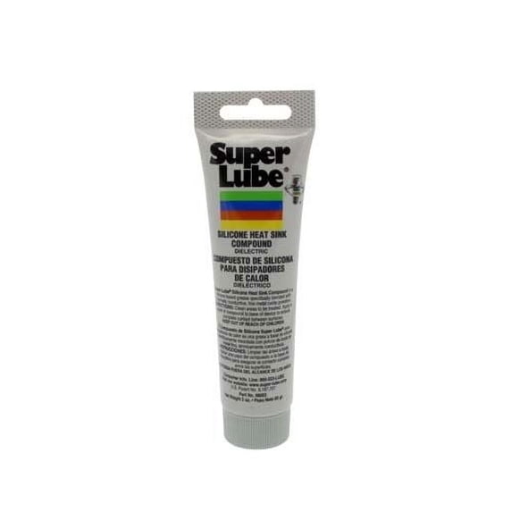

No, you want heatsink compound. The last time I bought it was at Home Depot.
Something like this:
Super Lube Silicone Heat Sink Compound

OK thanks. I told the Napa guy, I don't think that is the right stuff, and he said it was, and it does not actually say anything on it about using for modules. Now I have to change it. I did not drive the car much, just made sure it started. I'm surprised the new one did not come with it, is a Delco.
