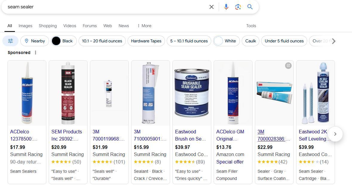

I'm looking for information regarding two different kinds of goop. First I'd like to know what GM used to fill holes and gaps in the body. The 50+ year old stuff the looks like gobs of tar that has hardened to a brittle glob that flakes off. Next I'm looking for a sealer to use between the firewall and the AC evaporator case. I want to use non adhesive silicone so I don't destroy the plastic evaporator case if I ever have to remove it. That stuff they use on boats is stronger than the firewall steel and is almost impossible to remove once it sticks.

Is the first stuff the white seam sealer?

It's called "Seam Sealer" - Google search it. Decide if you want white, black, paint-able, brush-able, caulk tube. Personally I'd go with the 3M brand.

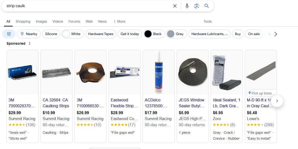

For the AC box I have used "Strip caulk" and it worked quite well. Others may use something else.

I've used the 3M strip caulk on the AC box before. It works well. It comes in a roll of adhesive foam strip with a pull away backing. It's not so adhesive that it permanently sticks to the box and would damage it during removal.

There are much improved seam sealer products today. I like the two part seam sealers.

Go with the 3M strip calk as already suggested above. Relatively low cost, easy to use, no real mess and you'll be able to remove the box easily in the future should the need arise. You can use the same product to seal the two halves of the evaporator case together as well.....there's a channel molded into the box halves where they meet (as well as where the box halves contact the firewall).....that's where the factory placed the calk. Might need to use at least two rows of the strip calk for sealing to the firewall.
As far as the "aluminum tubes" you mention (one large one up top that wraps around to the POA valve and a smaller tube down below)....the factory used a different style/type of material there. Some call it "evaporator bulb insulation". Should be available locally. I have a large roll of the stuff....don't know if it's sold in smaller sections or not. It's a flat ribbon product about 1.5" wide and fairly thin. Has the "calk" part but also seems to have some other material mixed in w/the calk (maybe to add "insulation"???...who knows) that gives it a different appearance VS. strip calk.
The 3M strip calk product is PN 08578 (black). Not sure what someone said about "foam" above....the strip calk comes in a box of many strips (about 12" long) that you just pull away from the wax paper dividers inside the box. One box is PLENTY.....you'll have A LOT left over.

Would this stuff help? I have found it invaluable for all sorts of things.

That is likely the same thing as the 3M strip calk discussed above...should work fine.
