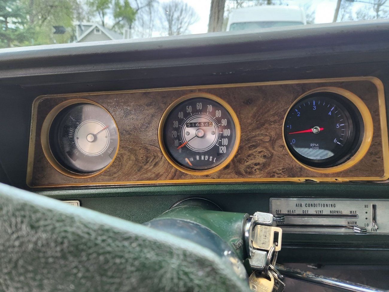

Spent some time yesterday investigating gauges. Just wondering if anyone has installed Dakota Digital VHX gauges and what your opinions of them are. Look up aftermarket gauges for a 68 Cutlass and that's what pops up endlessly.
I like the VHX package but am not sure I love it. Problem is with Olds is it's three 4.5" openings in the dash that have what look like 3 3/8" instruments in them. That means a bezel that sets them back a bit too much and limits visibility and I can barely see that tik-tok-tach. I intend to change the steering wheel to help with that but it won't really fix anything. I can't help but wonder if for a good chunk of $$ and effort if the DD will be better lit but equally buried. As a side note DD requires the use of their oil pressure, coolant temp and speed sensors. Easily swapped but there are functional single wire OEM gauges in use and maybe a different gauge wouldn't be a bad idea to look at ?

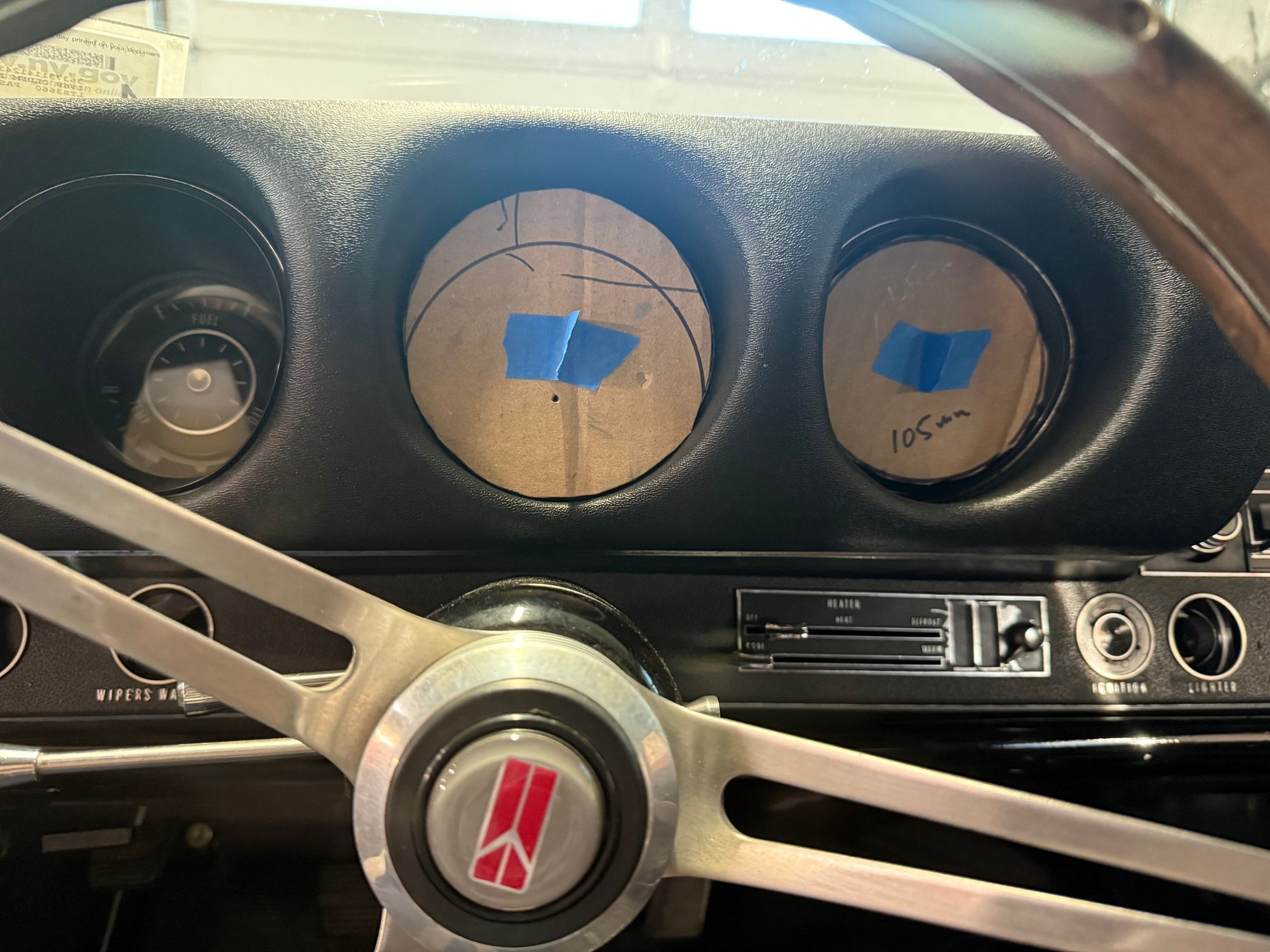

Debating 4" versus 4.5". In this case 114mm vs 105mm to account for the trim ring.
Right now I think the smaller of the two, it'll be set back a bit but not as much as OEM and it's still a bigger gauge. I'll have to go maybe pull one of the existing gauges to see what I have to work with in terms of mounting, I might have to modify those bezels.

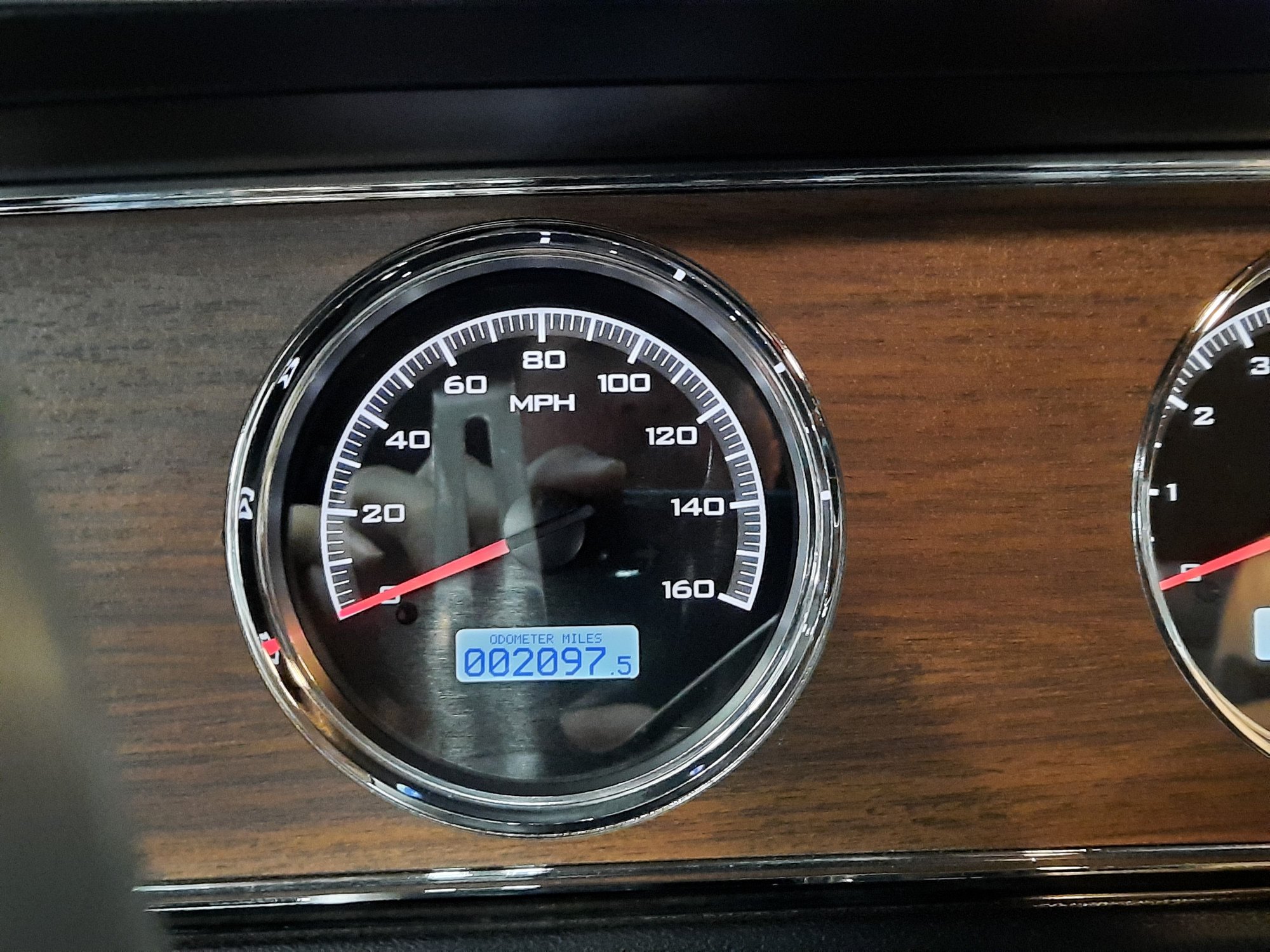

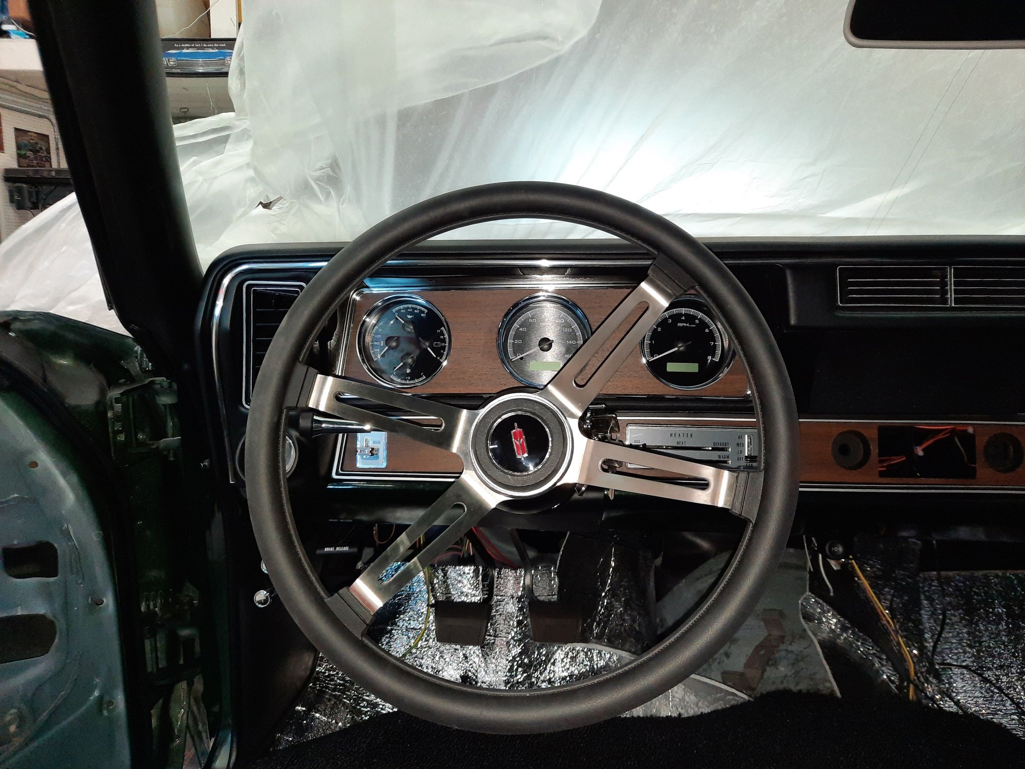

I went with the Dakota Digital VHX when I did my restoration and love the cluster gages.
