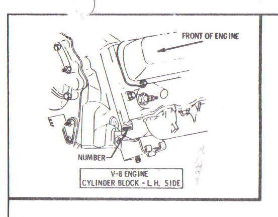

Old Apr 13, 2020 | 03:39 PM
Posts: 50,806

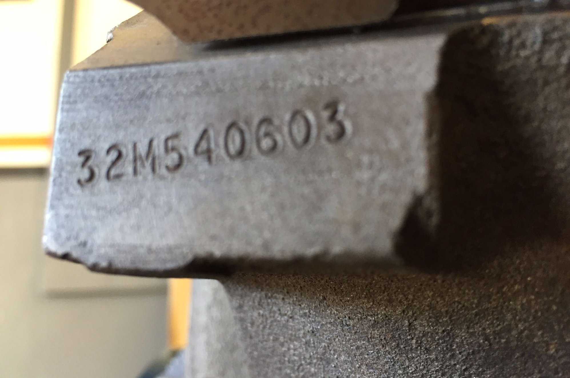

33M326551 is the # , does this tell the year of the block?
thanks, Steve
Old Apr 14, 2020 | 08:26 AM
Posts: 50,806
thanks, Steve
The second character is the model year. 3 = 1973. The G heads were not born on that block.
