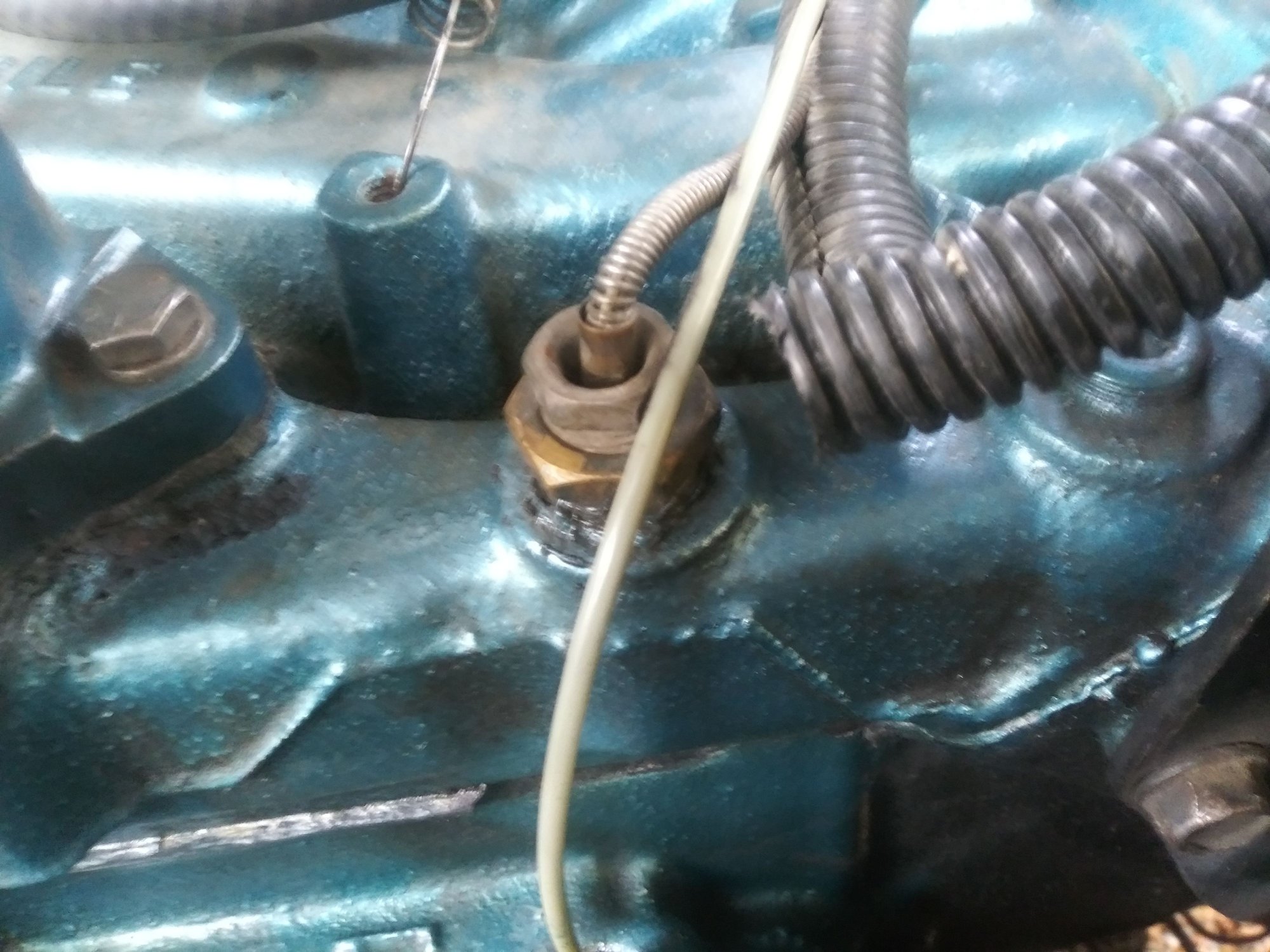

It seals the lifter galley…You don’t have ANY oil leaking out?
Thats bizarre if you don’t. Are you sure it popped out?
This is what it looks like under your intake manifold.
-peter
I'm pretty sure It's the gasket and not RRV. This picture helps. I didn't see any out leaking from the gap and down the front of the block,but there was a bit of oil at the base of the connection for the oil pressure gauge and around the block I'd number which is close. I tightened the connection nut and cleaned the area up after spraying the soapy water. I'll take it for a drive an see if oil is coming from the gap.

Pic of what it looks like before the drive
