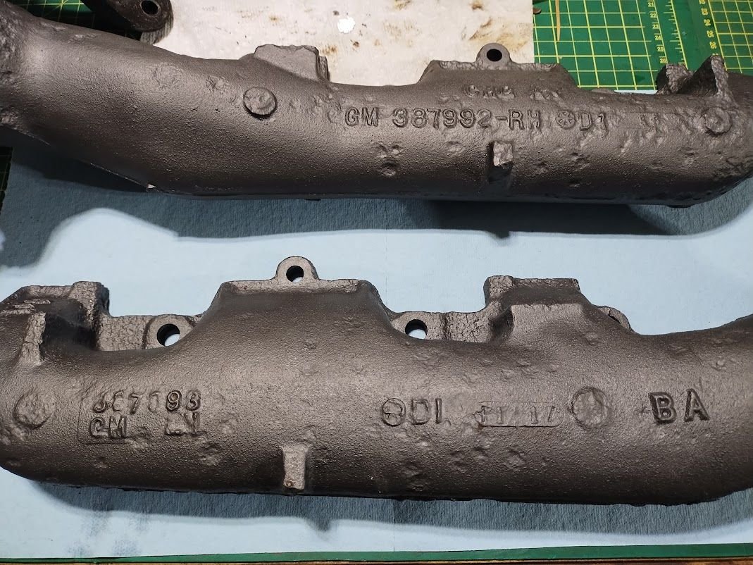

Good day all,
What's everyone's thoughts with the deterioration on my '66 Toronado's exhaust manifolds? Overall it looks to me that they're in pretty poor condition but I find this strange because the car was really well looked after over the years. My Dad has owned it since 1973 and he stored it indoors every winter. 81k on the odometer, never abused. Everything under the hood is in really good condition, however the manifolds have got some really bad pitting all over them. Check out my pics below.
Is this just a case of bad casting or could something else cause this? About the only thing I can think of is that the valve covers were leaking oil for several years......perhaps the oil leaking down and burning on the manifolds contributed to the damage? Much of the damage is in these little round dots of pitting, kinda strange no? I'm not sure what causes these things to go so bad.

Salt water and heat causes this.

I'd say those exhaust manifolds are in decent condition. The only reason you might want to replace them is if you're doing a concours restoration on your car.
I know you can get recast W/Z manifolds from Thornton.Toronado exhaust manifolds would probably have to come from a parts car.
You can have those manifolds bead blasted, then regularly treat them with Calyx exhaust manifold dressing.

I live in NYS STATE, the salt belt capitol of the world. Every 5 to 6 yr old manifold looks just like this if not worse. So from 1966 to 1973 was it driven in the salt ??? You should see what this 2015 ford f-150 looks like that we are working on !!

I wire wheeled and coated them with POR-15 manifold gray high temp. Came out looking better but still looking rough!

The pitting looks to be worse on the undersides where road spray (salt) would be more likely than top side. Maybe with the manifolds installed on engine, it's not as much a big deal as when you're getting a full view on the table top. Other than the pits, they do look nice the way you restored them.

All exhaust manifolds were cast iron - along with cylinder blocks, heads and intakes. It's cheap, casts well, machines quickly/easily, etc. However, it also corrodes easily. Doesn't necessarily require road salt. Your manifolds have localized pitting just like most others from that time period. Blocks/heads/intakes typically run at lower temperatures so all the oil that typically leaked from older engines coated them and kept corrosion to a minimum. Obviously, exhaust manifolds run hotter and burn off any 'protective layer'. Leave a cast iron part sitting in a moisture rich environment and it'll corrode - doesn't require road salt - although that will definitely accelerate things.

Those look like normal service exhaust manifolds from here. Gnarly pits are normal.

It’s got nothing to do with salt . cast iron sweats naturally because it’s a porous metal. when it sits, it naturally absorbs moisture. every time the casting rapidly changes temperature, it burns off the moisture within the surface layer, then reabsorbs moisture in the air as it cools
you see this every time cast iron is rapidly heated, like with a torch,, the area that’s heated instantly shows wetness, especially if the iron is colder
of you live in a high humidity region, it’s worse
